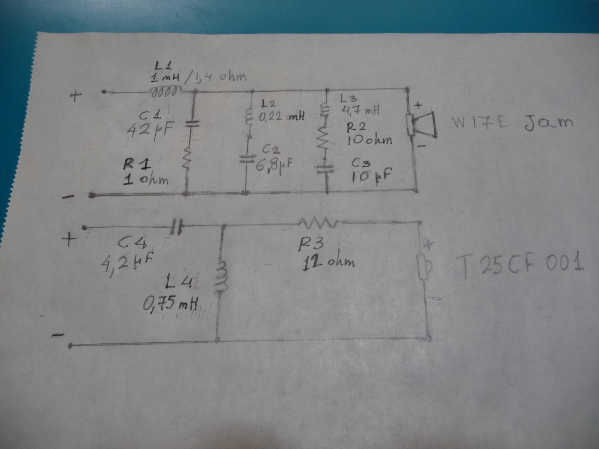

Concert 8/D 830 has very good bass but it is sounding imbalanced for explicit reasons.It's a well designed bass-reflex,with a poorly designed crossover.Personally,I like Steve's schematic but I have made some modifications( parts numbers as in Jamo's original schematic): L1=1.5/0.5, L2=0.25/1.3, L3=0.22/0.4
C1=14.7, C2=5.6, C3=10, C4=6.8
R1=1, R2/R3=3.3 and 10R+2.2μF zobel
L values in mH/ohm,C in μF, R in ohms
What do you think of?

I'm not sure that works better, but it's your project. I got a hole in the midrange there, and a 0.25mH with a resistance of 1.3 must be rare as hen's teeth. Really, "if it's not broken, don't fix it" is the engineer's motto! Fixing the notch was the main event. The idea is to get the rolloff as straight a line as possible. 😀

I have never used in the past Boxsim or any other simulator,so I did sims with Dissi's set up, from his post.The tweeter circuit you called "disastrous" (4mF cap in series, shunted by 0.74 mH and followed by a series 12 ohm resistor) works (curiously) fine.Sadly I don't know yet how to extract and post images of the simulations.L3 coil exists in Jamo's high pass (R=1.3ohm),of teethed hen I have never heard!

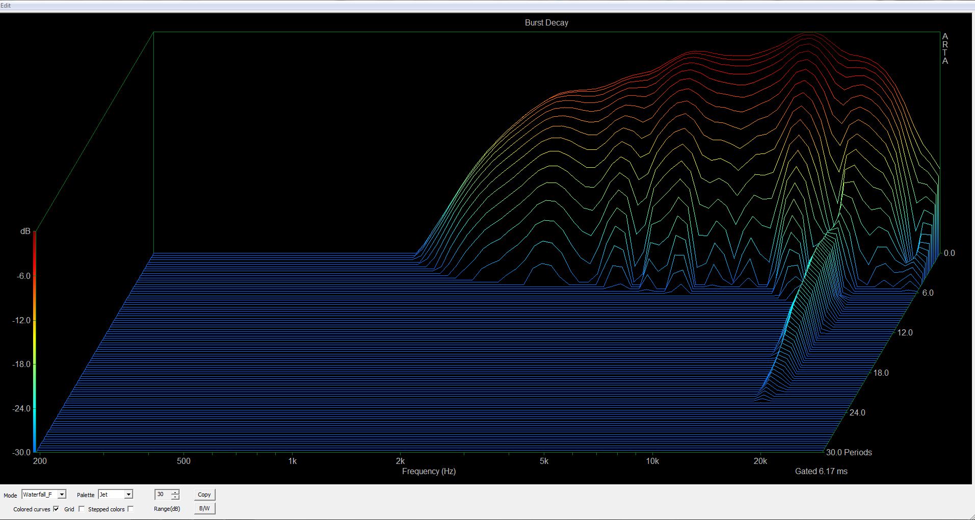

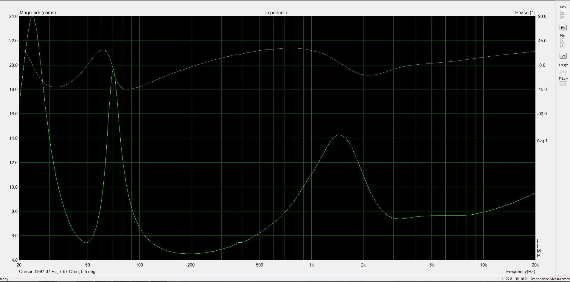

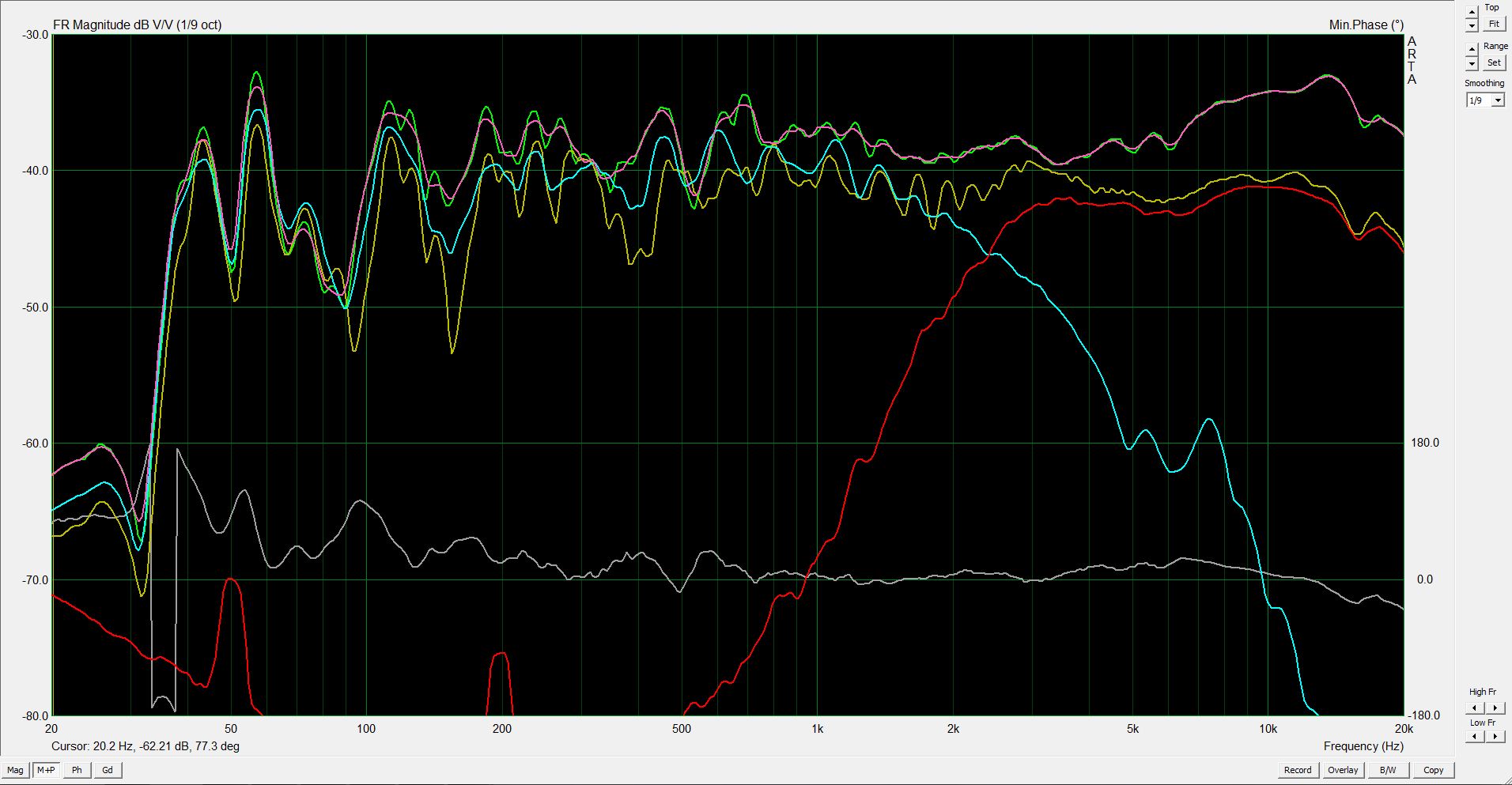

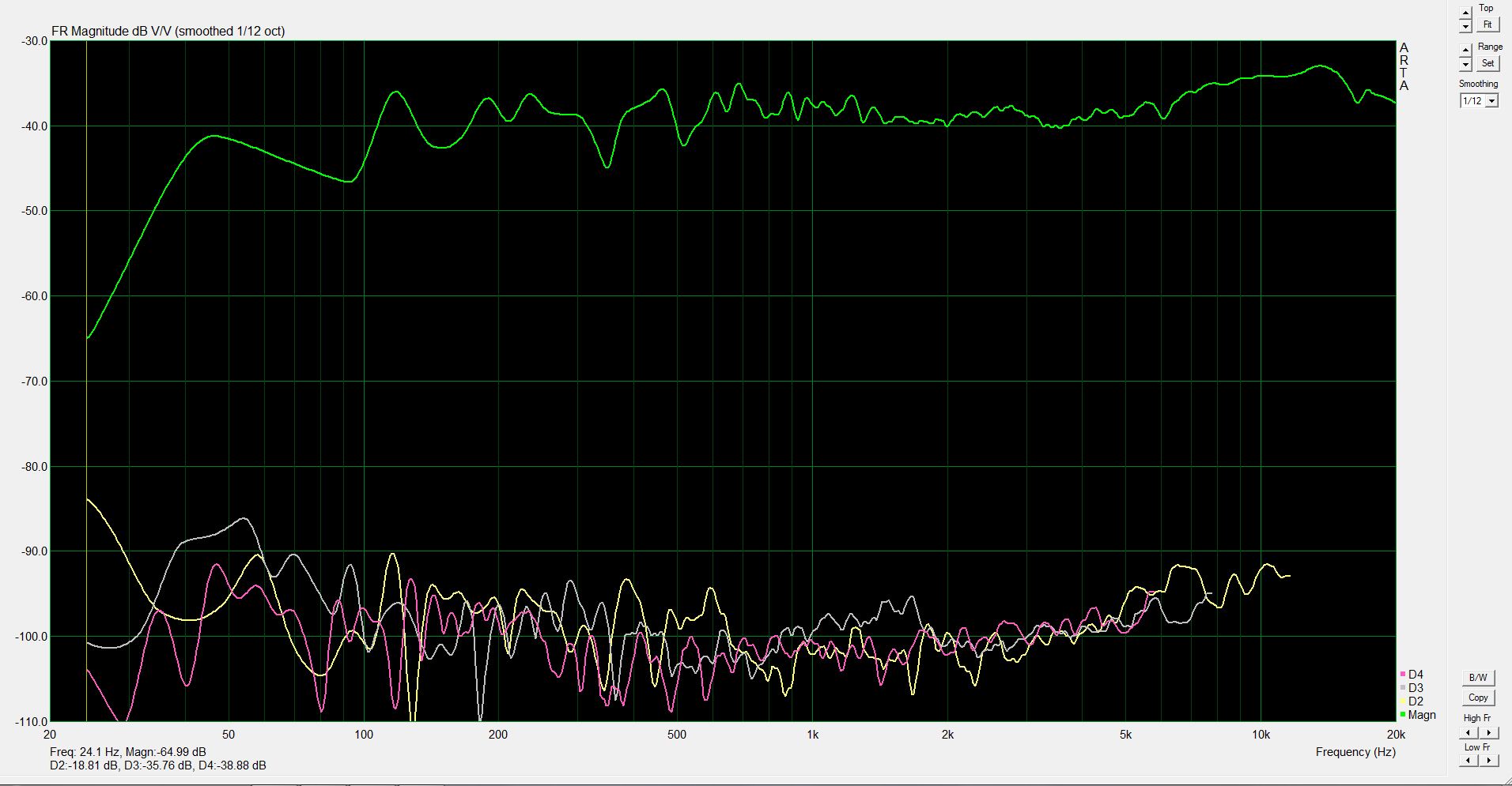

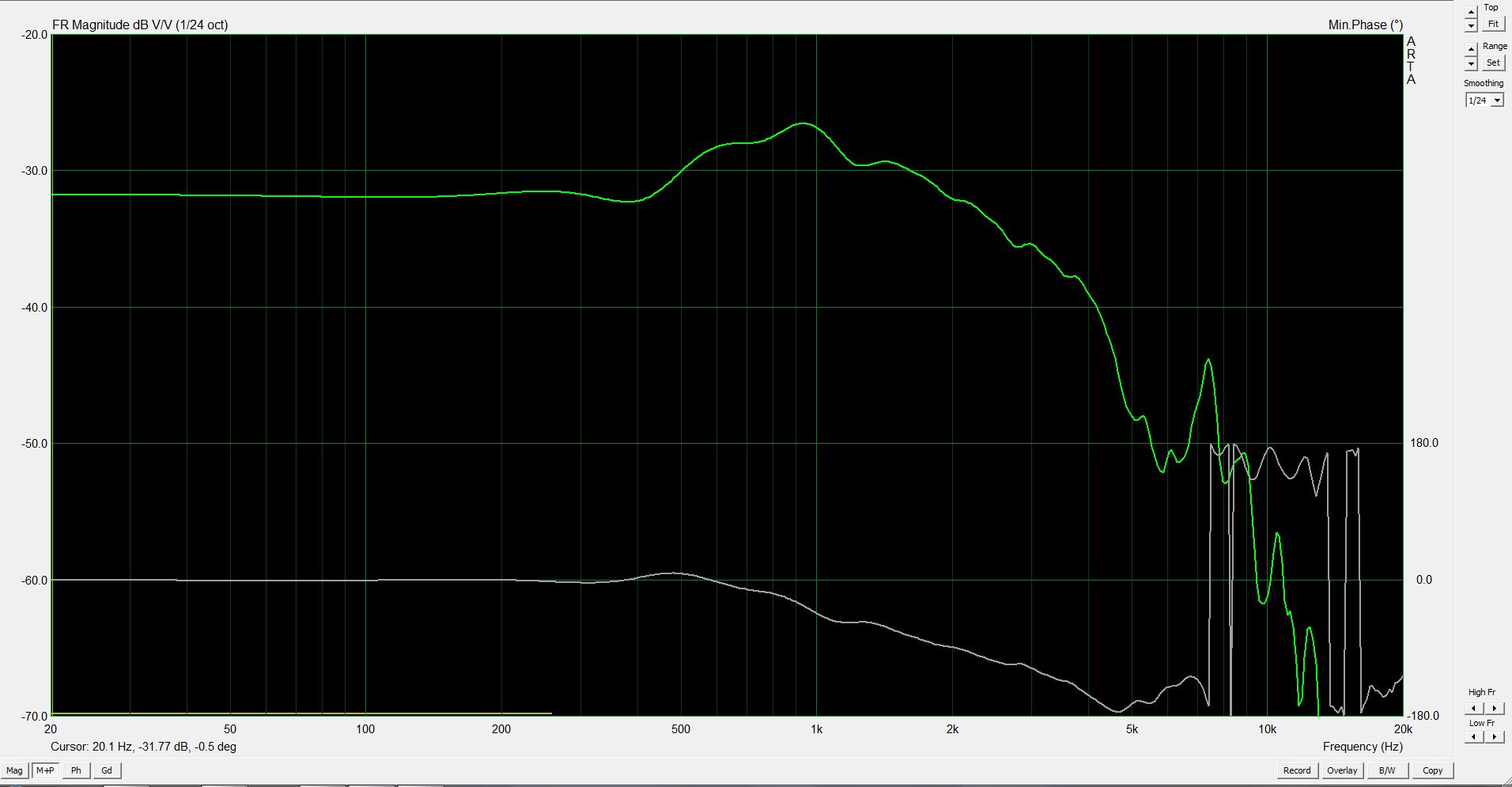

With original d830 I found bass roll-off problematic. There is a notch at 4.9kHz
in cross over, but at 7.4khz there is a peak extended in time.
At 7.4khz its only around -18dB.
Brake up on tweeter is also visible.
Some pictures of original speaker measurements in attachment.

Yes,the measurements you are providing are similar to the ones at posts #55 and #56 by Dave and Dissi respectively,and proove that the crossover needs redesign.I used Boxsim of Visaton,which looks very accurate for this purpose.
Woofer's resonances after 4kHz aren't difficult to be reduced.
