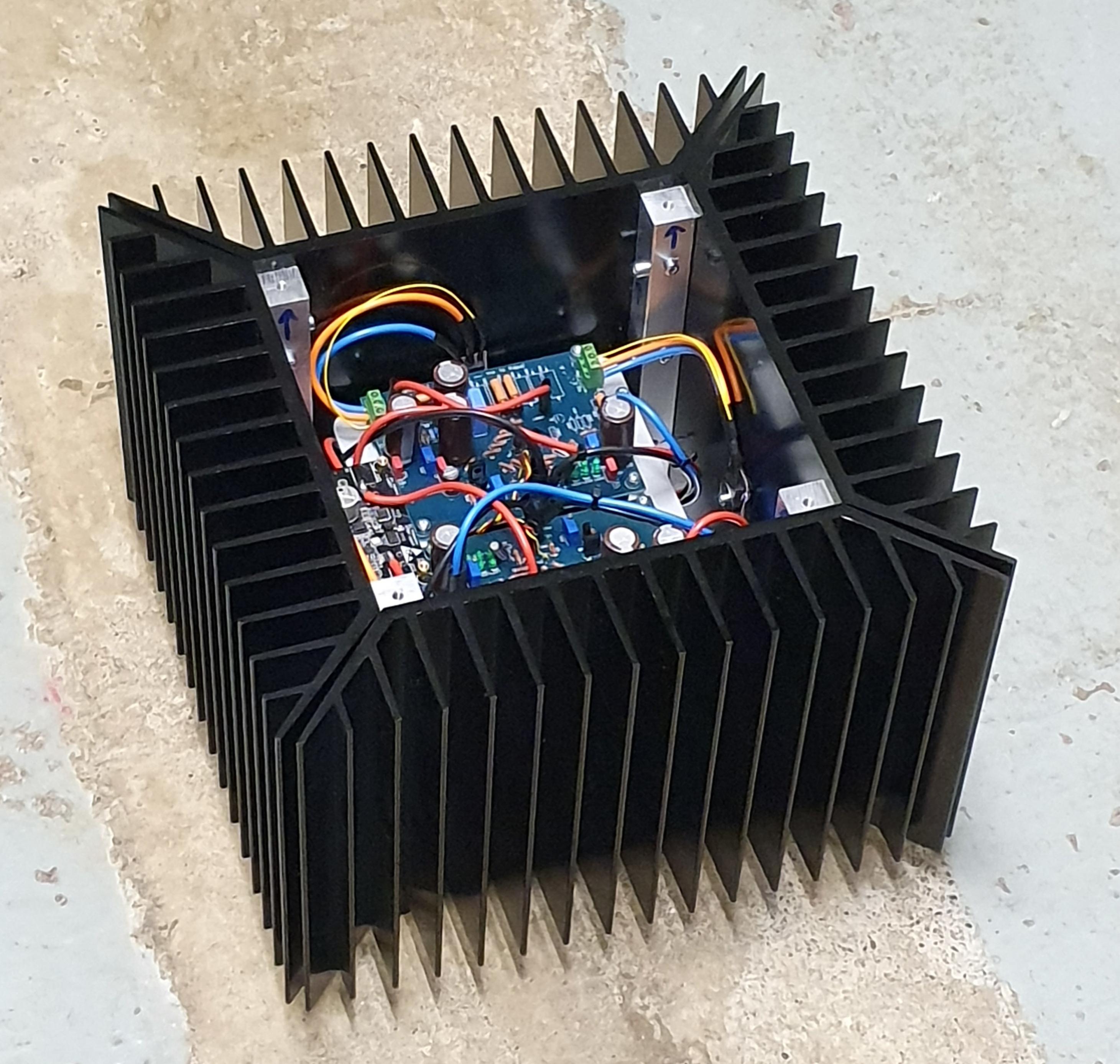

...looking at these layouts, I am not sure how you're going to spread the output devices across the four "Aleph style" heatsinks. A stereo amp will have 12 output devices (6 per channel). You could spread the outputs by mounting three outputs to each heatsink, but the thermal coupling might be different from what you're used to with "normal" amp chassis. Is that an issue?
Also, your layouts for the boards that take the output devices seem to be rather long -- will they fit the "Aleph style" heatsinks?
I attached a photo of my Aleph J stereo amp (with 1 output per heatsink). Thermal tracking was better during bench testing, when both the "positive" and the "negative" outputs were mounted on the same dummy heatsink. Anyhow, my final build in the "Aleph style" chassis worked out okay in the end.

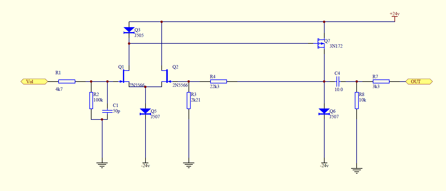

If this schematic can be trusted, the line stage of the Threshold FET-2 preamp used three of the Siliconix J-nnn current regulating diodes, two JFETs, and a MOSFET.

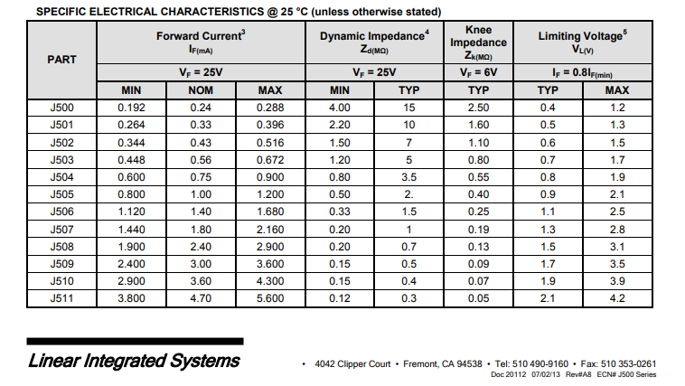

Linear Integrated Systems now sells identical-spec replacements for the old Siliconix parts
