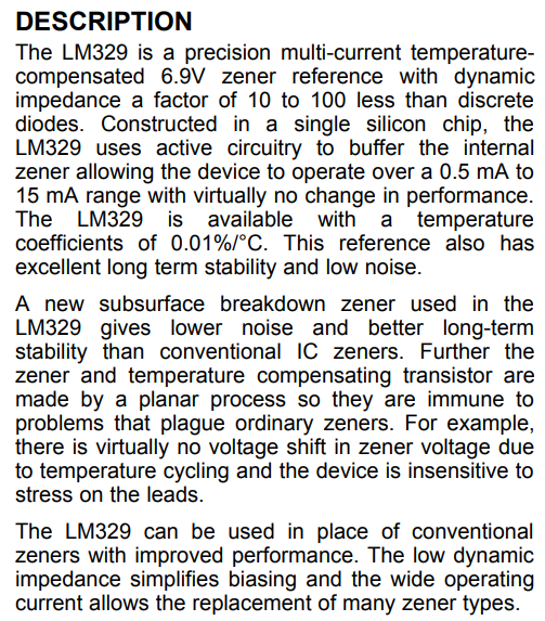

Plain ordinary 1Nxxxx "zener diodes" are often accused of being noisy.** That's why Walt Jung has been studiously avoiding them for 30 years, when he develops the "VREF" portion of a voltage regulator circuit design. At first, Walt employed the LM329 IC which contains a "buried zener" and is spec'd and measured to have low noise (see image below).
Now Walt is using an even lower noise VREF circuit which he has named "GLED431". Unlike the 6.9V LM329, Walt's new circuit has a VREF output voltage that's comfortably below 5V. This is desirable in these modern times, when you need to build a supremely good voltage regulator that provides 5.00V to low-voltage modern ICs.
Here is Walt's write up of the GLED431
https://www.diyaudio.com/forums/att...-reference-cell-_walts-blog-2014_092418_r-pdf
** diyAudio member gerhard disagrees, he presents some measured data (here)

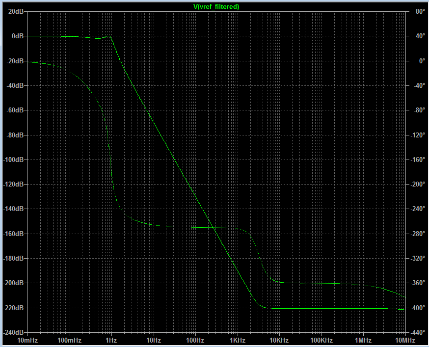

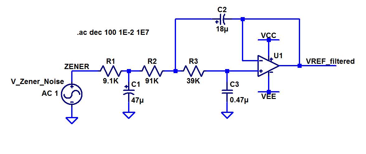

One way to get rid of reference noise is to filter it. This 3rd order Chebyshev filter with 1dB of passband ripple, seems to reduce noise by many factors of ten. (-220dB = 10 raised to the power minus eleven). I deliberately chose Chebyshev, to allow others to exhibit the superiority or inferiority of a Butterworth filter or a Cauer filter, in an application to eliminate reference noise.
_
