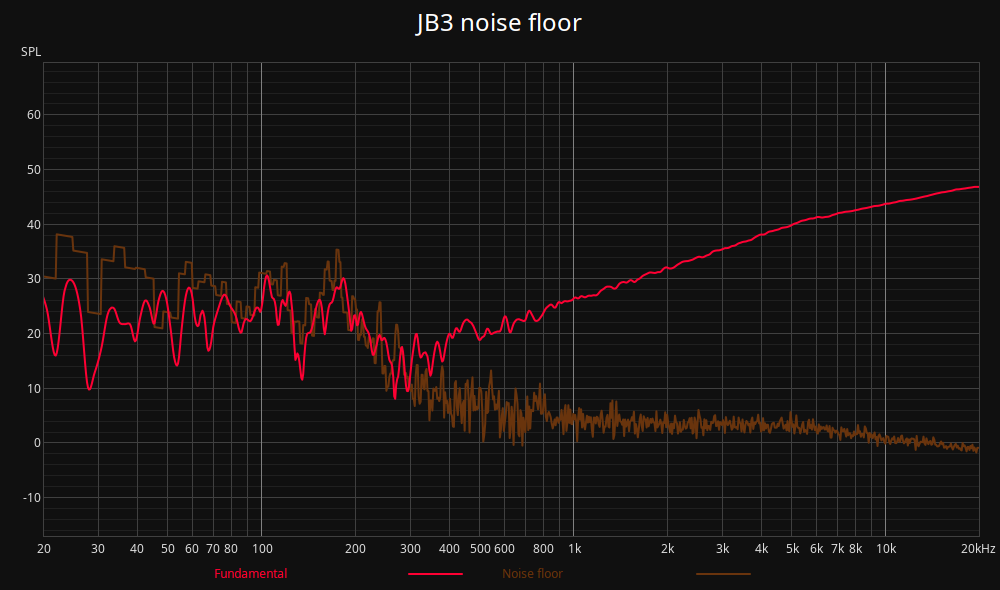

The J-Box has some big problems, according to the reviewer its not suitable for chassis evaluation due to high noise, which means you need more external devices like a separate AMP or Microphone.In being one package that would suit any speaker designer. Pixel peepers excluded of course
Joined 2003

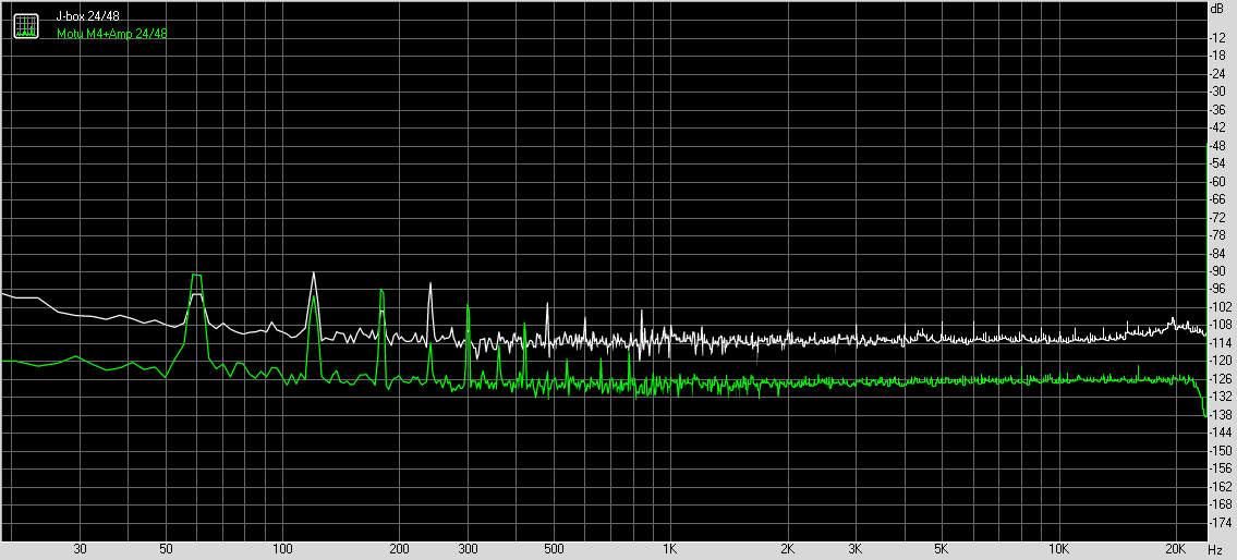

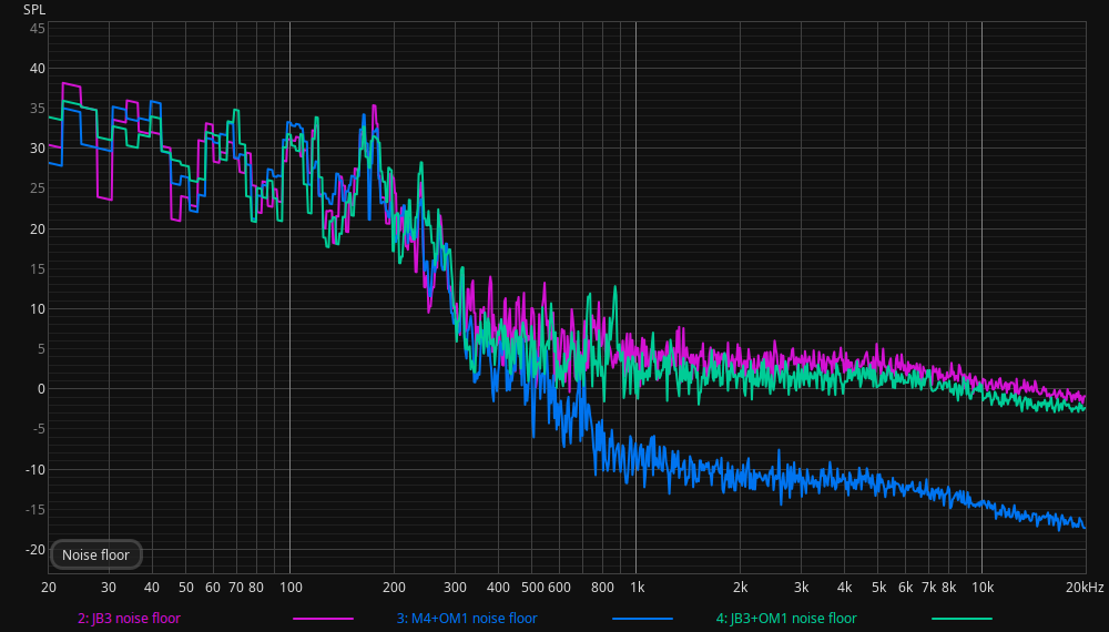

It's noise level is acceptable, similar to what you would expect from a budget USB audio interface. You may find measurements in my review of the noise floor (white trace)

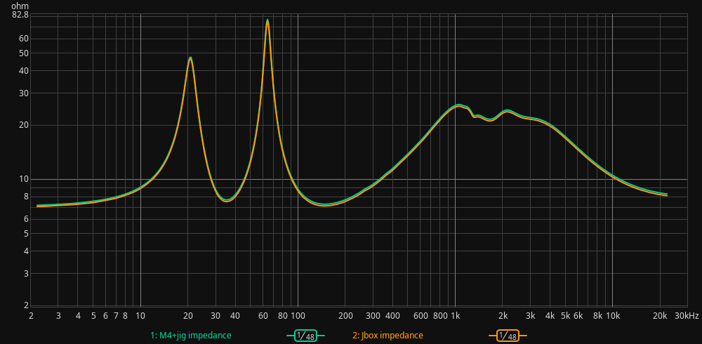

...and I produced clean impedance measurement with the device:
