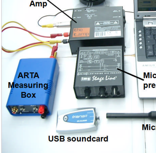

The J-Box has some big problems, according to the reviewer its not suitable for chassis evaluation due to high noise, which means you need more external devices like a separate AMP or Microphone.In being one package that would suit any speaker designer. Pixel peepers excluded of course
