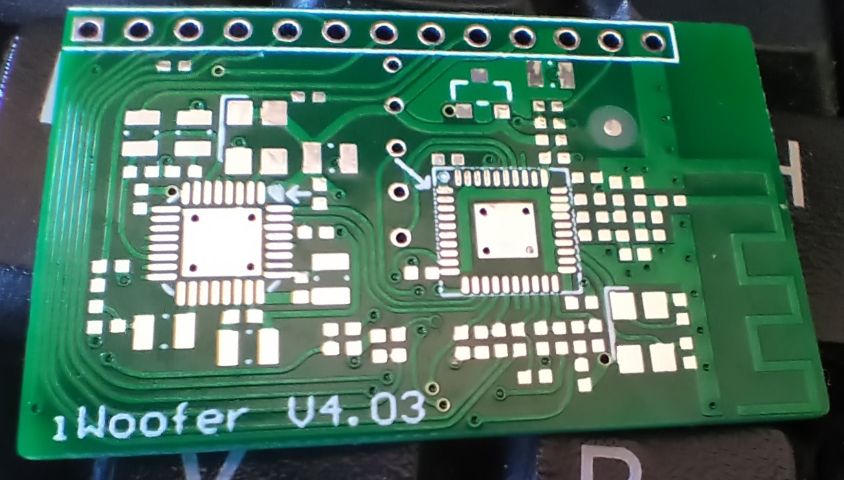

PCB and component received 🙂

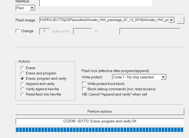

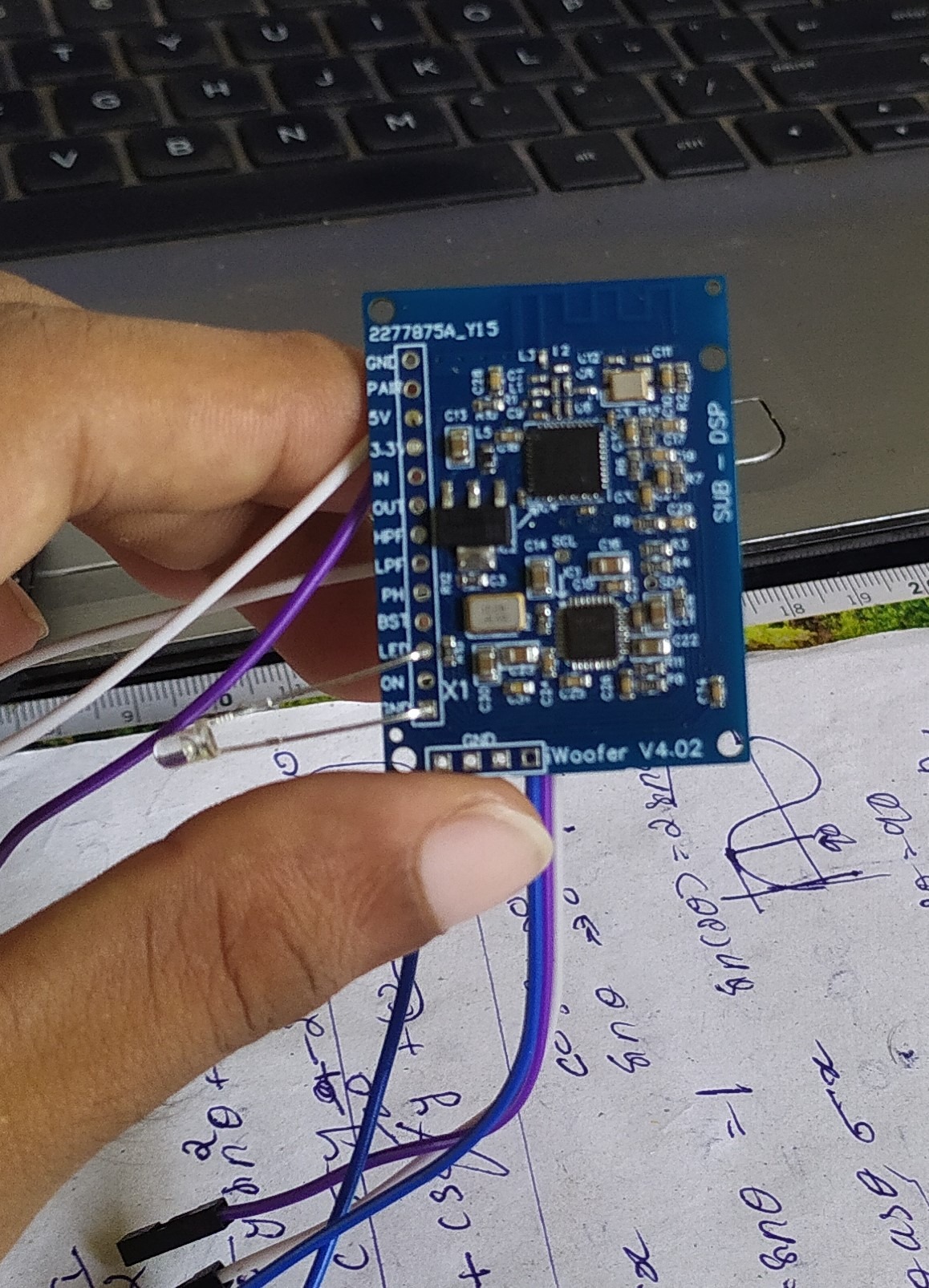

Hi all,
I tried to make iwoofer using 4.02v pcb
a) install Ti flash programmer software, choose the FW file.
b) plug to the USB SmartRF04EB hardware programmer, and tie it to the iWoofer PCB.
c) Press "Perform Action".
i was able to program the CC2540 using CCdebugger and Tiflash programmer and the firmware file from HW_package. but after that nothing happens. I cant see any bluetooth device on my mobile. led just blinks on poweron and then nothing.
what would be the problem.
i used a 2.7nH for L3 instead of 3nH. all other components are same as schematic.
Any help would be great !!
Thanks..
