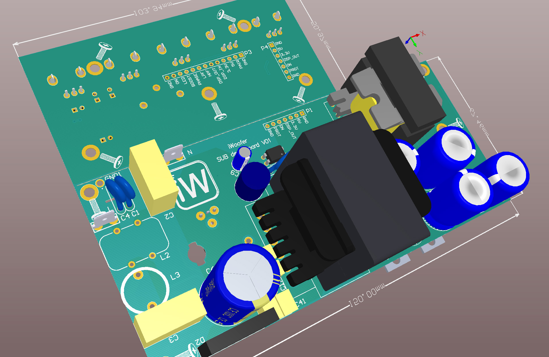

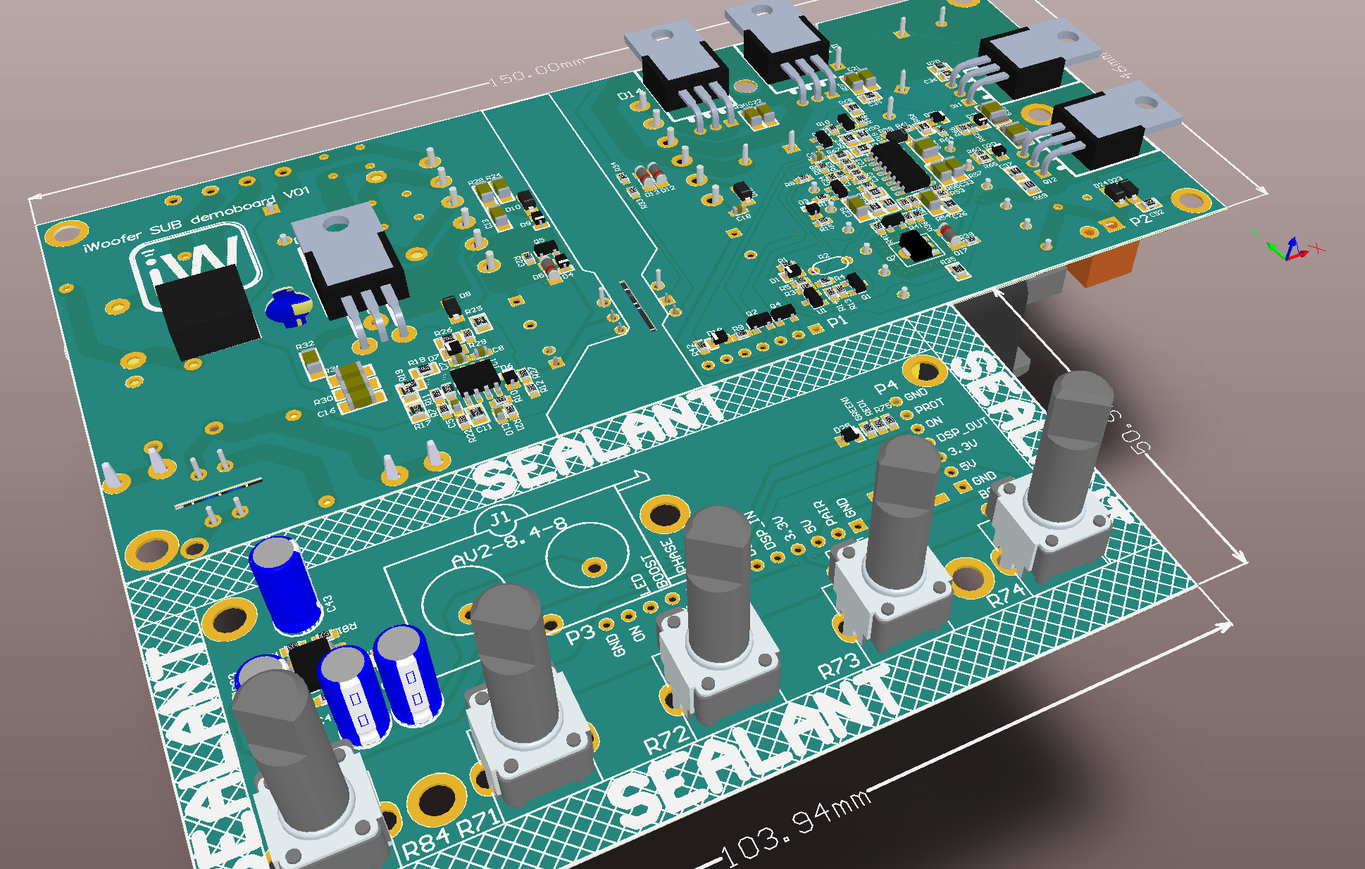

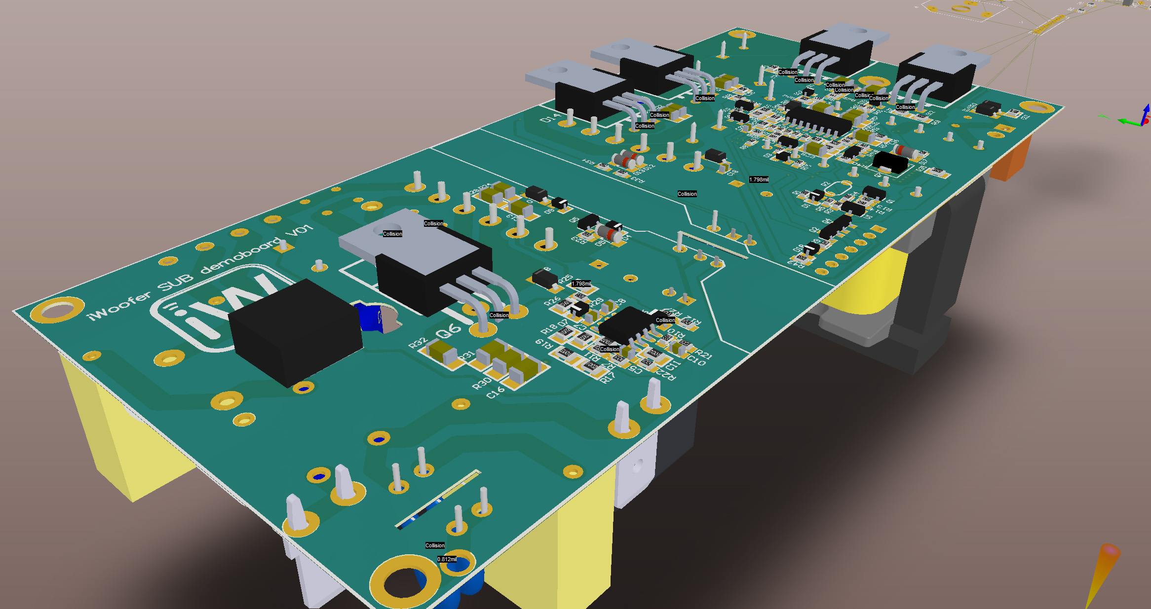

Hi there, seemed I registered here yesterday but suddenly it was 14 years ago! And, OMG, about 20 years ago I built my first class D powered Sub.. For sure, nothing is more expensive than a time, guys. So, back to the topic, about 8 months ago I got an idea to build the smartphone-based system to control an audio DSP in convenient/intuitive manner. A full range DSP, I believe, is a too picky area with too high demands for hardware (HW) so it's quite difficult to make something popular there, I mean hard to find a right performance/cost balance.
Another thing is subwoofer, S/N -102db is ok? THD .01%? 2.5mS of total latency? I guess, in 99.9% case it is good enough, hence HW (PCBAssembly B.O.M.) cost for such kind of system will be around $3-4, and the PCB size 43x33mm. This tiny PCBA doesn't just add to your sub a wireless control by your iphone, but it replace full preamp functionality including adjustable Auto On/Off, input level indication (on the iPhone and on the HW side as well), up to 4 analog like knobs/switches (LPF frequency, HPF frequency, Phase, Boost all of these HW controllers are fully adjustable by smartphone). In fact your need an only power supply and amp board to build your own smartphone controllable subwoofer. Full HW source package (PCB/SCH files, CC254) is uploaded to the public domain and free to use for everyone and iWoofer free app you can find on the iTunes.
Why are we giving that for free? Ok, there is a story. Formerly we worked for some Chinese OEM's and built for them similar control systems but those company's going only straight way and adding the price of the product because of "it's our technology" and so on blah-blah-blah. In the modern world, every dime of a product price at the factory becomes a $ in the shop because of the full chain (OEM->brand->distributors->shop) is too long and greedy. So this chain inherently resists for anything new just by the chain structure, and it slowing down a motion from an idea to end user. I decided to move our commercial interest out from this chain and offer free HW design and free application as well.
Our goal is simple - make iWoofer platform popular, and offer some interesting feature in paid version of an application. For instance iWoofer Pro app let you use minimum phase FIR with 2.5mS (+2.5mS of IIR&ADC/DAC so the total is about 5mS) latency and 2.9Hz resolution (for the next version we have the plan to add a switch 2.9/1.45Hz however it will affect the latency as well). So our interest is the part of users who would like try our paid app ($4.99). I'm happy to feel that I don't need hiding anything, and no any secrets in my idea. Obviously, our commercial target is an OEM factory's, which usually has no idea what an end user want, and why, that's actually most important. This is the reason of my post here, brothers, no one know better than you about what/why is better for advanced users, I appreciate and respect any of your opinions, positive or negative. I hope you'll guys will let me know what do you think about the idea in general and its implementation practically. That's very first post about iWoofer system in public. Thank you if read up to the end, or half ;)
PS: Our temporary website iWoofer is an open source hardware design, please download the iWoofer_HW package for details. - iwoofer
Schematic and PCBA pics are attached.
PS2: The Android version app is under construction and there is some issue expected about internal mic, using for room correction feature. Because a lot of manufacturers, lots of models. But at least free iWoofer app will be published soon.

No, it is very intereresting but I don't quite understand what are going to offer:
1) mobile app and wireless shield for controlling external DSP/DAC module
2) mobile app and DSP DAC module controllable wirelessly
3) plate amplifier with DSP platform controllable wirelessly
4) wireless subwoofer plate with diigital inputs, wireless control and wireless sound streaming as well as redirecting analogue high pass filtered signal to main monitors?
Which option describes your project best, honestly?

'2)' is closest. I tried to edit my previous short msg but seems the forum engine has a timeout for the editability and it's passed. Ok, will post here:
No streaming, only DSP control (Pro version has minimum phase FIR for flexible freq.response compensation aka room correction. BTW, there is the finest trick of that project, advanced DSP guys may ask - wtf, how it's possible for a tiny $2 adau1761?!!11). Current iWoofer HW version has no digital input, as 99% of inexpensive subwoofers on the market, however, if I'll see the requests for that, it will be there.
