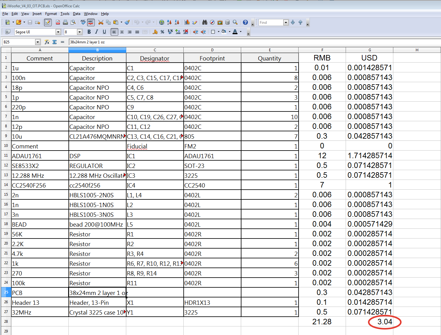

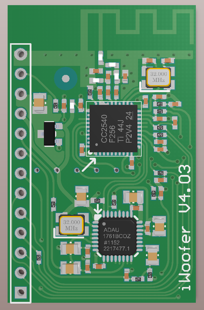

BTW, size reduced iWoofer 4.03 (0402 only) 38x24mm.
  • iWoofer_V4_03_OT (3-27-2020 3-51-37 PM).zip

Is there a BOM to build this thing or not?

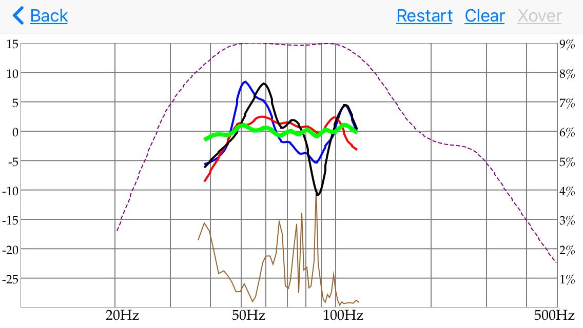

I did a more detailed setup by measuring each subwoofer in the room (by putting iPhone near each one, iWoofer app permits this) and after going to the listening spot on the couch I let iWoofer do the final tests and calculation of FIR coeficients, loading them to the device and voila: the green line is the final respons after correction.
Thank you for the tip, IVX.
I was thinking that red subwoofer has enough "steam" in that region but I will follow your suggestion. I want to ask you some points, could you please clarify these to me?
1. In fact I measured 4 different subwoofers but seems like there are only 3 curves remained, not considering the green one which is final. Is iWoofer doing this to have the graphic uncluttered? Or it is not considering at all the 4th subwoofer?
2. The videos I found explaining setting procedure consider only one subwoofer and doing maybe more measurements of the same subwoofer (also more measurements on the listening spot). My question is if my take on this --measuring more subwoofers-- is correct, meaning the iWoofer app is not puzzled by that?
Thank you very much in advance.
Dorin
This is a interesting project, soldering is not a problem. But can someone explain me what it involve in term of programming ? There's only the blutooth chip firmware to load ? How hard/easy it is to do ? Or it cannot be done simply and it need to be buy ?
