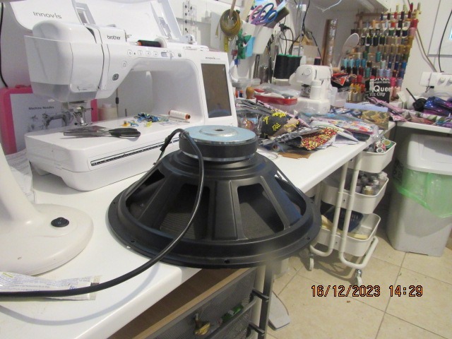

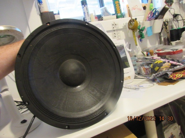

What are the 15" 'midranges' you have in the shed?
I'd love to see a picture of them. Do you know anything about their specs?
If they're rugged enough, you could add a bit of mass to them to aid bass.

Organ driver I was gifted a few years ago, and I've already added extra mass with multiple coats of PVA.
I'll pull it out as I need to see if it fits the holes and possibly the screw spacing

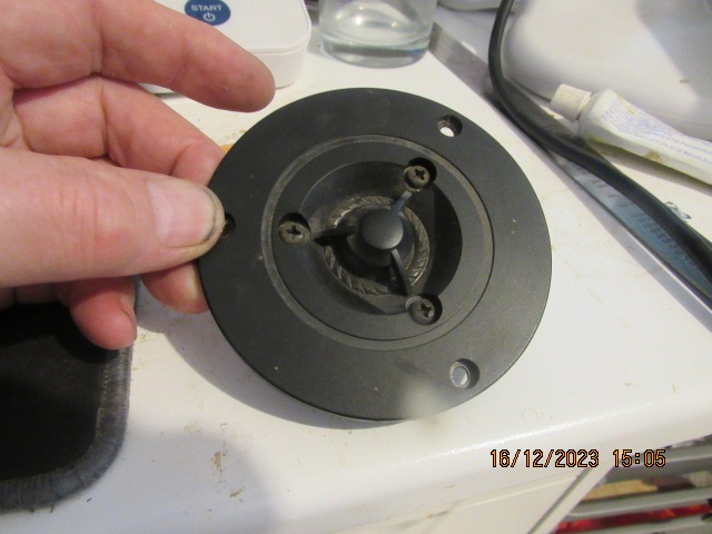

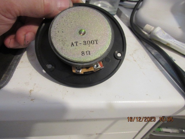

Well the organ driver doesn't fit but this one does and the holes also line up
A garage sale find last year for $20-
A bit tinny but that's possible because there's bugger all bass

I put it on the DATS and I am getting some strange and craxzy readings Computer glitch
Restart the computer Start test again
Re 7.132 which matches my multimetre
Fs 35Hz
Qts 0.98
As it's midrange I don't think the high Qts is a problem in a leaky box and therefore Vas isn't needed
Still need some upper octaves tho
Fs 35Hz
Qts 0.98
