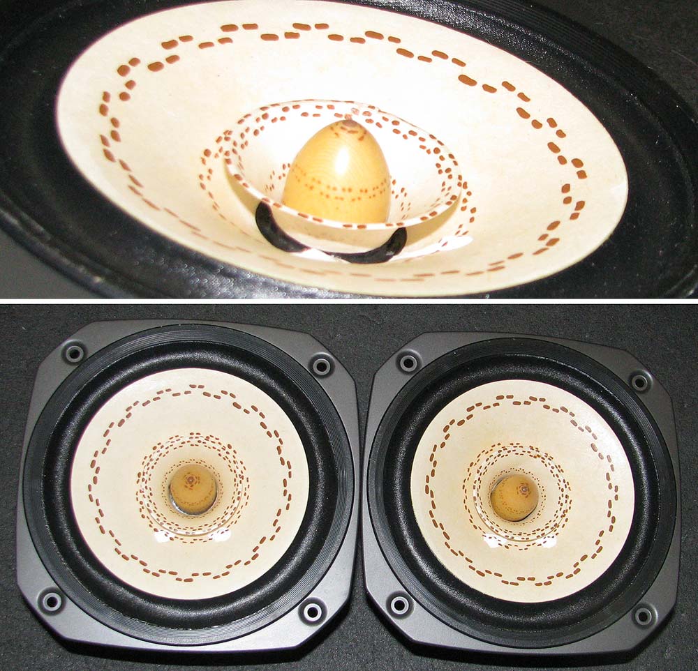

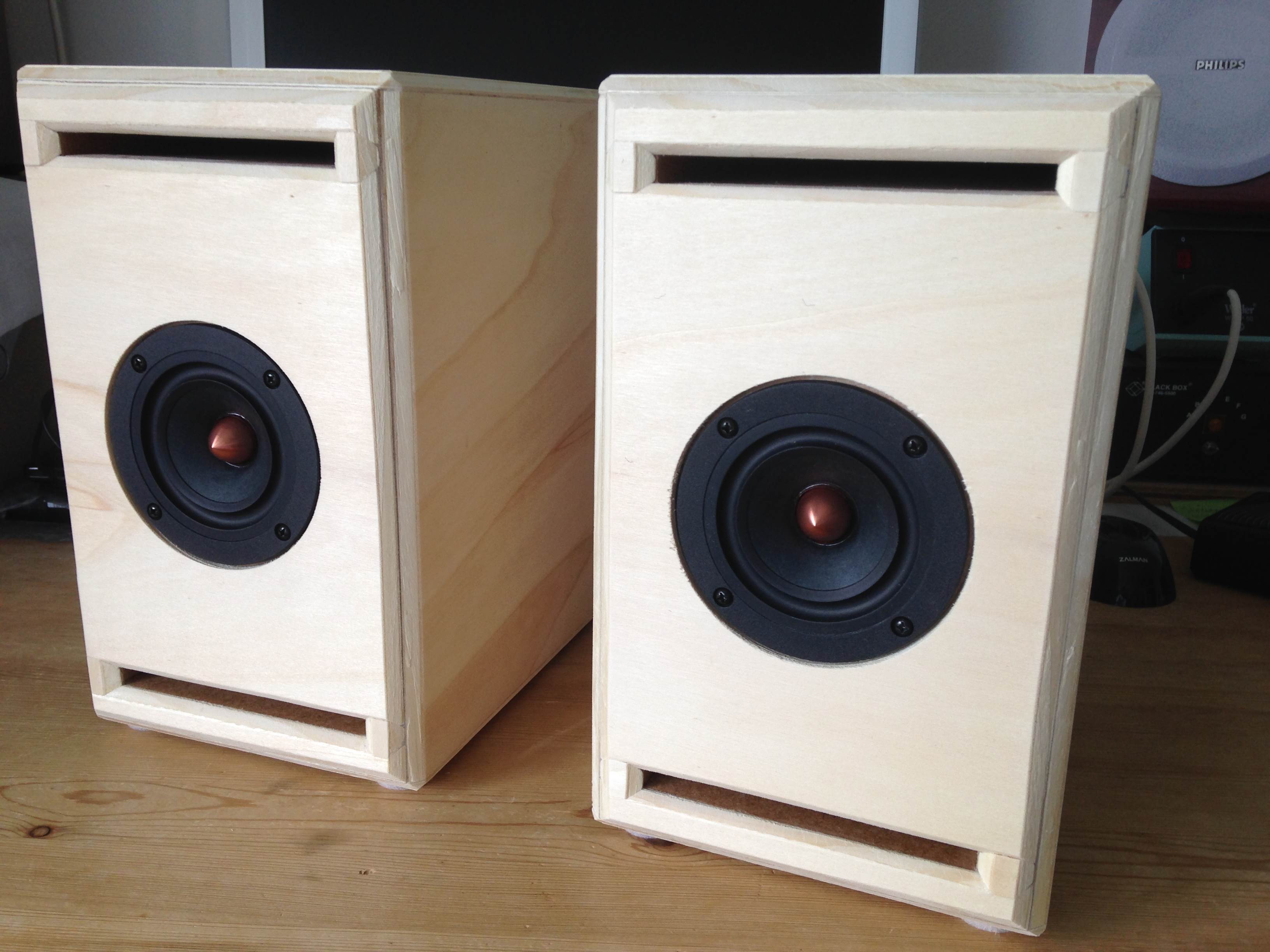

Those lemon yellows are currently in my house waiting for boxes, can't wait to hear them. The color was partly out of concern for WAF, since my significant other chose a nice yellow couch for our flat. Naturally, her response to those drivers was very favorable 😀 Good job Dave!
Not thinking while i was talking. I am working on another pair for him, another colour — he is going to run 2 in parallel with a small SET.

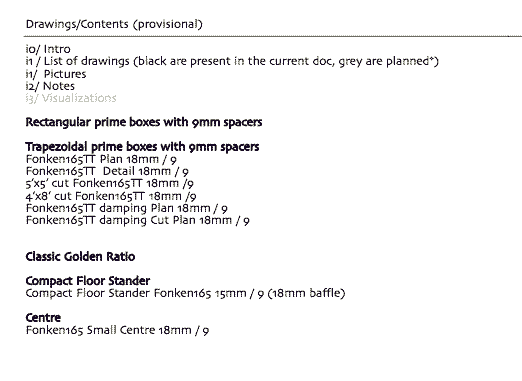

One more question, what enclosures are available as paid plan-set for FF165WK?
The FF165wk goes up far enuff for most people. AFAIK none of the ones i’ve done are being used with a tweeter.
For near field i’d personally pick something a bit smaller.
FF165wk plans (that are drawn) are a bit basic as yet, but almost any Alpair 10p plan can be adapted so more can be done quickly. I always look at a bew one as an opportunity to flesh out the planset. There is always more to do.
I am working on a double high, double driver version of the Fonken165TT for the fellow with the quad of FF165 and will also drawn up the Twin Frugel-Horn XL (Frugel-Horn XXL?).
There will be a skinnier CFS, and 2 sizes of Classic Golden Ratio. A smaller trapezoid, and wider ones. And rectangular versions. At least.

That floorstander os called the Compact Floorstander. Stretching the standmount till it mets the ground gives a compact footprint. Wide one is drawn, skinny one is easier to do.

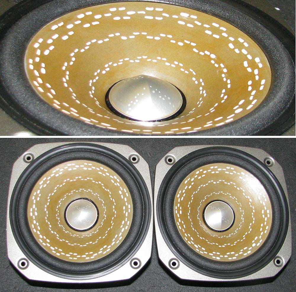

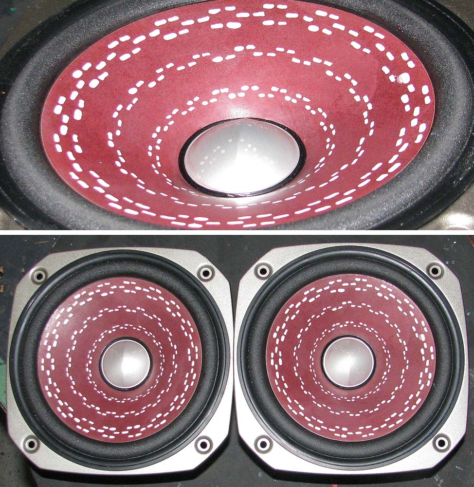

Fostex FF165wKeN, burgandy with white (colour added was bright red). Will be used with the FF165wKeN in post 243 to make a Twin Fonken165TT.
Two of four FF165wK’s getting exercise in their temporary homes, waiting to become TwinFonkens. Previously seen in Posts 243 & 250.

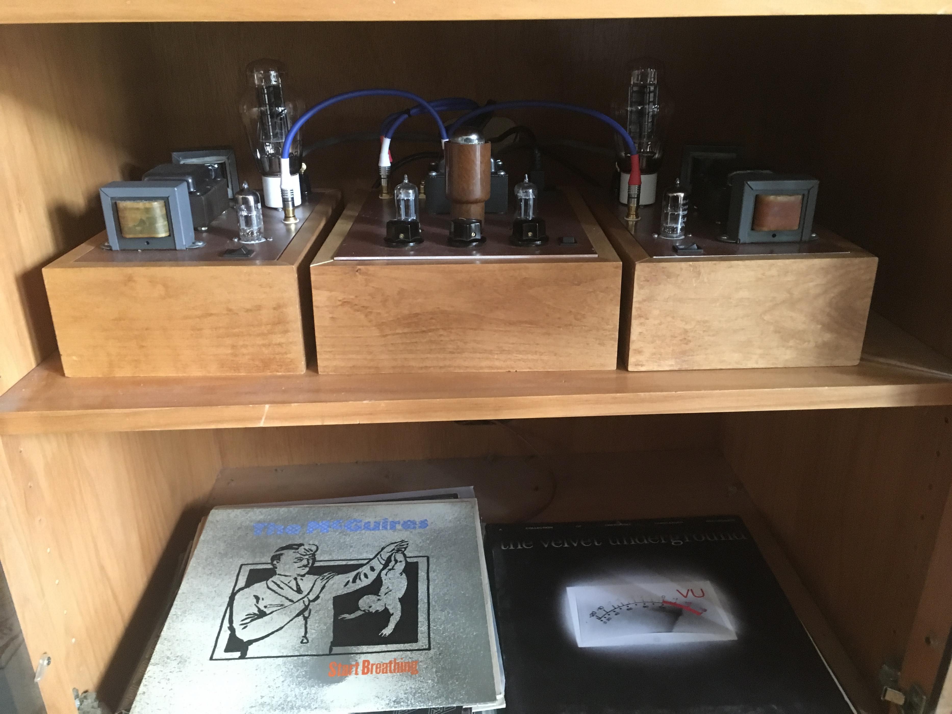

Also, the amps that will drive the speakers. I sometimes call the two mono blocks Lefty and Red,
Tweaked Bottlehead Paramours and Foreplay, would those be?
Absoulutely!
3.5 watts of joy per channel

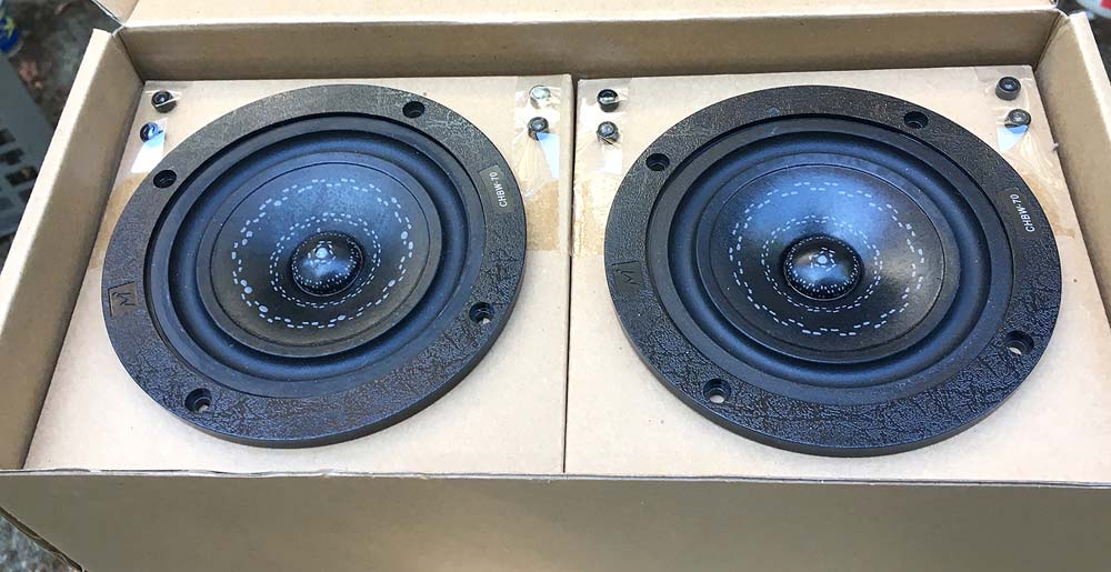

During the stay at home I retrieved one speaker I never used. It is as Alpair CHP-70 very inexpensive. I've been reading the stiffening and cone treatment threads as much as I can catch up on. What is the wisdom for this small 4" driver?

Which CHP. Gen 1 or Gen2?
These get a thin coat of ModPodge and then EnABL. If you email i can dig out my templates and send you the sizes.
These are CHBW but have the same ringset as the CHP70.2.
