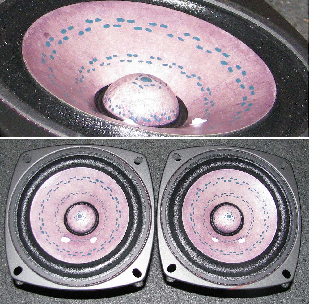

I’m a bit behind at posted pictures of fresh schemes, so a blast of posts to follow.
Alpair 10Pen darkish Bluw with grey spots (inspired by Seattle Seahawk colours:
They all sound better than stock too… well i can’t really say with the AN, i didn’t listen to them before treatment.
dave
