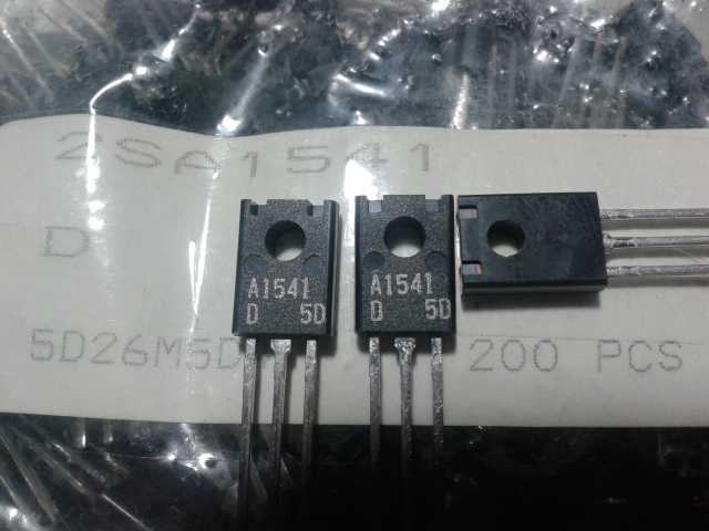

It's 2016. I accidentally got a bag of 2SA1541 "D" grade from an old small surplus shop in Thailand. After searched on this forum, seems 2SA1541 is rarely mentioned nor having its photo here.
Any advice if they are genuine? How can we make (simple) tests on them? Thanks in advance.

Nice find! These look like Sanyo video drivers - and great low Cob value. Good high voltage rating and decent current. Will probably work well and similar to KSA1381/KSC3503.

Thanks. Quick look on the datasheet, their Ft is impressive. This one kisses 150MHz at 5ma ( A1381 required 10ma). The down side is Hfe i.e. only ~60-70 but consistent among them.
I got them a while ago. I think it was US$40 for 200 pcs taking risks they might be fake. I might create a simple amp to see if they are genuine.
The low hFE would not be as great a problem when they are used to cascode another low power high hFE fast fT transistor.
They could also be used as the second transistor in the dual transistor VAS as shown in Blameless by D.Self.
aAnd as the pre-driver in a triple EF output stage.
