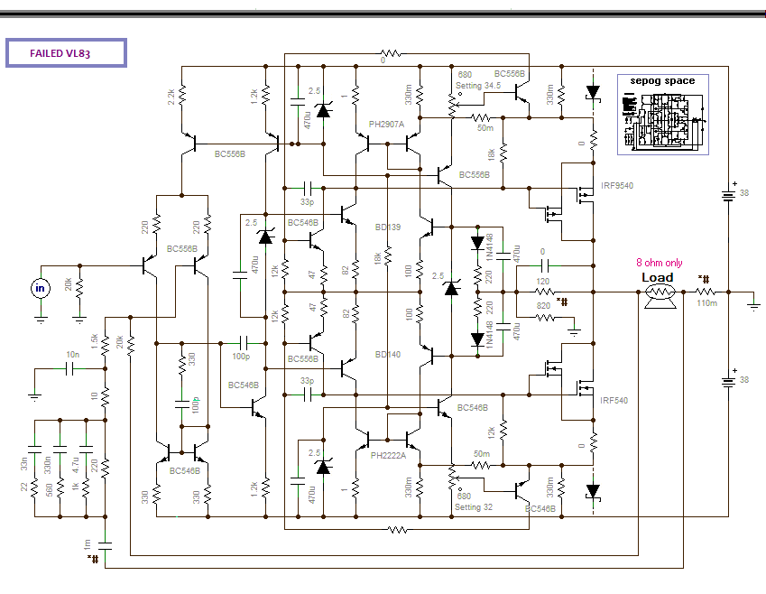

Actually my amplifier is working as normal, but then I found a problem with it, not really has affecting its sound, but it is unsolved.
If you really could read my schematic, you'll find out what that problem.
Nothing special in this schematic, but at least it is reasonable and not controversing or whatever (my spell checking says no controversing word).

In this case workhorse floating drivers is OK, but better if sense resistors not sensing Igs and the driver may have less compensator.
Look at LazyCat's shematic.
It has superfast expensive instrumentation-grade opamp and many power transistors to just converting voltage into current, to be used in low feedback current feedback amplifier.
In this low feedback, tl061 has major effect in overall amplifier, and what is that IGBT, and also those quality opamps used for?
