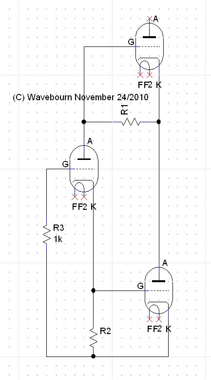

and in my class A+C amp the entire class C output stage senses this difference and corrects it increasing emitter current as soon as the difference increases. 😉
Once again: resistor from VAS supplies load by current. Inputs of class C followers are connected to the left side of this resistor (to VAS output), outputs of that class C followers are connected to right side of the resistor (to the load). Voltage drop on the resistor is proportional to output current, so as soon as it's sufficient to be sensed by output class C followers, they start providing output current bootstrapping VAS output through still the same resistor. It happens on loudness far from zero volt threshold, so it is much less audible than in case of class AB transistor amp that spoils "first watt" introducing distortions during precious zero-crossing phase.
Here is another example of such bootstrap, but for different topology:
