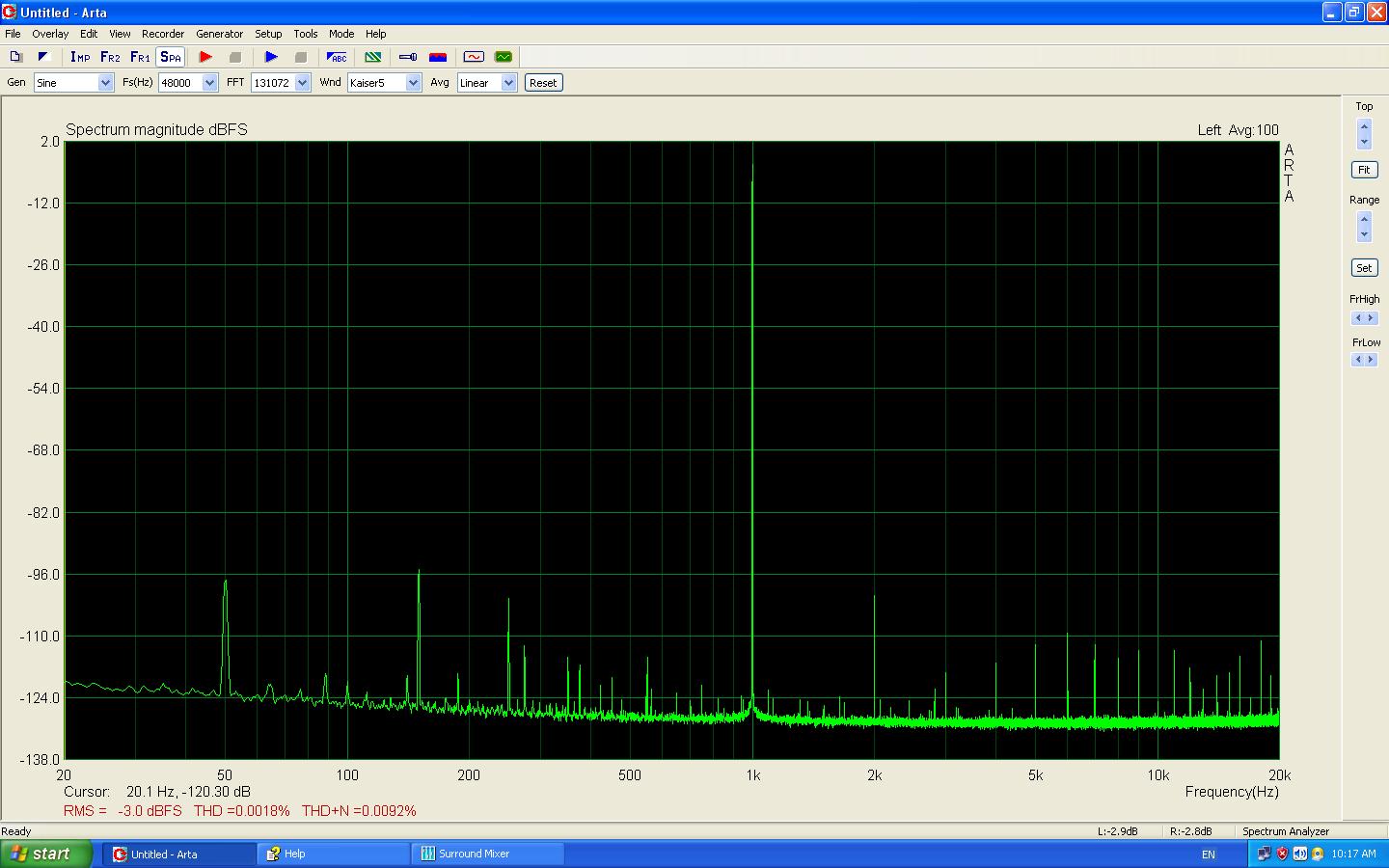

I have read ARTA "help"carefully and then loop test repeated.
Here are results.This seems to be more closer to truth.

My sound card is a Creative Soundblaster.
Is this ok?
The setting should be correct,then gets the reliable data.The signal window should be Kaisier 5(7 is for 24bit resolution),RMS level is close to -3dBFS.

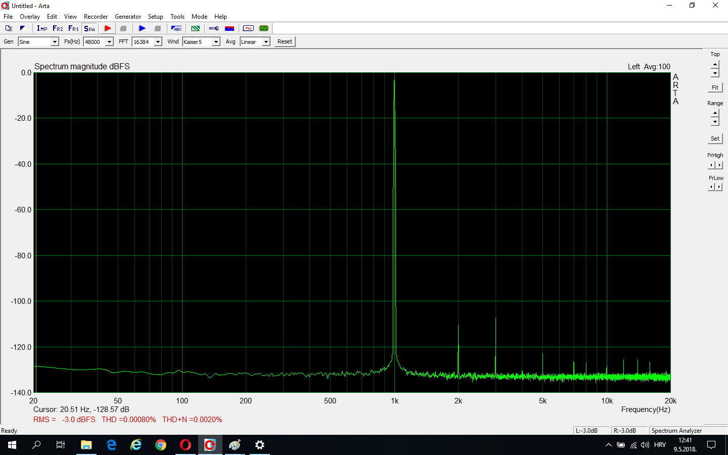

I recently managed to pick up E-mu 0404 USB 2.0 for audio measurement purpose only so I have a question about loop-back measurement setup:
- for best results should I use a pair of balanced TRS-TRS connectors/cables or unbalanced TS-TS connectors/cables (+6dB difference noted for balanced version)?
Have in mind that the technical specifications for the EMU-0404 is there: http://www.creative.com/emu/products/product.aspx?pid=15185
Have in your mind that the input of TRS is 1Mega and the balanced input about 1.5K
The trs input has the same THD+N with balanced and a little better DR by 0.5dB
The balanced input isn't good choice due to lower input impedance but the trs input is perfect.
The analogue resistance output is the same for both output SE/Balanced and is 560 ohm - of course there is a different level of output btw them.
If you make a loopback measurement it is better to done with trs input due to 560:1.000.000 ratio.
The gnd lift that there is under of device is major help about gnd issues, don't forget at your measurements!

Thanks lemon for the valuable info, much appreciated! So, I should use connection/cables like this?
One would expect to see a double output impedance for balance output vs SE...any explanation on that?
The analogue resistance output is the same for both output SE/Balanced and is 560 ohm...
Yes, for the loopback measurement is OK.
Set the input pot to minimum and slowly rise the output volume.
Before this, make a calibration procedure, it depends by the FFT software that you use.
I haven't any explanation about this, in the creative link including.

Hi David and lemon
Thanks for the input...

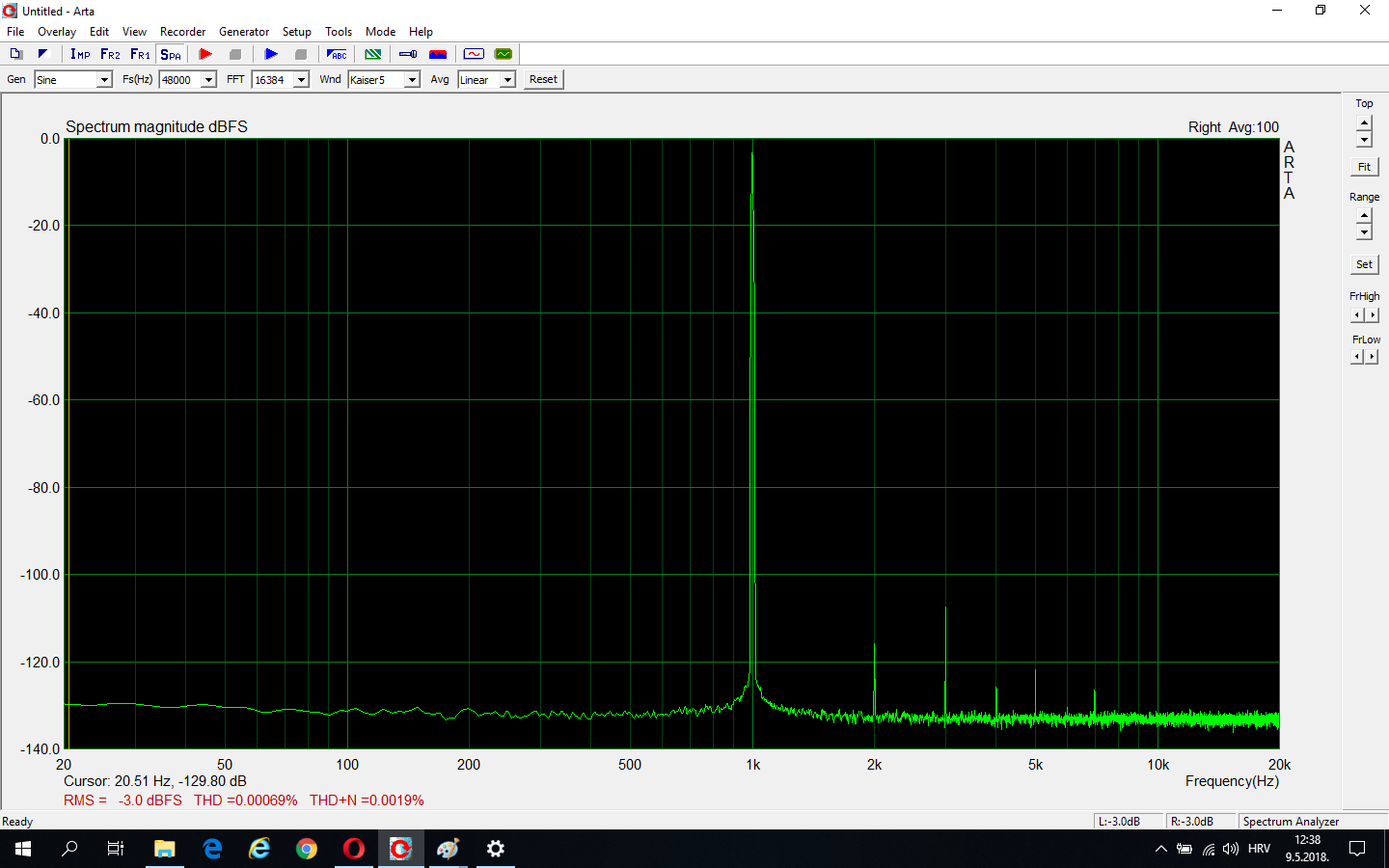

Here is my HW/SW setup:
- 10+ years old HP8630s laptop, Intel Core2 Duo CPU P8400 @ 2.26GHz, RAM 4G, 64-bit operating system Win10
- E-mu 0404 USB with latest beta ASIO driver
- ARTA 1.9.1 version
- 24-bit, 192kHz used during measurement
- TRS balanced cables in-out
- calibration in the ARTA software done with 1Vrms output (main output pot at almost 3 o'clock, Hi-Z/Line input pots at little over 9 o'clock (better THD and THD+N numbers then if the output voltage is set at 0.5Vrms)
Whether my measurements make any sense to you all?
