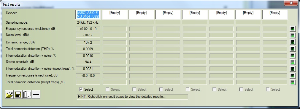

Did you get an Focusrite scarlett 2i2? They do look nice but don't quite match the THD/SNR/Noise specs of the EMU 0404, at least on paper. Have you compared any measurements??May or may not be related. I tossed my e-mu and my M-Audio units as they both had so many software issues I could not stand them. I have a Focusrite now and it has been just fine.
Yeah about £350! Do you have any loopback measurements? Is it better than the 0404 (when it working properly)??We had so many problems trying to get our EMU 0404 USB running properly with windows 7 as part of our audio measurement equipment, that we bought a Focusrite Forte. This works superbly with Windows 7 and works a treat with ARTA. We use a 96kHz sample rate for our PA/VA amplifier and speaker measurements. The Forte costs a lot though!

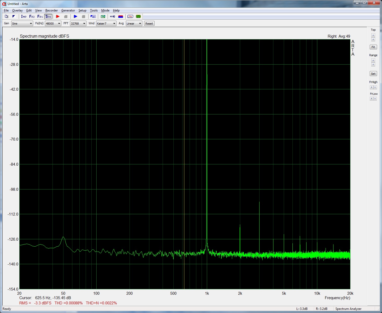

Use Spectrum analyzer mode (in ARTA) and on the left, set the source to internal Sine. I don't have ARTA available in front of me, but go to your audio settings and set it to 1Khz. It should default to 1K, but check anyway. Navigating around will give you some familiarity as well.
Here you go 🙂

Could you post an RMAA results file from the Forte on loopback?It has the great advantage when using it for R&D measurements where the tests have to be replicated exactly is that you don't have those annoying rotary gain controls that on the EMU don't ever seem to be possible to set where you want them! The Forte control application allows you to set input and output gains in 1dB steps at lower gains, and 0.4dB steps at higher gains. The actual gain settings are displayed on the colour display on the unit and also replicated on the s/w control panel. You have to remember to mute the internal direct path from input to output when performing measurements, and set the gains to and from the PC in the 'DAW' settings. I had to RTFM a couple of times, but once you're used to the audio routeing it's no problem. It can run full-duplex at 192kHz and the noise at LF is lower than the EMU, the HF noise appears similar.
