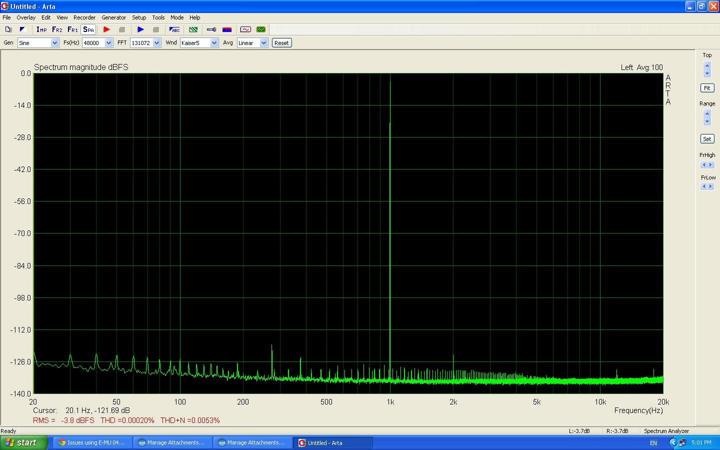

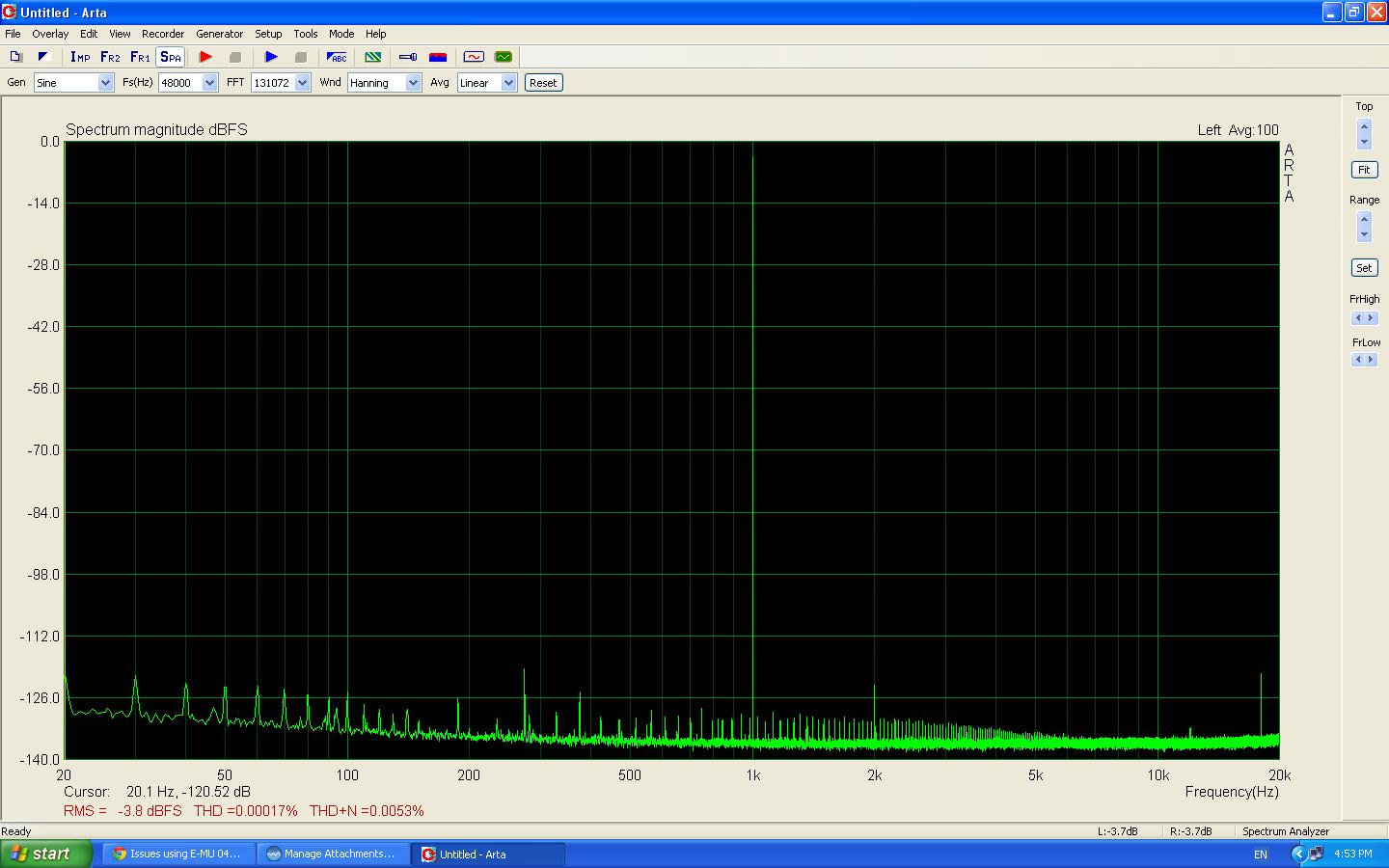

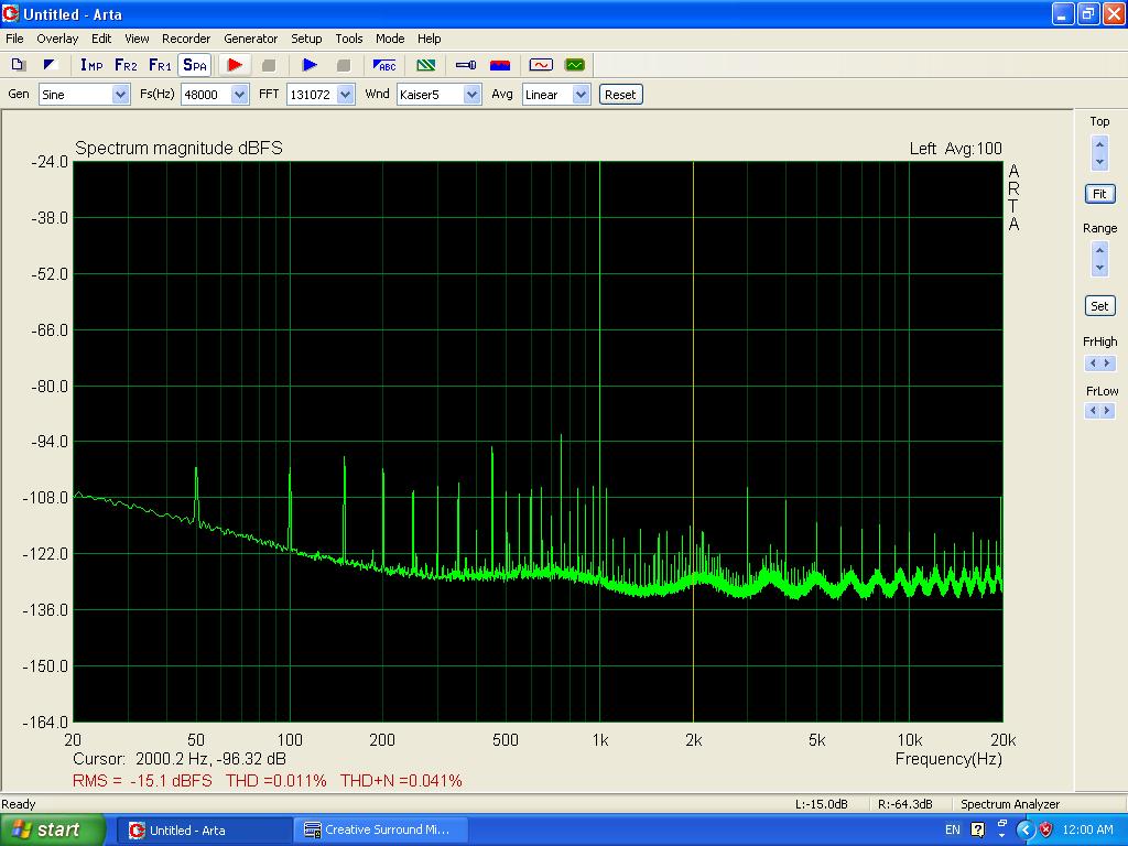

It's not as good as you would get with other cards but it looks fine. You will get more accurate results if you set the FFT higher and an 'Avg' option like linear, then leave it for a few minutes.My sound card is a Creative Soundblaster.
Is this ok?
That is.It's not as good as you would get with other cards but it looks fine. You will get more accurate results if you set the FFT higher and an 'Avg' option like linear, then leave it for a few minutes.

Yes, it is true and us-full this approaching.
That is.
Yes Thimio. It is better now.
Please, read the manual of ARTA about how this manages the various menus.
For example, for the THD measuring, suggests Kaiser5 or Kaiser7 with Exp Averaging (input singal -3dB).
For periodic measurements, like jitter, Floor Noise e.t.c Hanning is more acceptable.
I think you will have better measurement with 24/48 sampling.
Thanks my friend ,please take a lookYes, it is true and us-full this approaching.

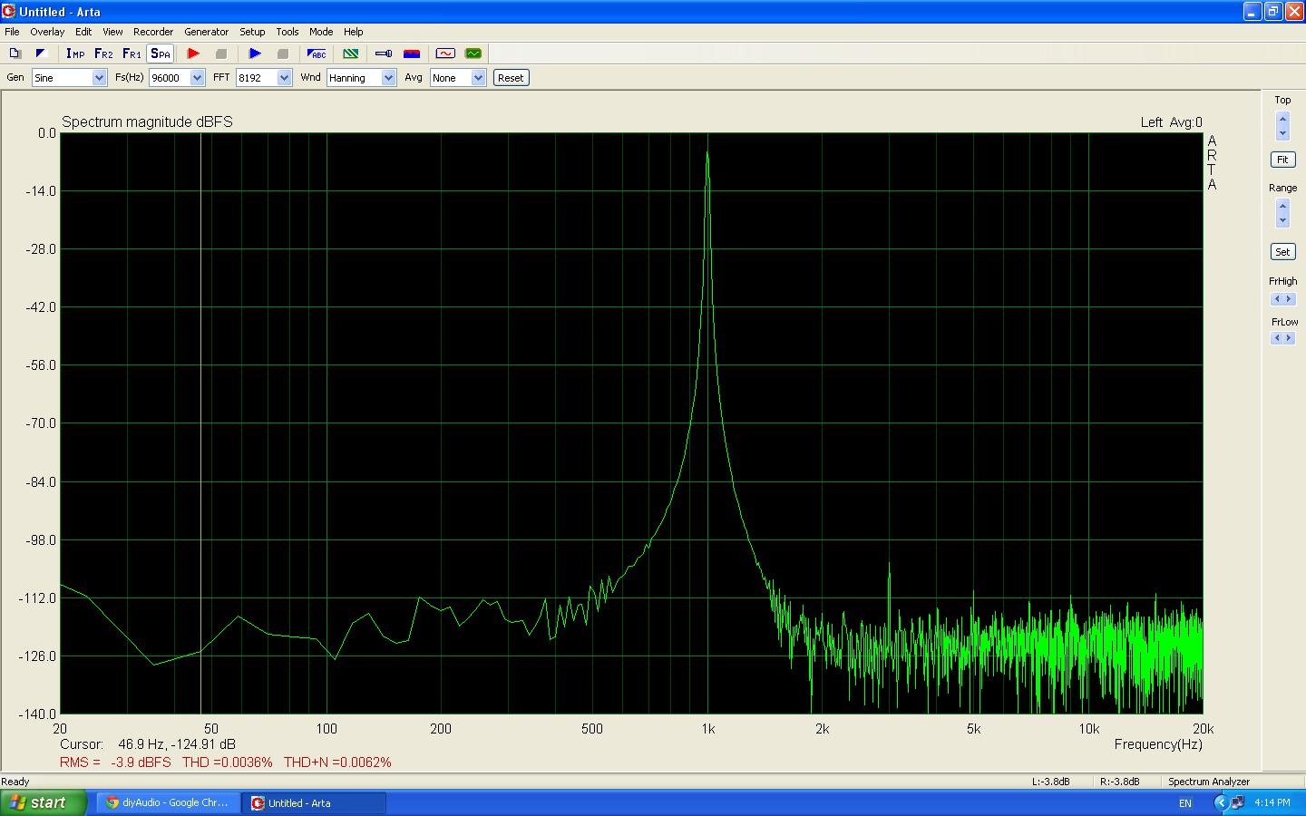

Is that loop-back test of your sound card?
Have you done calibrating in the input-output via ARTA calibration procedure?
First seeing the distortion drop is useful but you can't take the difference between two measurements as an indication of the acttual difference or absolute value. Because the distortion signals have a specific ampluitude and phase relationship with the fundamental its possible for additional distortions added to either increade or even cancel ! the indicated distortion. The residual distortions need to be at least 10 dB better than the device to be measured for the measurements to be meaningful.
I have never seen such a good measurements from a Sound Blaster. I would want to do some verification somehow.
Yes that is loop-back test and yes i have done calibration.Is that loop-back test of your sound card?

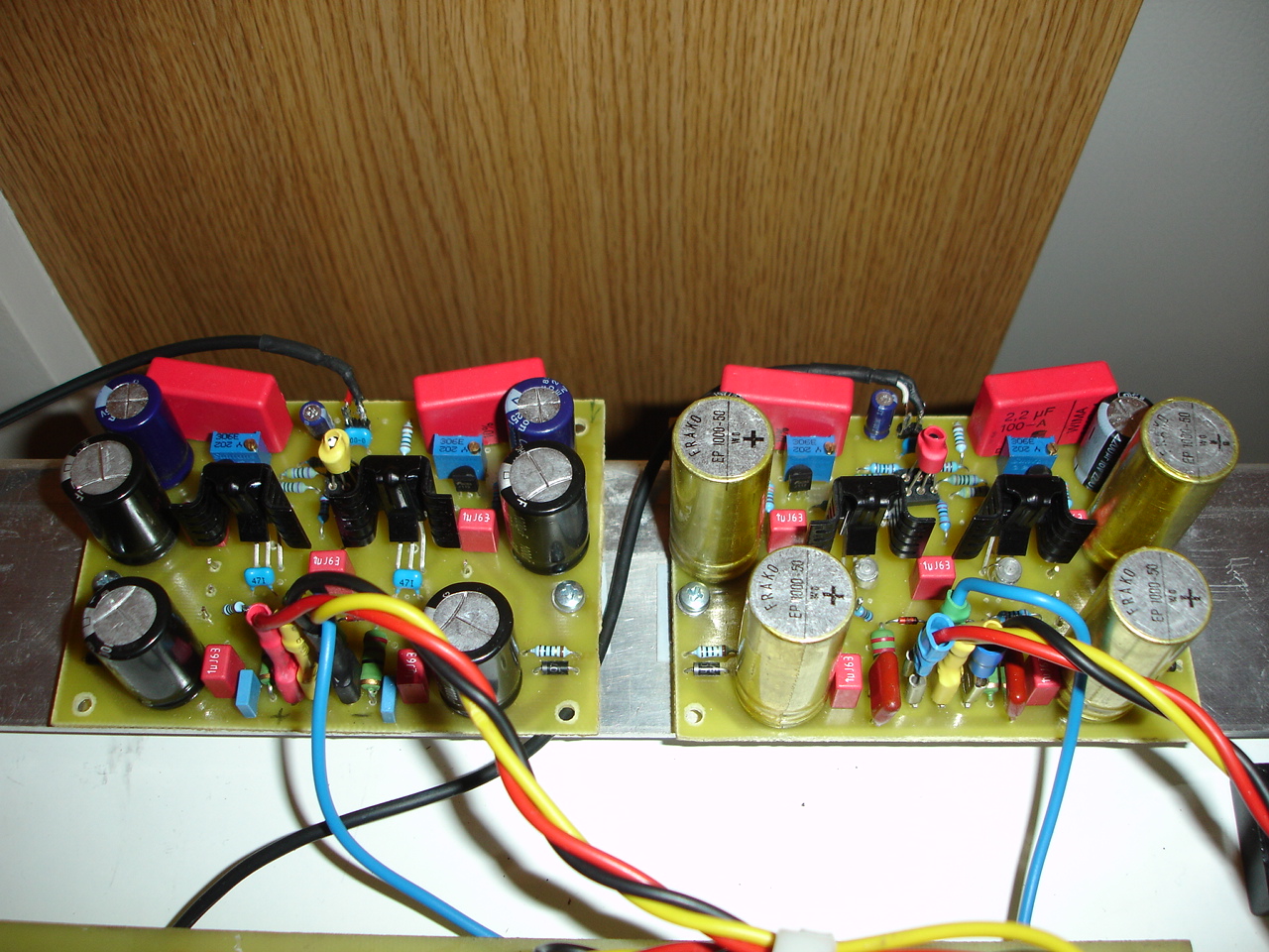

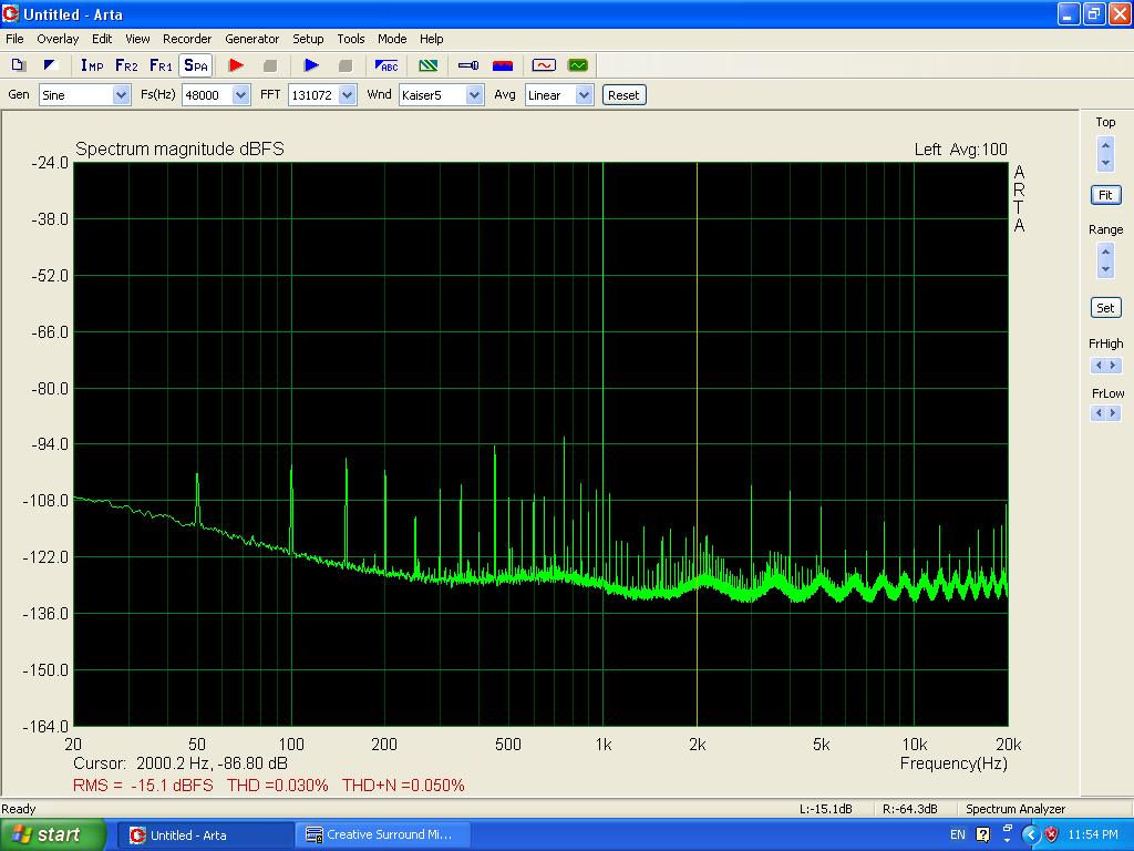

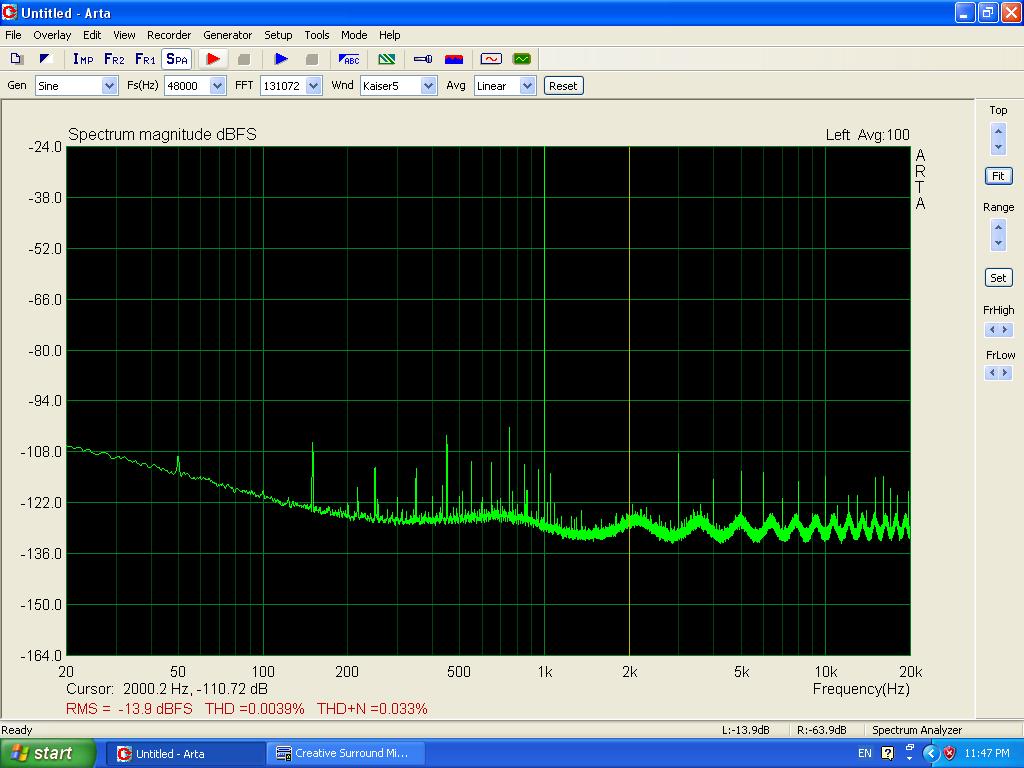

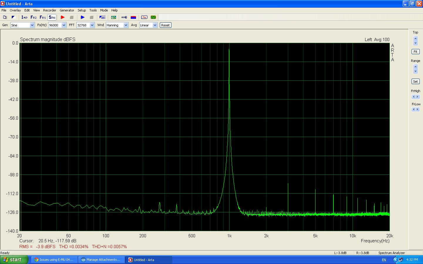

Now i have test another Sound Blaster and then i have done real measurements on VSSA the PMI ver.

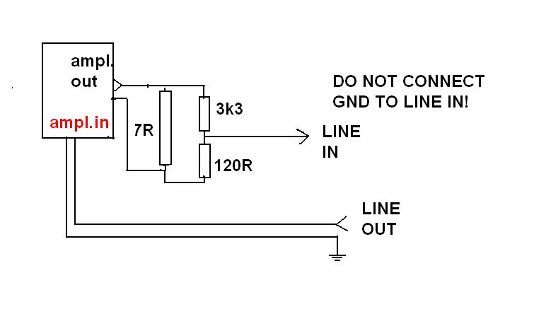

Each channel was tested separately .Rload =7R
Amplifier Power supply +/-35v
Vout =4v rms on the Rload(7R)
div.3K3+120R parallel to R load.
First picture loop
Second picture Left channel
Third picture Right channel
graph with test configuration
