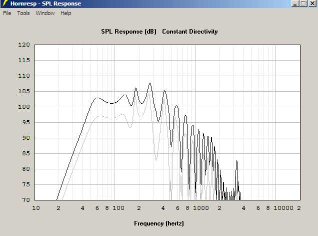

Hi tinitus,
The best way to answer your question is in Hornresp. Take any TH (e.g.: jbell's SS15), and calculate the SPL response, then change the driver to isobaric (Edit/Tools/Driver Arrangement) and also divide all S values by 2. The result should be pretty much the same response only 6dB lower because of the doubled impedance (same volatage, half the current); see attachement (and yes, they are not identical):
....; see attachement (and yes, they are not identical):
is that correctly calculated ?
looks like the peak stays the same, but useable output is much less, so...not so good 😕
If the speakers were in parallel rather than series, the output would be about the same, but would use twice the power and drivers, still "...not so good".is that correctly calculated ?
Really, the only reason to consider isobaric is when using low Bl (whimpy magnet) drivers that can't push the air column without "teaming up".

Hi Art,
Being the thread starter who lost interest a long time ago due to the fact I didn't bother to look at the driver Q before posting, I urge you to look at the first post to see why dual driver isobaric is a viable option for me. There's no need for sensitivity, the watts are there, I have a desire to downsize the cabinet, that's all. I have the 'whimpy' drivers and they aren't suited to a TH, that's the end of story for me. Thanks for adding your thoughts.
