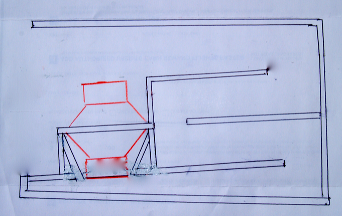

Or try this Patrick, if you insist in searching a way that might beat a TH. It will only take two drivers;
Oops, that was the wrong picture😱;

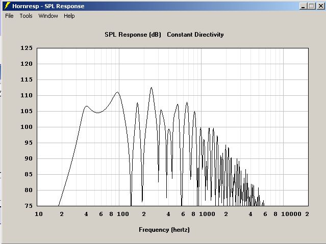

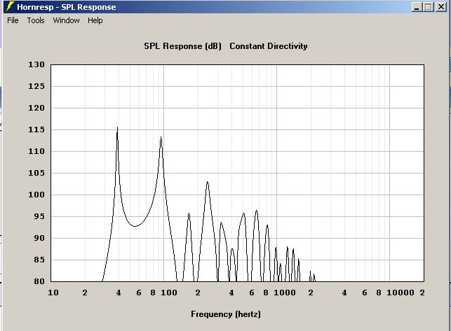

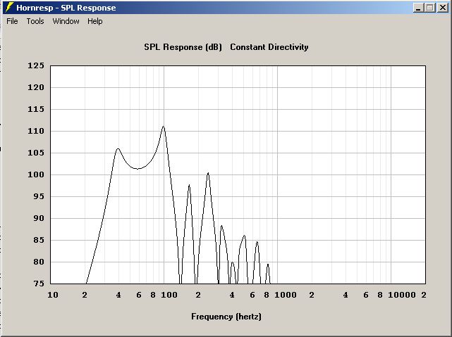

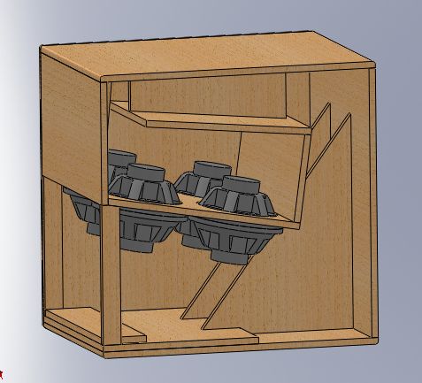

I spent a short time today playing around with isobaric TH design.
It would be possible to fit 8 10" drivers into a Cubo sub
Unfortunately the Hornresp sim is very ugly in 8 X isobaric mode!
Looks OK with 4 conventional drivers though.
Cab is Cubo sub as on freespeakerplans Home
Driver was B&C 10NW64
This is at 2.83V with all of the drivers in parallel😱
Regards Xoc1
Regards Xoc1

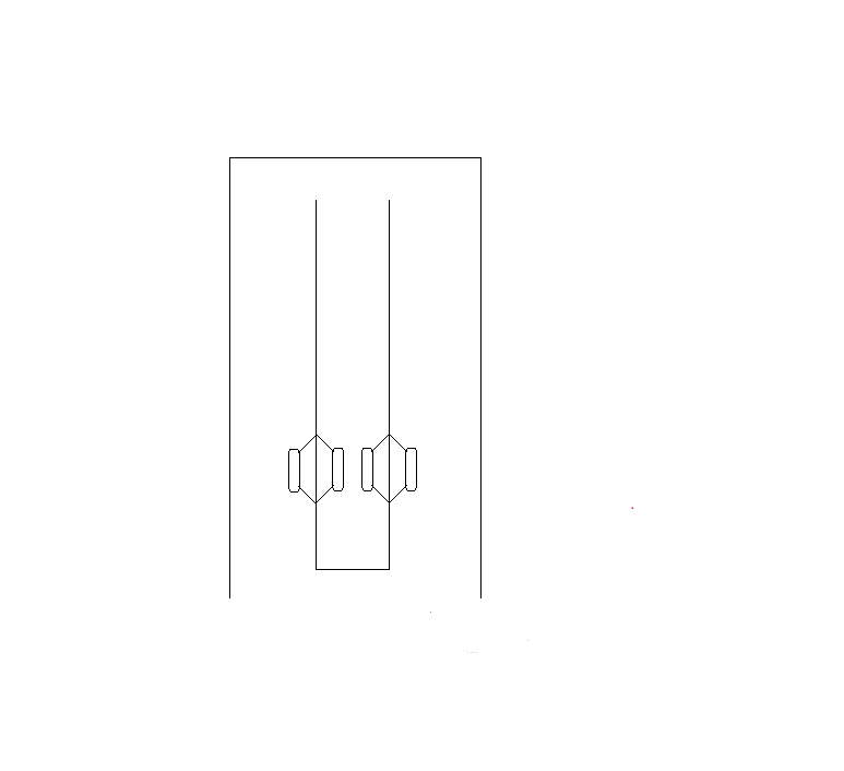

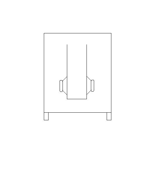

Your very quick drawing does not look like a tapped horn, and is not an isobaric loading.how about the 'symmetric' version with two drivers in the middle, playing against each other, and two port openings, one each side ?
very quick drawing
What is your "question" asking?
The arrangement you show in post #28 uses a lot more wood to achieve a given path length than the fold patterns similar to the DSL TH-115 or 118.better ? 😀
I fail to see anything "better" about that feature, unless you prefer cabinets to be heavier, more expensive and larger for a given Fb.
No, it doesn't.The arrangement you show in post #28 uses a lot more wood to achieve a given path length than the fold patterns similar to the DSL TH-115 or 118
Each layout has it's own set of limitations and benefits but a testcase I did came up with a difference between the two, within 1%. if you want a cabinet that is very high or deep I think Tinitus setup is a good way to achieve that.

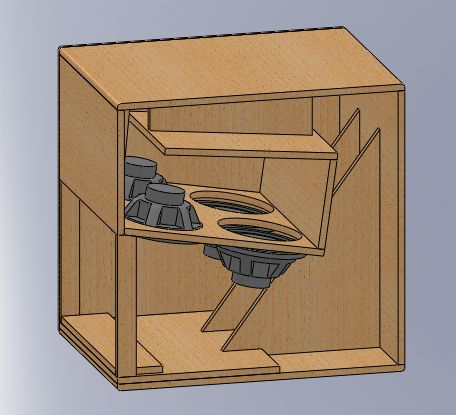

A few thoughts on this:
1) I realized that going isobaric with a tapped horn is tricky, because you can't achieve a high compression ratio at the throat. The way to get around this is to 'slide' the drivers apart from each other.
Kinda like this, but with one woofer inverted. Keep in mind you can make that gap ultra-small, even a quarter of an inch.
2) Most of the 'compelling' isobaric designs that I've come up with use car audio and home audio drivers. They tend to have a lower FS and higher qts than prosound drivers, and due to this, require surprisingly large boxes. The tapped horn that I used to have my Diyma 12s in was something like thirteen cubic feet for two woofers.
3) Simply cramming the woofers into the box gets to be a problem. Might be best for tapped horns that dig down to 20hz, as those boxes tend to get hyooge.
... Keep in mind you can make that gap ultra-small, even a quarter of an inch. ...
Unfortunately, you can't. The duct between the drivers has to have a cross-sectional area approaching the Sd of the driver. And the extra volume between the drivers worsens the excursion difference I described earlier. 🙁

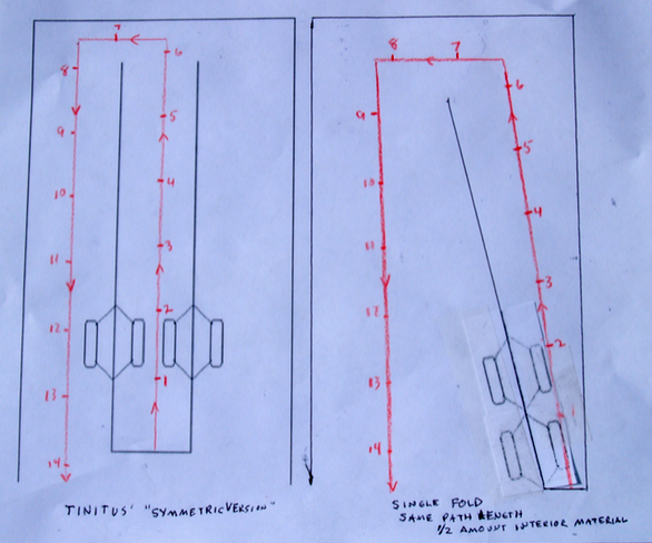

Tinitus' "symmetric version" uses double the interior wood needed for the same path length as can be seen in the left drawing.
Getting a high compression ratio with an isobaric loading is easily achievable by with a reduction chamber as in the right drawing.
Johan,No, it doesn't.
A problem arising from the isobaric setup is that the compression ratio is set to a minimum resulting from the driver depth, which is usually larger then the compression ratio needed or wanted. One way around it, is to use a chamber volume at the beginning of the horn.
