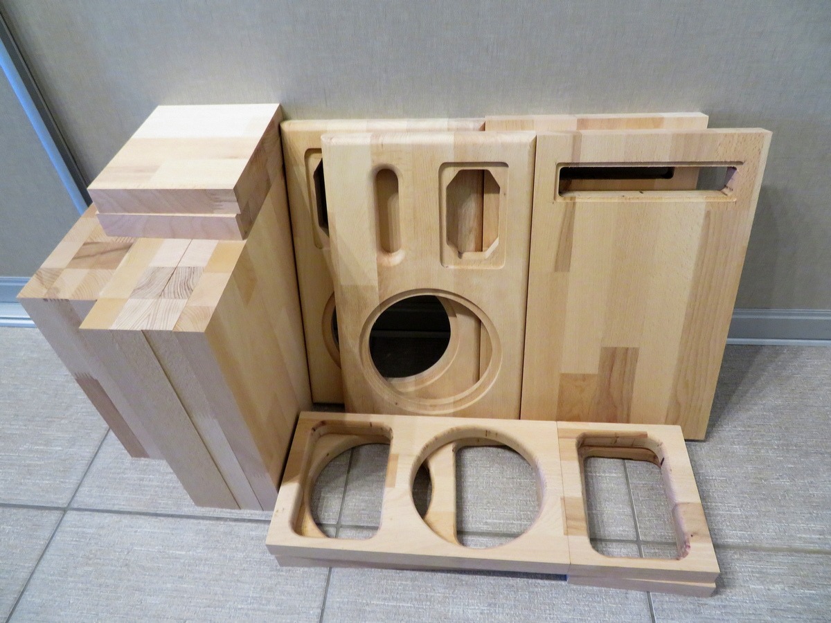

In my case, shifting from 18 to 25mm thickness will increase the mass by 39%, and I am not sure that I will obtain a great improvement on a 900x400x360mm enclosure, I mean : for the resulting overweight.
At usual moderate volume, there's no vibrations of the panels on my 375L. At higher levels, vibrations are detectable by touch, but again, I am not sure that this have a so great influence compared to the high level of loudness.
Of course, it is not perfection, I admit it... But at least, it is a compromise between sufficient panel damping and transportability !

The mass is not really relevant. Stiffness goes up with the cube. So almost twice as stiff.
If it was thicker and didn’t weigh mire would be better. But in real life that would mean a change in material.
Perhaps the 18mm quality BB would be as stiff as 25mm MDF and weigh a bunch less, so resonance/vibration goes even further up.
I’d still put braces.

113L no? Guess 3.75 cubic feet.About the mass : my 375L weight 30.0kg each, in working order. For a HxWxD at 750x420x360mm enclosure made from 18mm Beech hardwood glulam, including internal bracing / filling / crossover, etc. I think that it stays reasonable vs. the damping of the panels.

Well, to obtain the neat (free) inside volume of the 375L, you have to substract :
- the Midrange "Flower Pot" cavity.
- the internal bracing.
- the internal volume of the speakers (minus the Midrange, which is already in its cavity).
- the crossover.
- the lateral and back integrated handles
- the port.
Finally, the inside volume of the 375L Bass-Reflex shifts from 89L brut to 75L neat for that 3 ways speaker.
With the addition of the filling material (100%), the acoustic volume reaches 85-88L.
The same calculations give also 75L neat for the 4 ways project 475L Sealed Isobaric also... 😉
