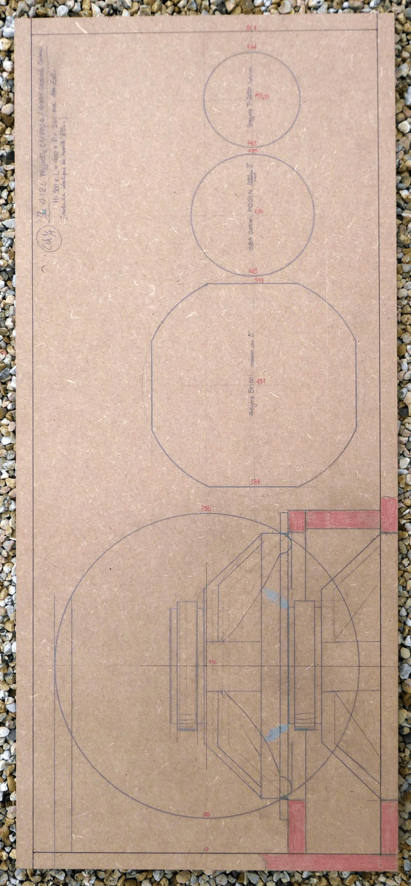

You couldshrink the chamnber a bit more, smaller the better, the triangle is a nice touch.
Yes, certainly @planet10 : for this, I need to trace the project at 1:1 scale to determine exactly the minimum required chamber. 😉
The slanted internal woofer panel doesn't go in that sense, of course, but I guess it can be nontheless a benefice for reducing internal reflections, plus I think that it clears the back of the woofer better from the back panel.

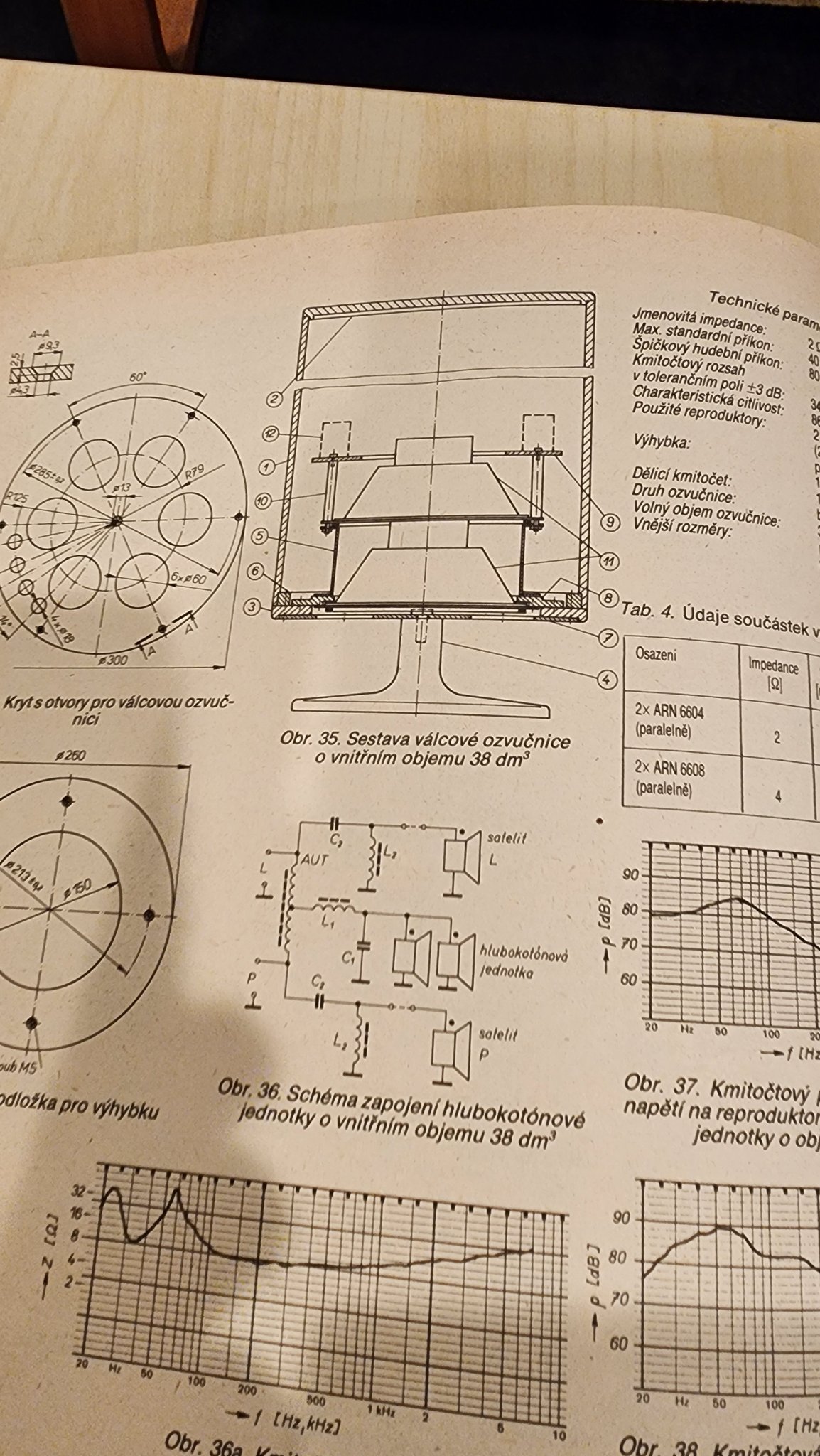

I have an old magazine i followed back in socialist czechoslovakia, there were big plastic tubes like water pipes used.
It was cca 1986. I believe. I made dual isobaric subwoofer from concrete. Square box. Four 10" woofers, two on each side. Sub was heavy and it takes two people to move it. Its still functional and its still there in the room where i grew up as kid. I use it when i visit relatives.

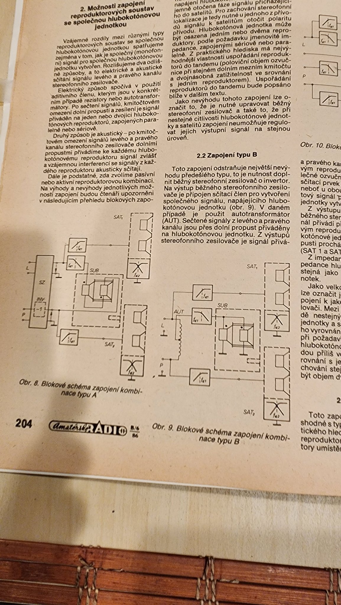

Example of the magazine we had that time...first it explains all the theory, then there are construction details for many options. This magazine issue is about satelite/sub approach and about isobaric subs.

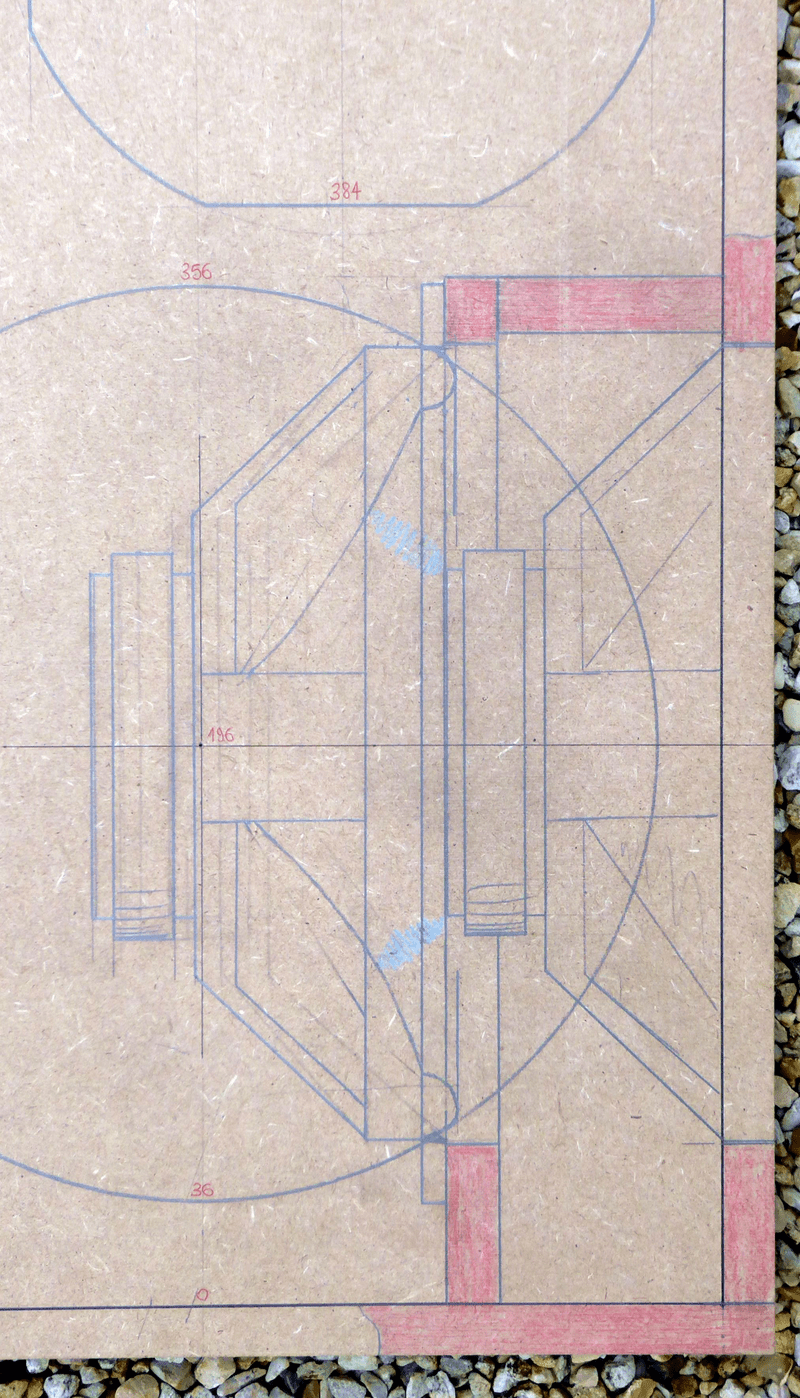

Scale 1:1 drawing, here with vertical back speaker panel, in order to minimize the chamber :
I think I have been too far in reducing the chamber volume : the magnet of the front speaker closes too much the cone of the back speaker... IMHO, this is not a very good idea : it could possibly have notable effects on the dynamic coupling of the two speakers... 😕
I think that I will return to a slanted disposition, with a bit less minimalistic chamber, in order to free more the cone of the back speaker, to avoid facing too directly the magnet of the front speaker. 😉
