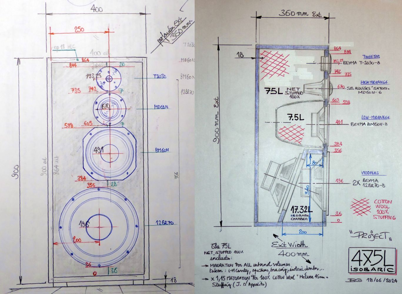

To the OP: I noticed appreciations for your presentations, but perhaps not enough for your constructions—I think the woodworking is handsome, and crossovers are visually well-made.
Thanks @howardg ! 🙂
I also am aware that musicians often want something slightly different from loudspeakers than some audiophiles do. I sometimes feel that what I like is not the same as the current high-end trends.
Yes. I am in this case too... 😉

Yes, on my 475L ISOBARIC, that transistion is set at 300Hz between the Bass and the Low-Mid.
I'm not sure that using the Isobaric principle for a Low-Mid frequency range offers a great interest, with or without additional low-pass... That said I never tested it, OK ? So what advantages have you in mind ? 🤔

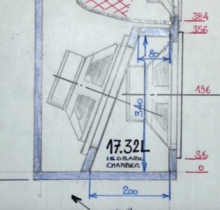

On the 475L I admit that did not matched particularly the woofer pairs... My choice criteria was that they were suitable for a Sealed enclosure operation, since it is an Isobaric Sealed one. I guess that for a Bass-Reflex enclosure, you would obviously choose speakers suitable for BR operation.
A point that I considered when designing the chamber, is that the air flow always met at least the back SD of one speaker, to avoid any additional air flow surface reduction between the two speakers.
