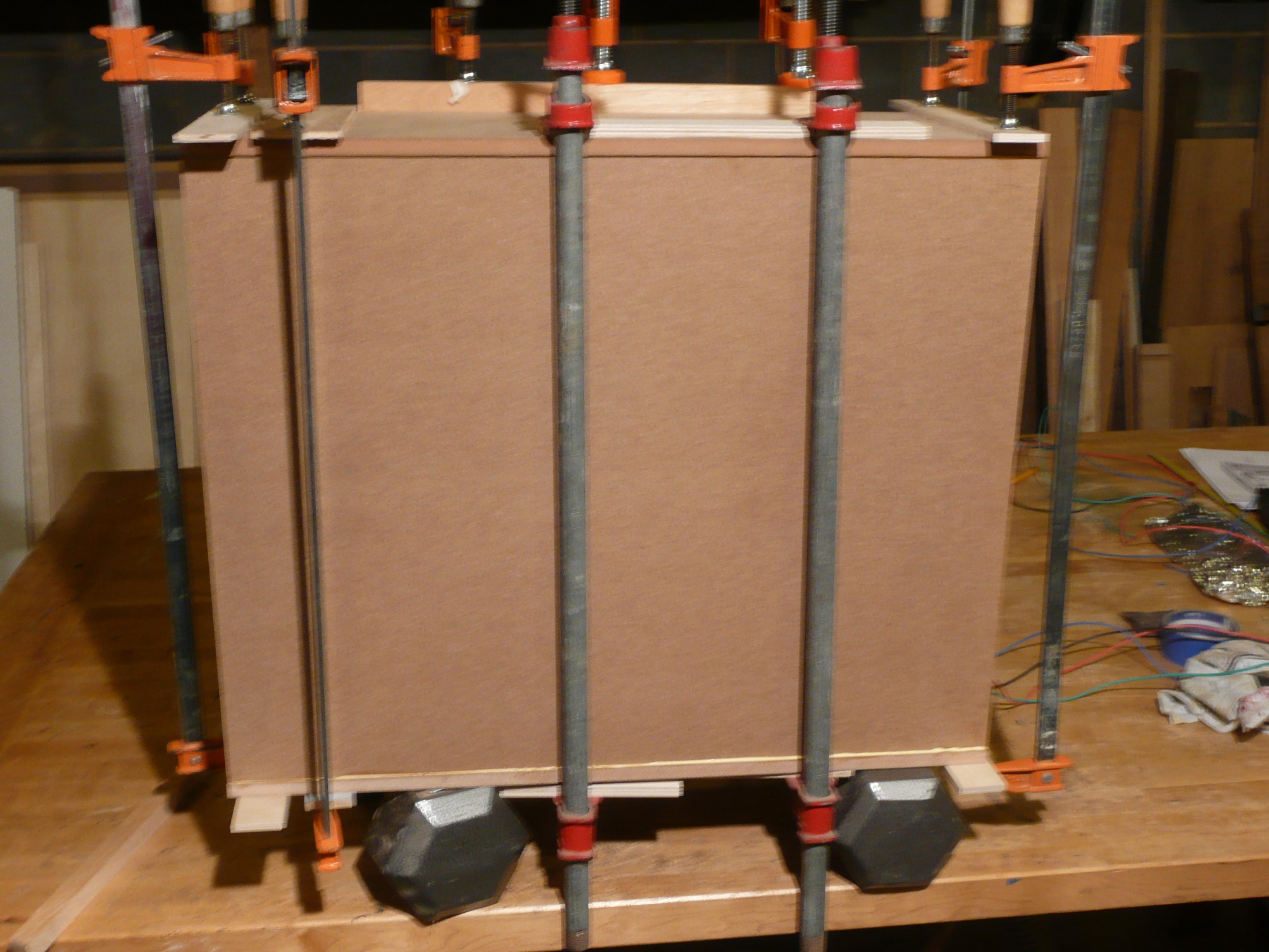

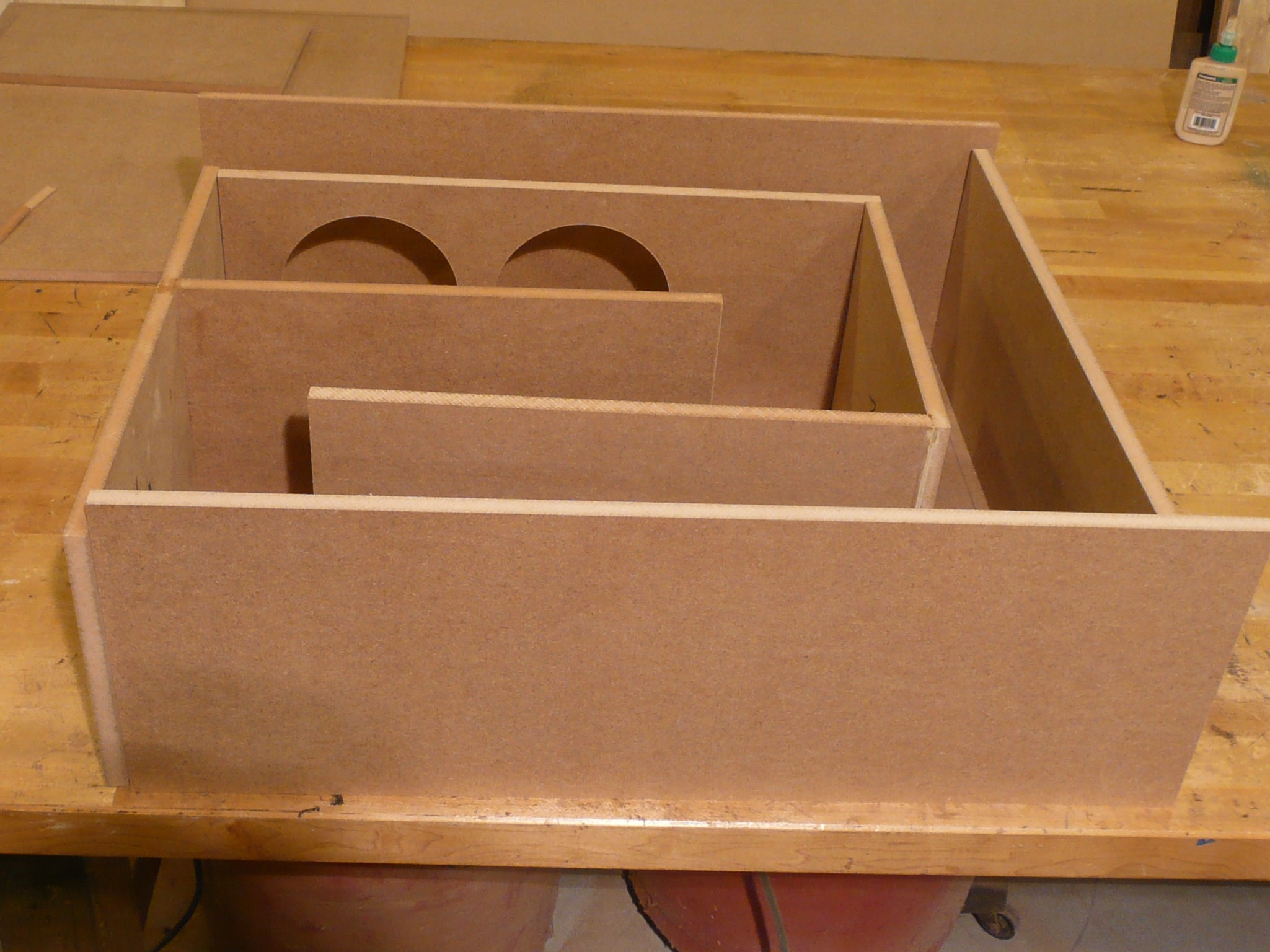

Where do I put the cheese?
Almost done....will go to work tomorrow.
Not getting nervours are we?
- Right behind the terminal cup, you can use peanut butter to hold it in place.
- Good, I don't want you to run out of speaker building $$$
- Looking at the B2-B3 joint makes me a little nervous actually, is that correct dimensionally?

No worries, they were not glued, and they were all "long".
We'll have the results soon.
I checked everything with a 24" framing square, its good.

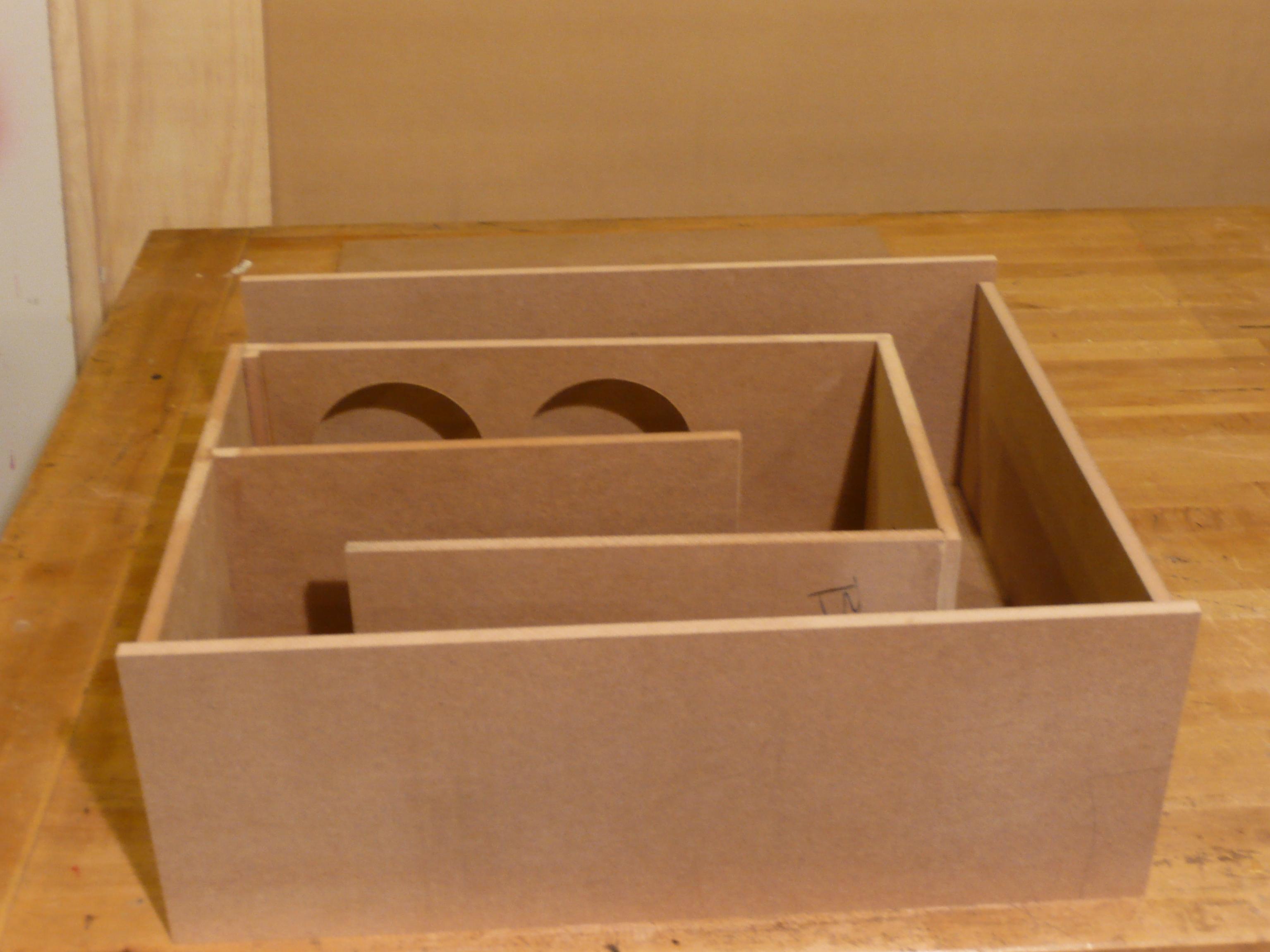

1-40Hz dual driver TH at full output with these drivers is roughly what you get out of a SS15 with a few watts. Why not build the jbell bass sticks with the 55-2421 for a small rig?
By Small I meant like House Karaoke Parties of 50 ppl or so, for anything 50-100ppl I am building a Line Array.... 🙂 For fun... 🙂
I also have some karaoke machines that I am building so I wanted some options on a good subwoofer box that was about 12x24x18 (HWD)
Good that you bought them, before they run out.
I would just build two of the boxes shown, you'll have more flexibility, E.g. stack them together, or set them in different parts of the room. I like the 9"width.
I'll use 1/2", found a sheet of Medex, one grade above MDF.

Oh boy, not even close, just a bonking noise. Something is terrible wrong with the TH box.
There is some bass, but the hollow sound is 10X as loud. Maybe best if the moderator removes the plans.
For the folks that bought the woofer, don't be alarmed, its fine. The test box with the 10" PR sounds like any sub that would hear in a HT, music room, etc.

Bummer, are you running them as subs? You confused me earlier with the description about how you intended to wire them up. You definitely have to use a crossover and the drivers have to be in phase and receiving the same signal.

sounds like something is out o phase if you hear hollow sounds. check wires... quick.

Oh its very bad......I can't belive how bad. The cardbord boxes the speakers came in would a better build.
Yes crossover, even set at 32hz it bonks.

Have you checked the drivers are in phase with a battery?

I agree with Dan, have you tried flipping the phase on one of the drivers? one of them may be wired backwards internally.
something else is wrong, how much power are you using?
edit: did you flip just one of the drivers leads or both at the same time?

I was getting skeptical if this was going to work when building it, even when giving it shout in the speaker port, it echoed like the Swiss Alps.
The walls are narrow, so maybe that has something to do with it, but I don't have a clue what is wrong.
I'll give it another try, but there is no way.
120watts per speaker - same as before.

Series connection ~ okay much, much, much better.
I tried one channel from a 60watt amp - the one channel from the 120 was a bit better (the 60watt was ice cold).
Still hear some echo, not that bad though, I can see where the right amp could make this a hit.

Since you actually built what looks like a tapped tapered transmission line with the drivers mounted inside the mouth, perhaps some stuffing would be in order??

I moved the speaker around a bit, set crossover to 60HZ. Using one channel from a 120watt amp, series connection. The bass is pouring out, it is very pleasant.
The speakers are 4ohm each, 8ohm in series, when it was connected 4ohm per, it was just too much; apparently. Apologies to TH fans.
