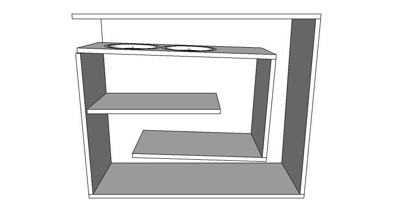

You willing to try something different for the new year? 😉

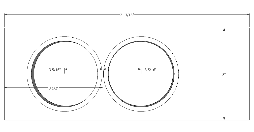

I will send you a 6 layer tunnel if you ever want to try the MCM Iso box, then all you’ll need is 2 pieces 17" x 19" (sides) and about 84” of 10" rips.
Thank you again for the design, this is for the 6 ½”, 299-114 woofer?
[This Iso box is not too bad, as long as it is not played too loud]
Your welcome Doug,

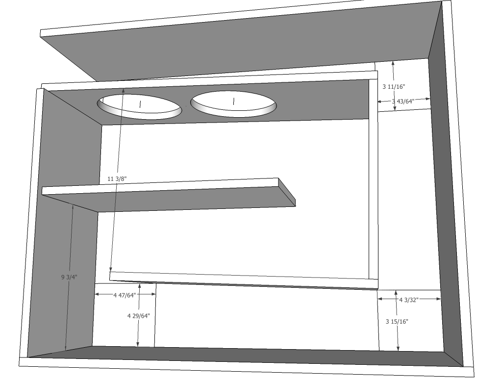

I figured I'd give you a taste of something different instead of whining. Although the 299-114 is not a strong driver this should be an interesting contrast in an A/B comparison. I would rate this as a ~30Hz box and it should be a good deal more efficient, no shark tale on this one though. 😀

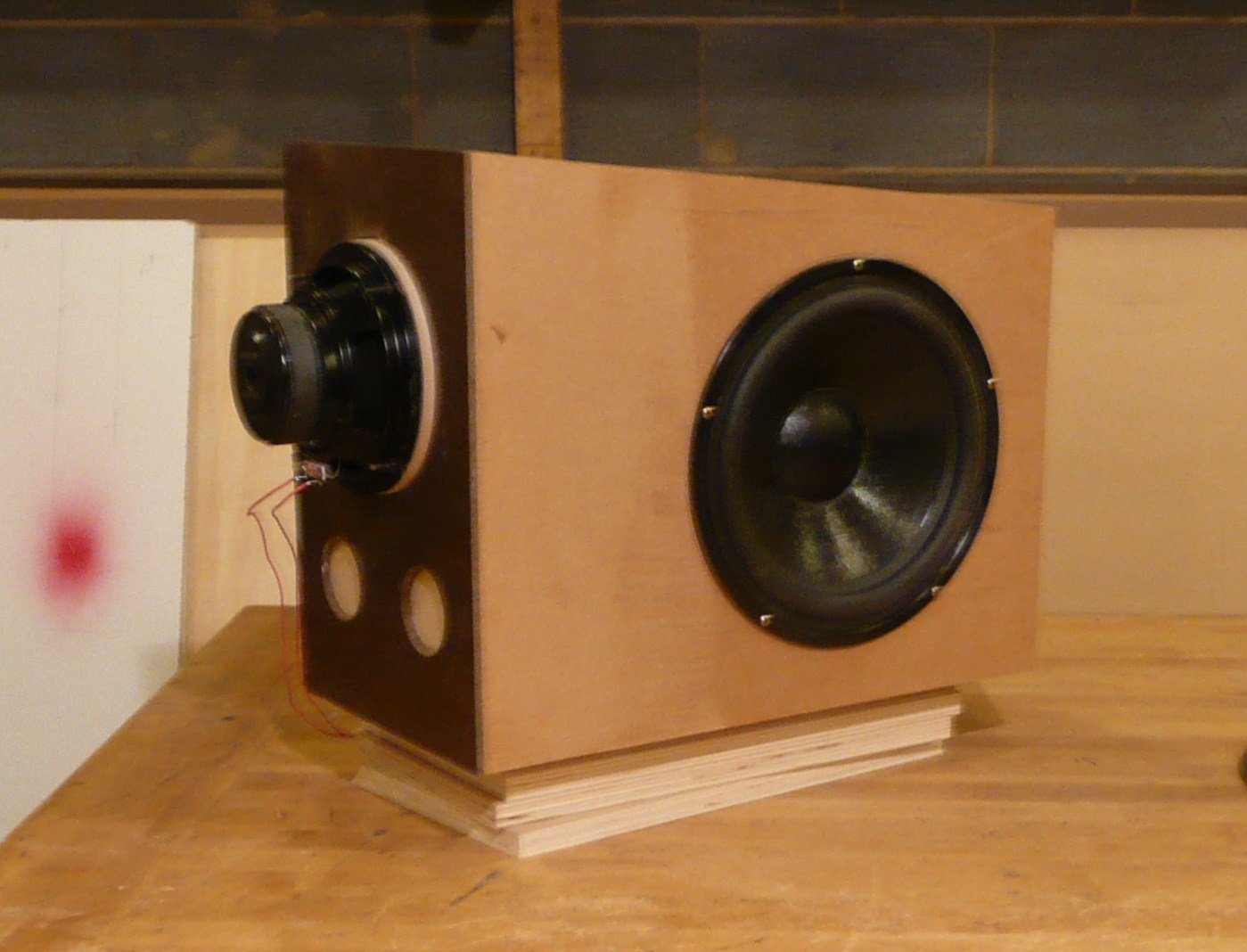

Don, thanks for the advice
I went with #2 since the supply stores are closed today and I couldn't buy material.
It is about 2x as powerful (maybe more), hard to believe these are $8 woofers.
The crossover issue is gone, i.e. no more ringing.
This is not much of a box at this point, but there are no rattles. As far as weights I guess at 50grams (a USA quarter is 5.6grams) so I used 10 fender washers.
Okay, it won’t break glass, but somewhat amazing for what it is.
box size 8-7/8" (rips) x 17-1/2" x 12-7/8".

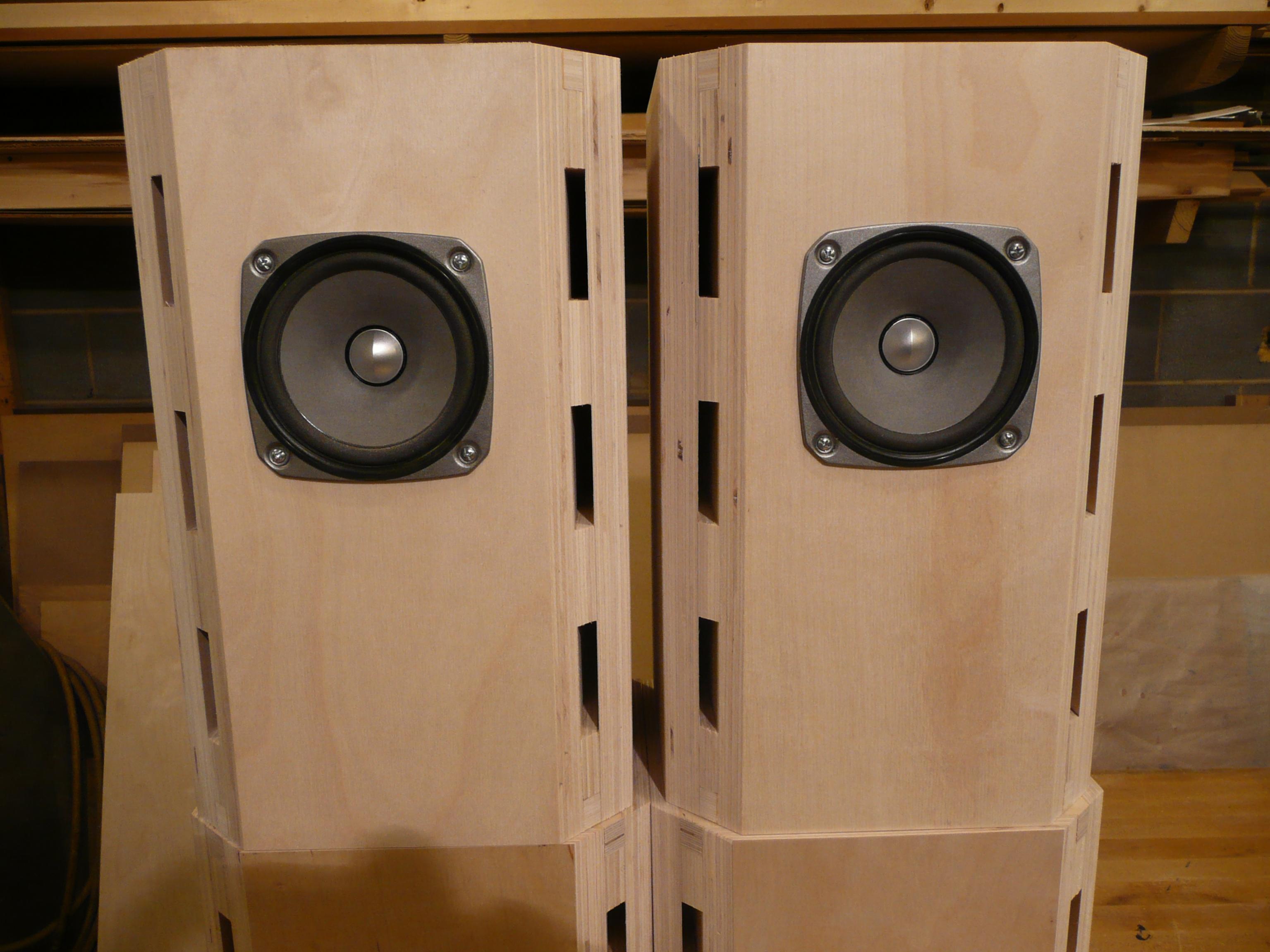

oh I've been busy.....check em out.
A pair of Fostex 125wks - aprox $120.
New sub box - aprox $40.
The sound is very, very nice.
Now I do need to rebuild the test sub box shown, I was going to go with the keystone shape, PR in the back.
This design has a 1.75db rise at 34hz, according to computer modeling. Now if there was a fellow that was wizard in WinISD, I'd sure like to know if I should go with a slightly bigger box. (existing box 1.16cf, tuned at 33hz)

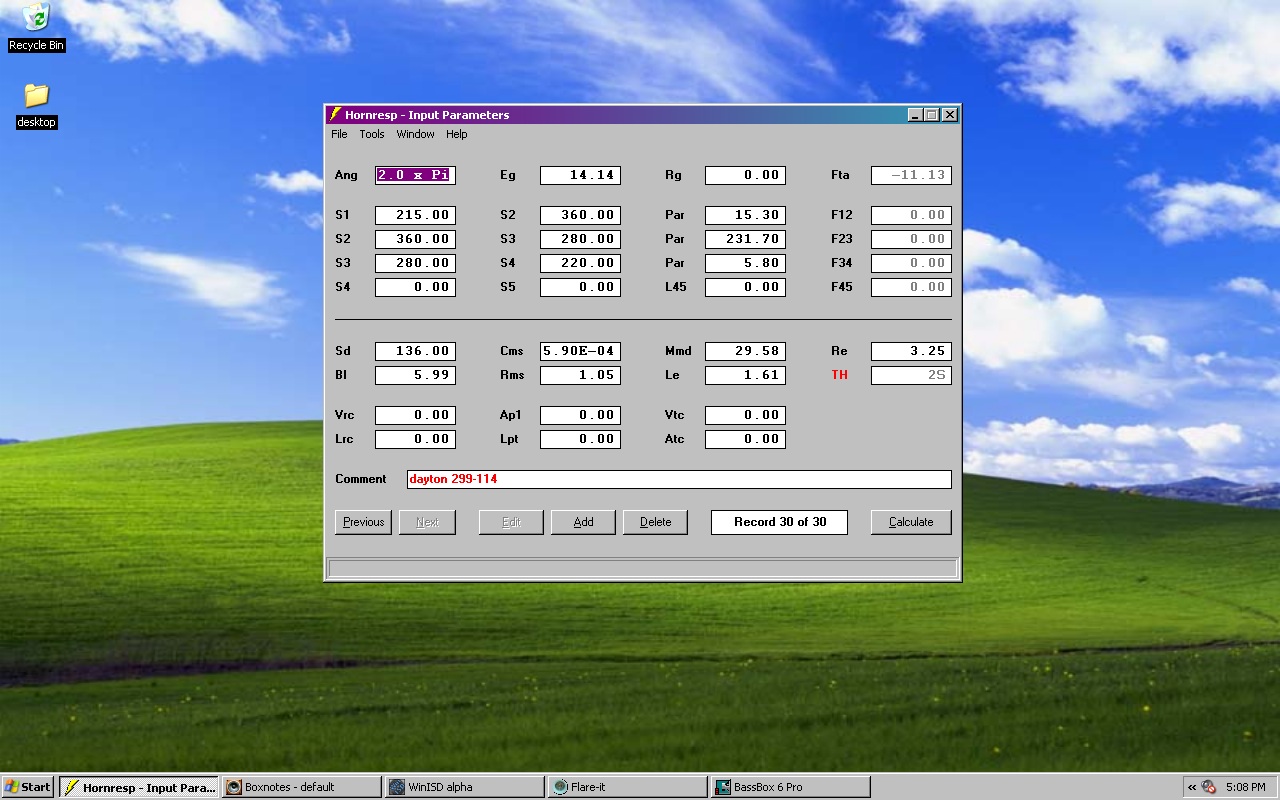

How sweet widdle baby onkens. 😀

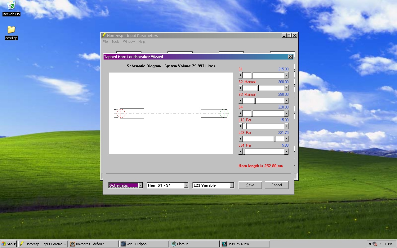

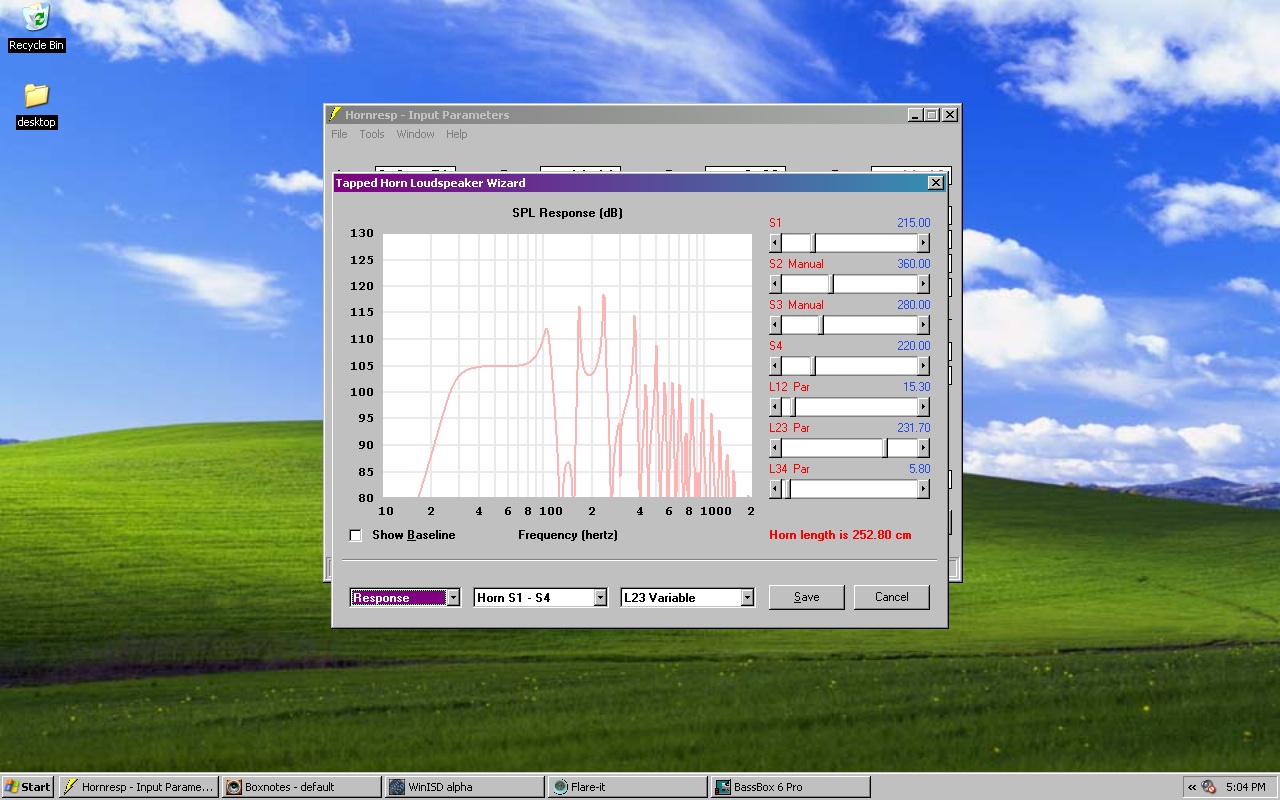

You really should learn Hornresp.
That's kind of the plan.
Those little drivers work well in a small TH.
Yesser fer $5 they sure do. It don't take 80l neither.🙄

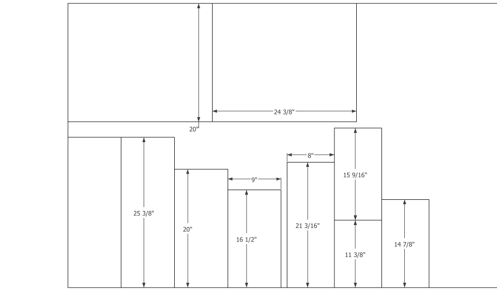

The 8” speaker baffle board would have to be “behind” the 9” outside board.
Really? Whatever keeps the OCD twitch at bay man.😛
If you think about it the sides are braced every 3"-7", so 1/2" material is more than adequate IMO. You could always build in ply, but no need really. I'd save the good stuff for something down the line once you get a handle on what you want from a TH.
If you get your handle changed it should be Verdana:
HTML:
[FONT=Verdana]Dan, I thought I would build the TH project next; the illustration is a little off, I think.  [/FONT]
[FONT=Verdana] [/FONT]
[FONT=Verdana]The 8” speaker baffle board would have to be “behind” the 9” outside board.[/FONT]
[FONT=Verdana]Also, was considering using ¾” mdf for the 20” x 24-3/4” sides. The 9” boards would be need to be ½” wider.[/FONT]
[FONT=Verdana]Looks like fun, thanks.[/FONT]
