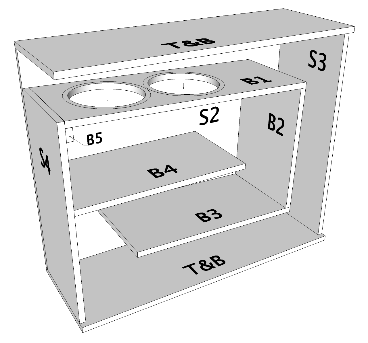

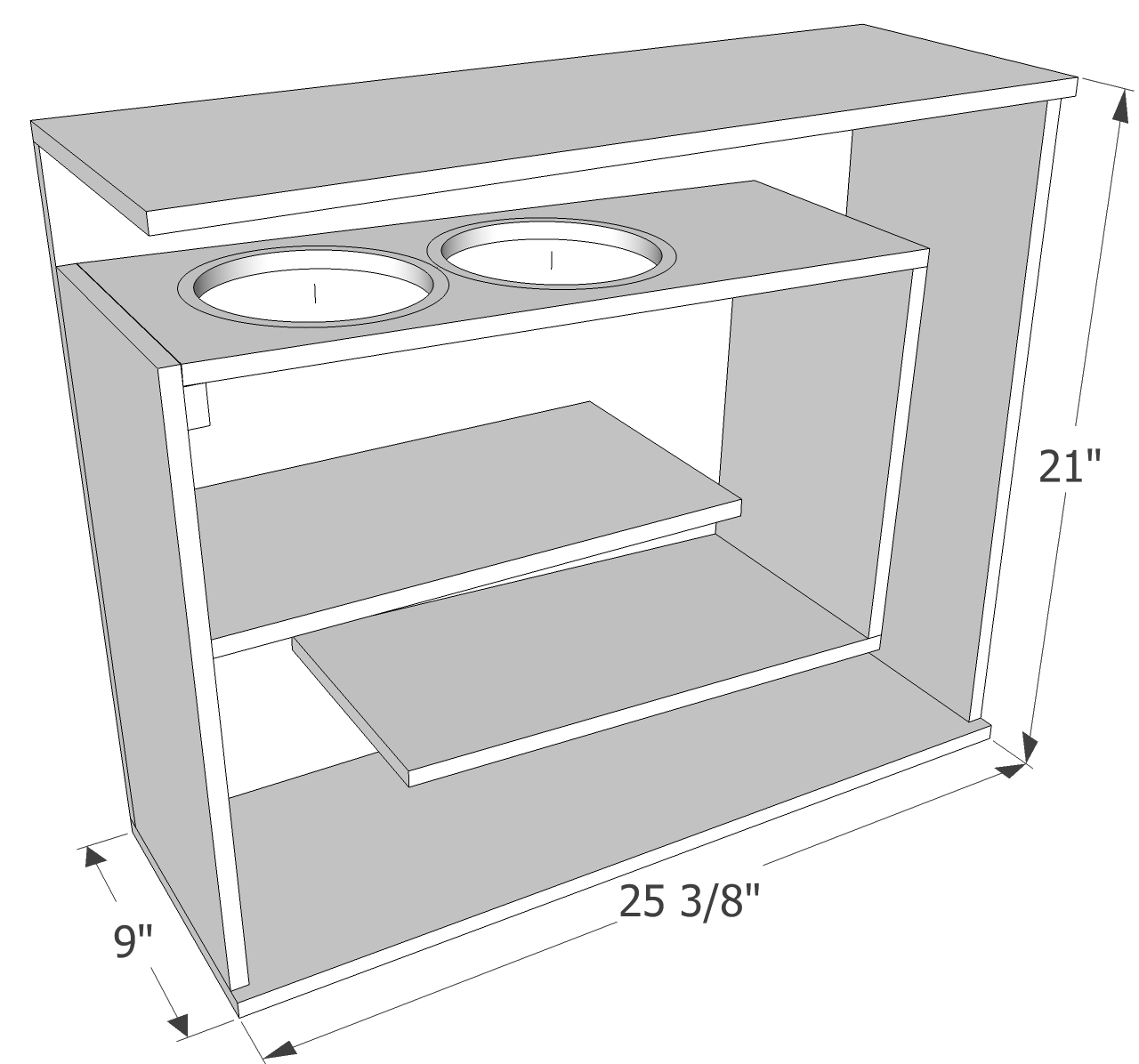

dimension needed
Hi there ND: Can you supply the dimension for the "free" end of the mid board (the one directly behind the drivers) and also the mouth opening? You have supplied other dimensions from the bottom of the pictoral drawing or a string from the bottom (assuming 1/2" material?) Regards...Michael

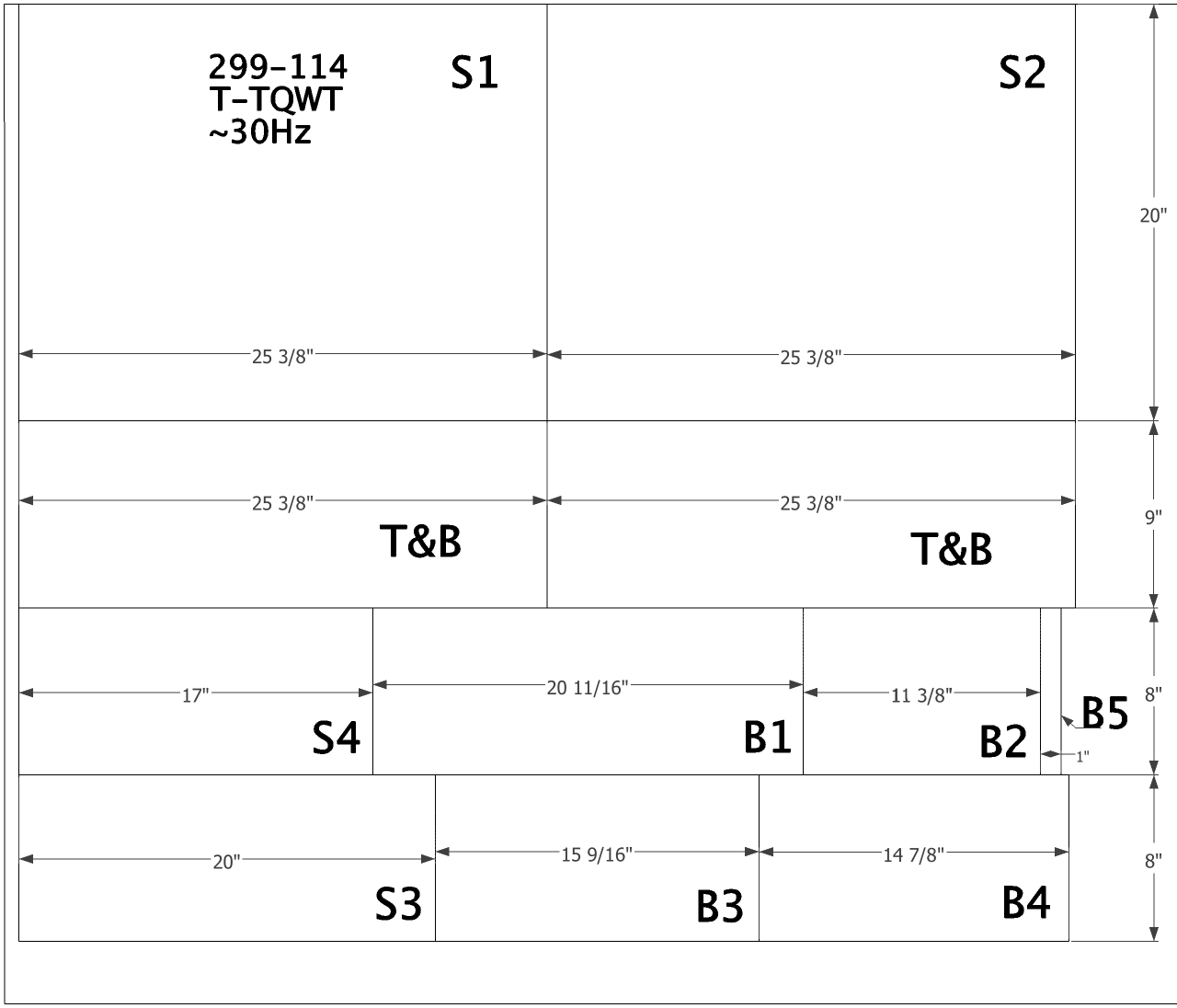

Hi Michael,Hi there ND: Can you supply the dimension for the "free" end of the mid board (the one directly behind the drivers) and also the mouth opening? You have supplied other dimensions from the bottom of the pictoral drawing or a string from the bottom (assuming 1/2" material?) Regards...Michael
All joints with the exception of the one at the mouth are 90°. The mouth opening is ~3", just a hair under because of the angle. I think you are asking about the 14 7/8" board, it is 9.75" from the bottom(inside) of the enclosure, all internal boards are 8" wide. If I am home tonight I will redraw the enclosure and cut sheet for an easier assembly and glue up. In doing this I will make the top and bottom the only 9" wide pieces.
Go for it, nothing is changing except how it goes together.

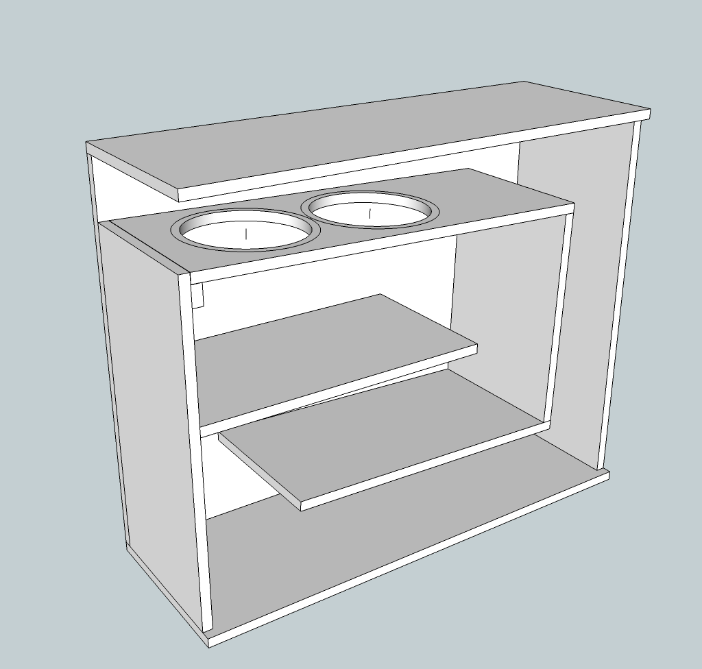

Here's a preview, It'll be later tonight before I'm done, I've got to run an errand.

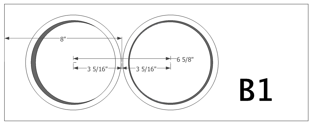

I don't think this is a good idea as the driver would be shoved right up against the top panel and it would create an obstruction in the path.Is there any reason not to reverse one driver (+ wiring), for some distortion cancelling?

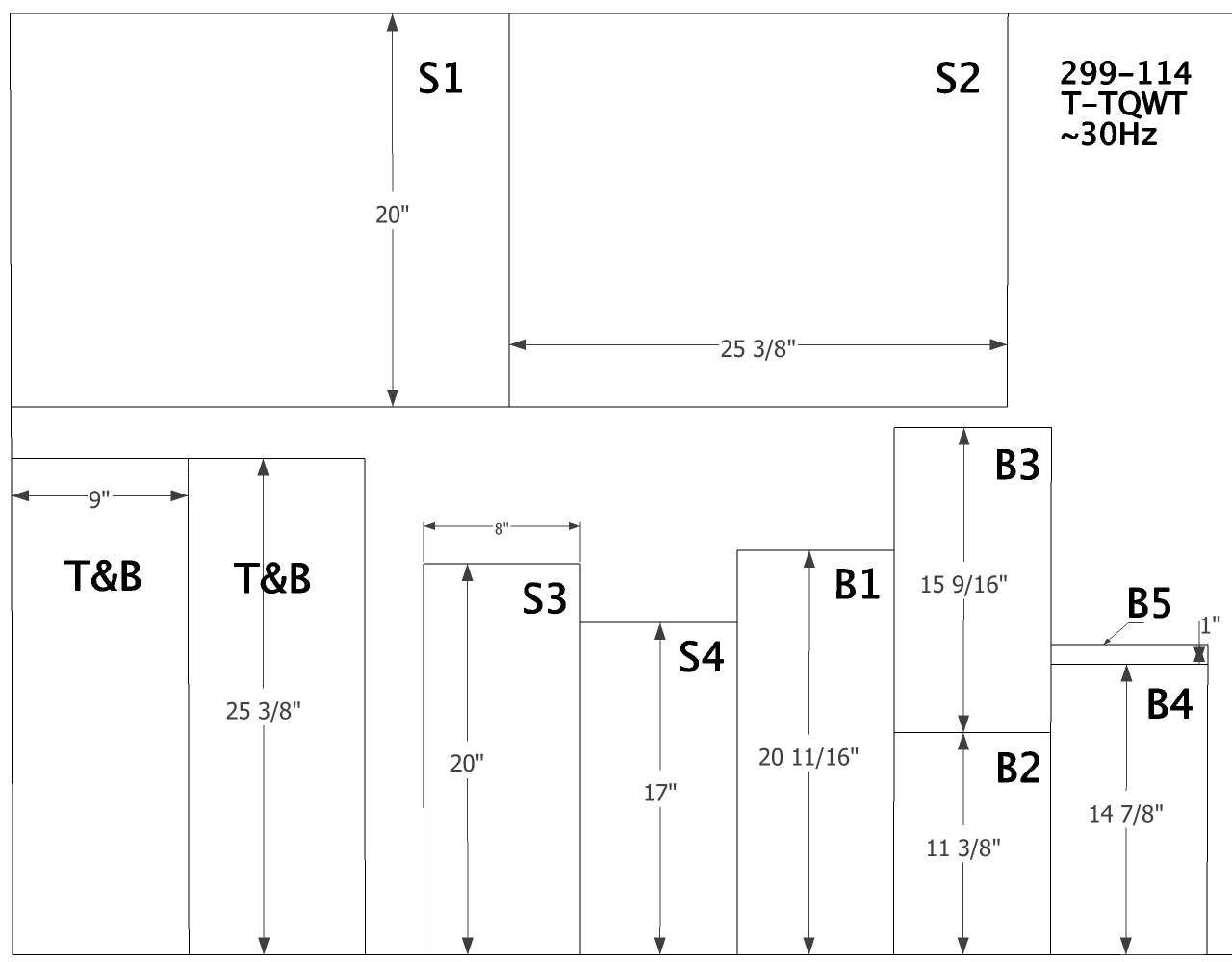

OK here it is, weirgen 0.2 😀

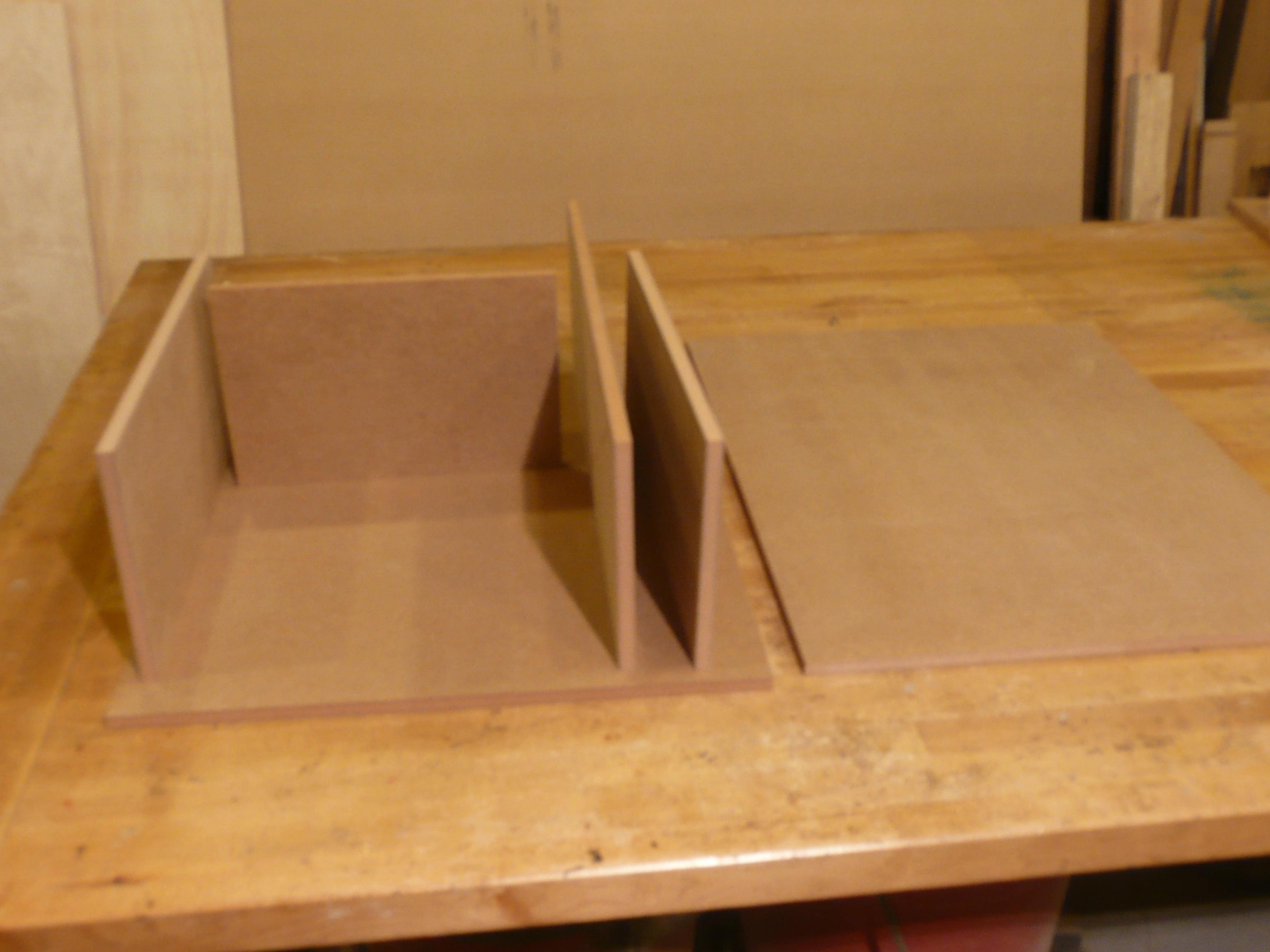

Yikes....I'm taking off tomorrow!! Pieces are cut, starting tonight.
Power wire right out the back?
Round over the edges inside?

- I wouldn't take off work, however YMMV.
- I'd probably come out with the wires below the mouth as it should always be accessible. I'd use some cheesy spring terminals and a BO$E logo in Sharpie right there. 😀
- The mouth is the only spot that might potentially benefit, I'd skip on the rounds at least until I'd tested. You should not have velocity problems with the internal path like with the small ports.

NEO, If B1 sits behind S4, it needs to be 1/2" shorter to keep the 3-11/16" in the back.

Thanks for(attempting😛) double checking the numbers, really. 🙂NEO, If B1 sits behind S4, it needs to be 1/2" shorter to keep the 3-11/16" in the back.
Cough Cough.
If you look at the first cut sheet you should see the difference has been adjusted for already.
