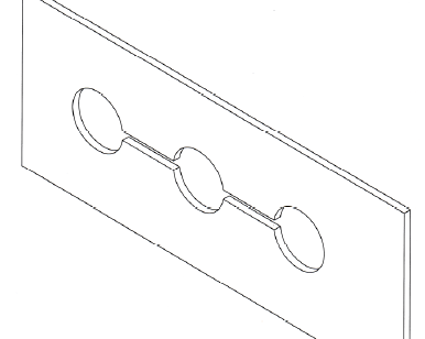

Cut a slot across (pic) all the holes that you have used to take the TX cables through the chassis and put some grommets or sleeving over the cables.

I have the hat type nylon washers for the transformer just measure the hole diam.
Nonmagnetic bolts are another good thing when dealing with transformers.
I agree on the feed and return cable nicely twisted through same hole aproach.
