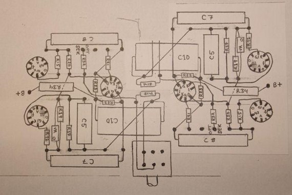

What happens if you parallel 220K across each 270K? Are they physically joined to the 47K in your build BTW?
Hi. Not really. I found some, unfortunately low resolution pictures, on my physical planning layout. In the scetch, if we look at the right side the grid leaks are R19 (parallelled with a VR pot that I have now removed) and R20. The 47k is R21, directly to the lower 12AX7 grid.

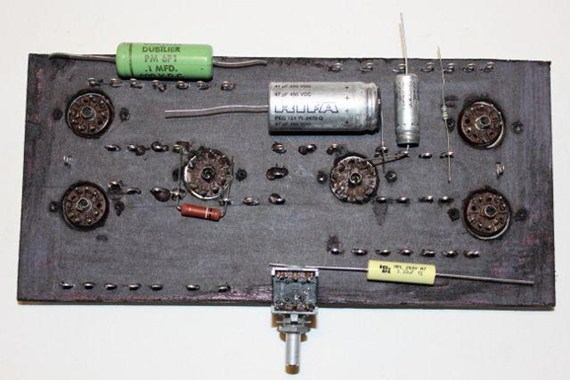

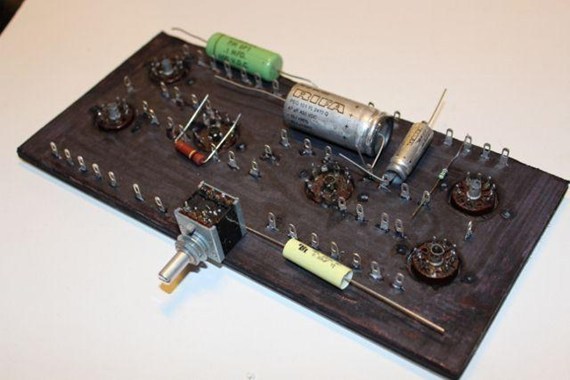

The plate that I built it on is two 2-component glued hard paper with lead ears on.

The 270k ones still refer to the node where the 47k and a 12AX7 grid refer. Does the 47k other side meet gnd along with the EL84s cathodes components?
I'm at some negotiation table atm so I cant check but I have some connected ground pins in between the 12AX7s and as I remember it it goes directly to them, same as the EL84rs cathodes components. Grounds are channel separated (together with the last 47 uF C in the small signal filter) up to a leadstand that is between the circuit on one side and the OPTs and RCAs on the other side where all audiocircuits meet. That one has a 2 mm copper up to PSU ground.
OK, just verify that those sections are following the schematic exactly for connections and then try to lower the 270k resistors value by // other values to see if a change can happen.
When you had a probe there it changed something, lets see what. Maybe a tighter and more symmetrical physical layout around those points will play a role even.
I also wonder if there is an error in that schematic that shows no dots for nodes. What would happen if those 270k had gone to the 47k other side to ground for instance. But I did not spend time to analyze.
It would change the balance in the Floating Paraphrase phase splitter is my humble opinion. The signal to the lower 12AX7 grid uses the EL84rs gridleak.

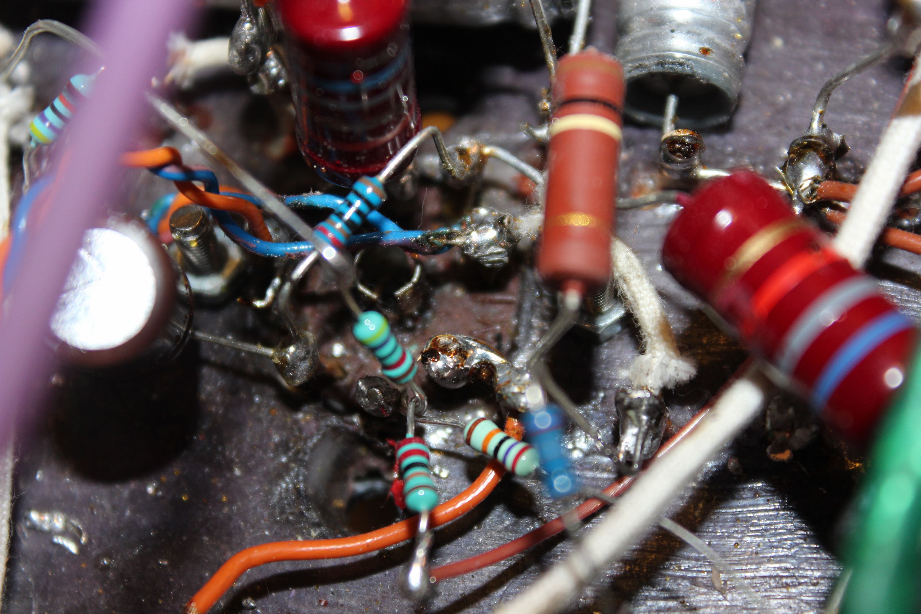

I just remembered, and verified passing by home briefly, that the "tighter and more symmetrical physical layout" was just what I tried last time I was trying to track this down. On pic (yes I know it looks like
in closeup. It does when changing stuff alot) I have putted them all, two 270K and one 47K directly on the pin as experiment.
Salas, not that I mistrust your opinion about classic oscillation, but what was it that lead you to that? The very wiggle formation on the scope, the behaviour when I moved probe or the motorboating that starts when I simulate music by pushing different frequency buttons on gen?
Though.... I found on inspection that I for some layout reason has ca 15 mm wire left between my 1k Dale unmagnetic WW gridstoppers and grids.
Is EL84 that sensitive to grid oscillation? Experiences anyone?
Well I will try to shorten them later, but I dont have the time now.

When you touch (not in HV) or load a node that oscillates with some other impedance like a probe, it changes behavior or stops many times.

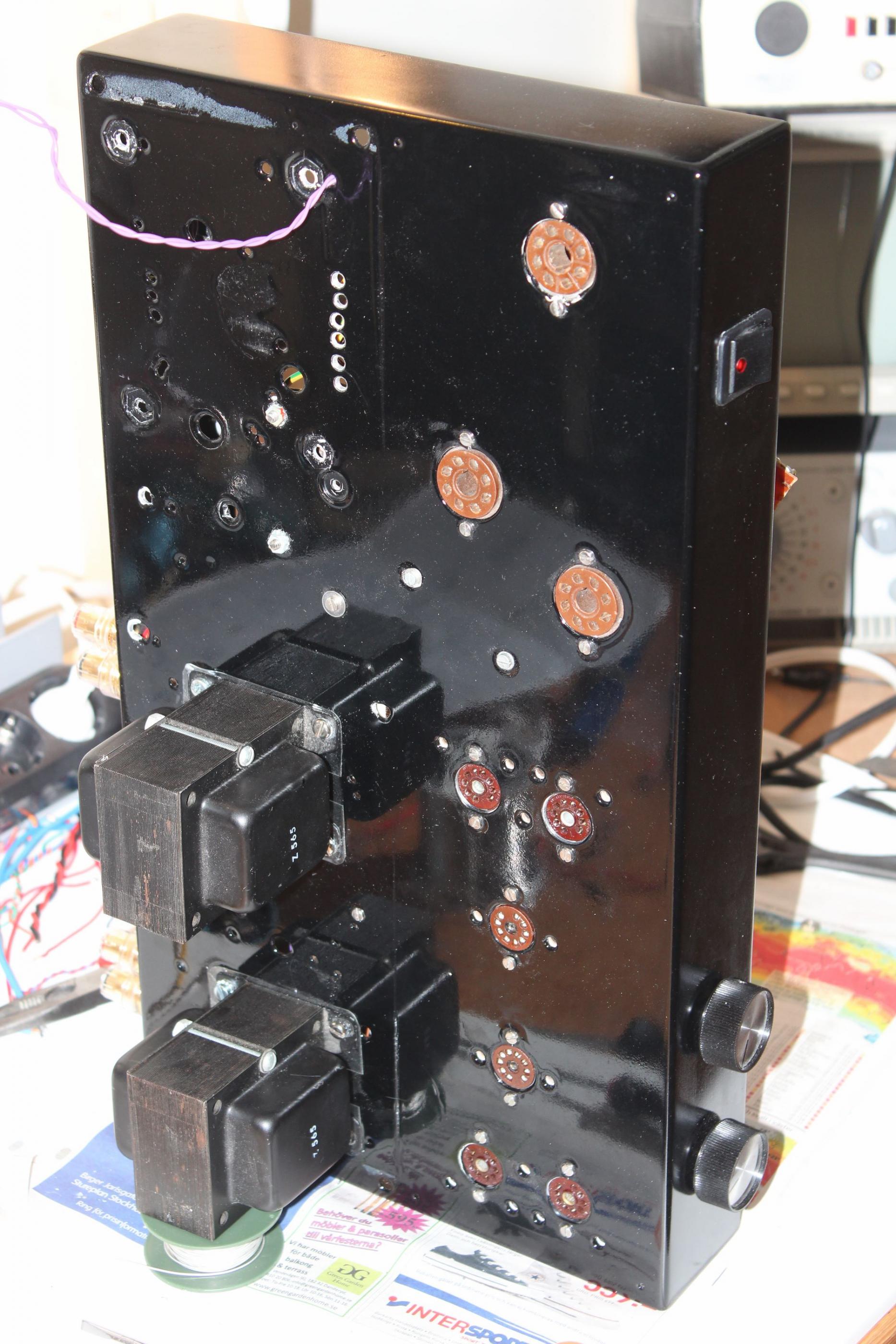

I have been putting isolating clear plastic between the OPTs and chassie, just one screw touches chassie/gnd now. Doing the same with Power Tx now. Using unmagnetic stainless screws and rubber brackets. Is thats ok?
Also freaked out an putted some reds on the splitters cathodes. And splitting Powertubes/OPTs into two filterlines. Oh, whatever... I know. To many things at once. Lets see...

The amp is now stable. I isolated the Power Tx and the OPTs so their gnd connection is now more controlled. I tried with red 3 mm LEDs on the 12AX7 cathodes to be able to choose FB resistor to my taste but they were blinking and there was some strange noices.
Maybe theres to little current for a LED with a 12AX7 running some 360 V B+?
So I went back to cap decoupled kathodes, putted in 470 uF half-crappy 25V regular ones.
PSU-wise I added a filter step and splitted last to the powertubbies. 50uF-33R-4*47uF-dual 150R-dual 220uF crappy Philips 385V.
Soundwise taking FB from 16 ohm instead of 8 ohmtap naturally takes a huge portion of amplification away so I have to go to 2 o'clock to feel the sofa vibrating. Sound is also a microportion duller. I think to excessive B+ filtering is bad boy there. Push-Pull shall balance ripple out instead of filter it in PSU. Gives more attack.
The 12AX7 has now some 360 V B+ which might be a little on the edge but it works so.
