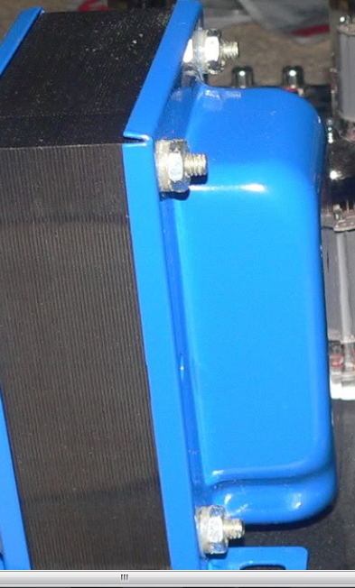

Stajo,
You must not put a single AC cable though a steel chassis...you must take two cables, supply and return through one hole..
The Bolts that go through the transformer must not connect to the laminations (be in contact) you must insulate the mounting bolts from the laminations..try using a flat washer with a fibre washer under the flat washer to insulate it. So think like this..you must not have both ends of the mounting screws connected to metal.
If you look at this picture of an Edcor Tx, under the nuts there are plastic insulator / inserts..the mounting bolts must be insulated at least on one end from the Transformer laminations.
