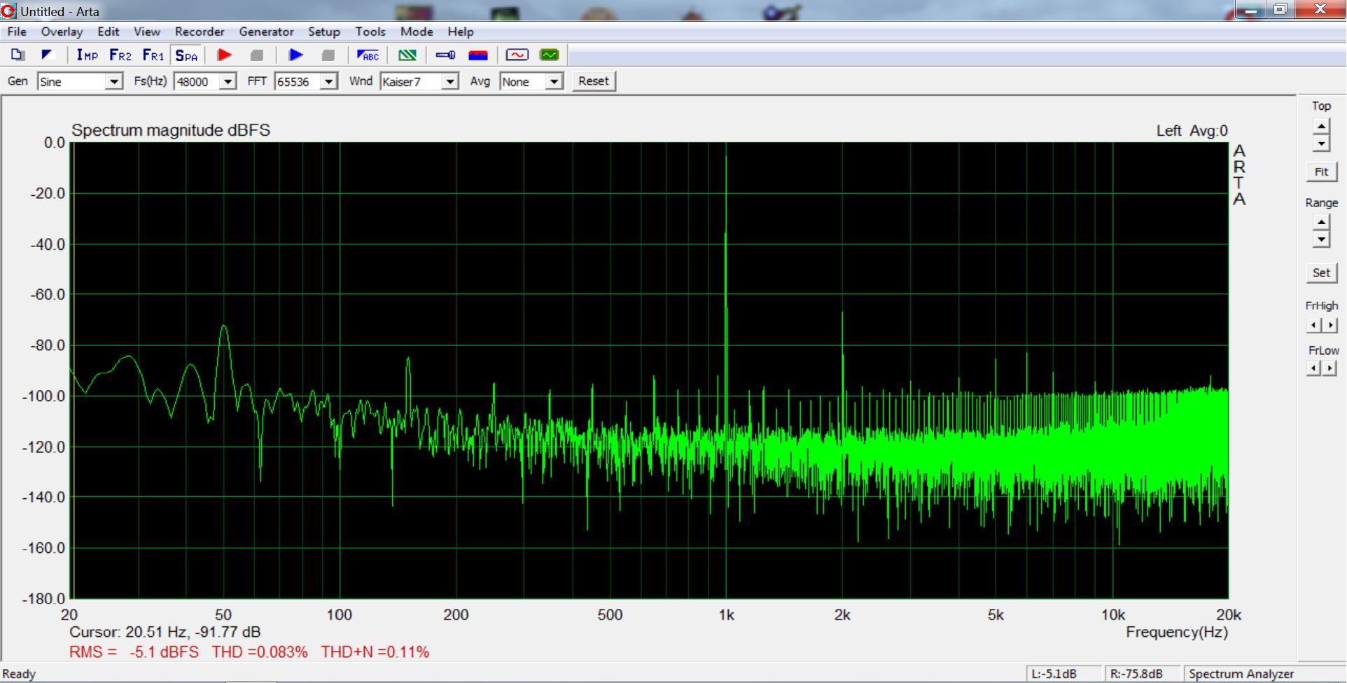

I happen to have TA2021B https://www.google.com/url?sa=t&rct...274432_1.pdf&usg=AOvVaw2pF2_ltig-KKYCIgQa52BS, actually four modules built as close to app notes, bought several years ago for a multi-amp/active XO project yet to implement. With regulated but linear psu I never managed to push them higher then a couple of watts. That is with a 150VA transformer. They are really power hungry. Some day I hope to try a proper SMPS because I think this would be the only sensible approach. Attached is a FFT at low power output. Compared with modern classD, there is a lot of hass but then a few classD graphs I've seen present a noise floor at -100dB, perhaps deliberately shaped? If we mentally draw a line at -100bD in the graph I post, then things get interesting but can speakers and ears draw this line?
