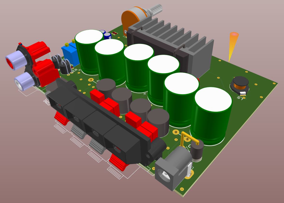

Brilliant little things IMO. I purchased a Leipai Tripath amp, took the TA2020 out and made my own design & PCB which included the option of using a light-speed attenuator for the volume control. Still going strong! I even drive it using a SMPS supply (shock! horror!).

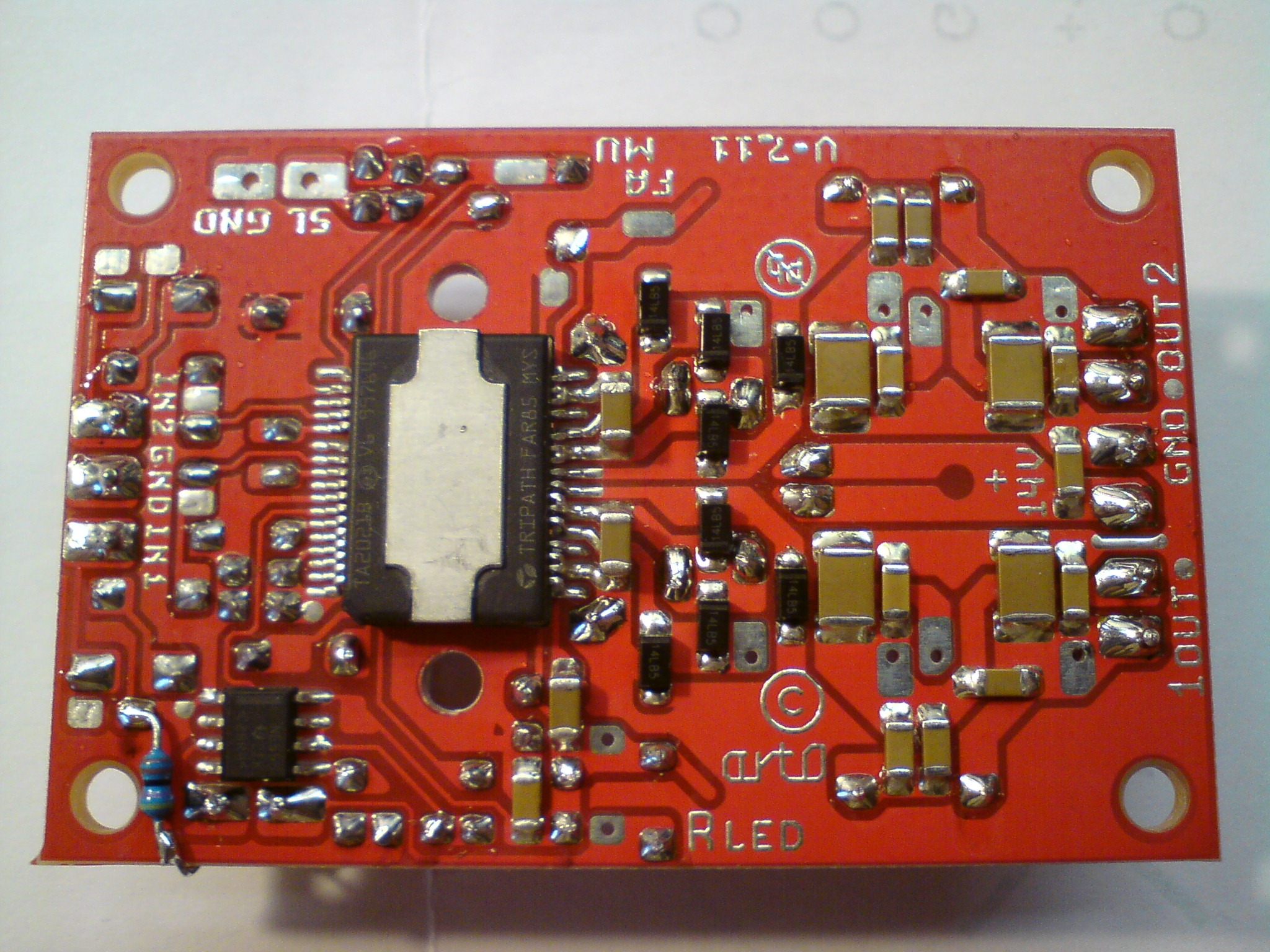

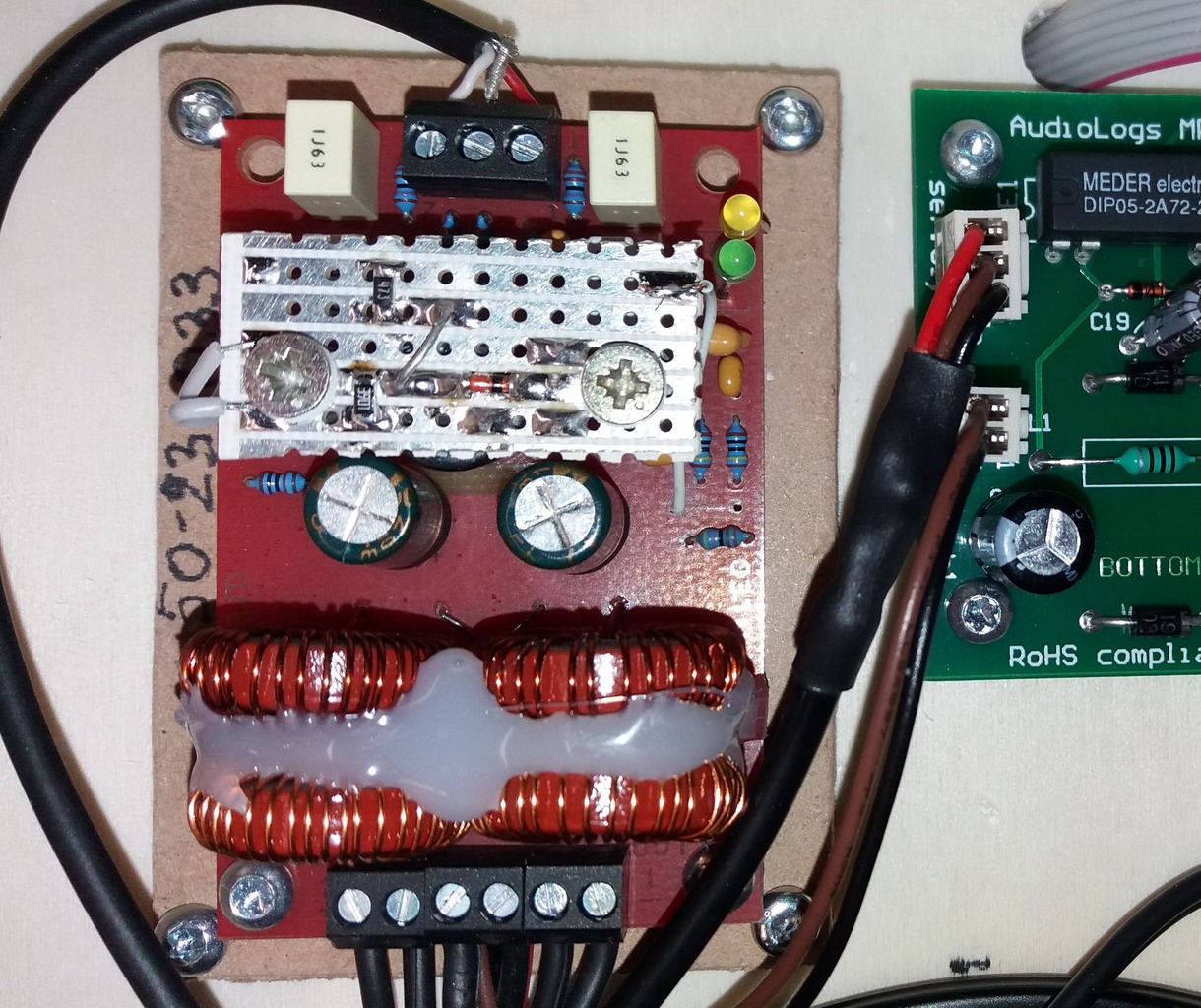

Thank you very much! I agree about the sound. I have four of them for a 4-way active XO project sitting at the back of my mind. The PS you post seems very nice but in my case power demand is huge so I'm considering SMPS. No final decisions yet.
I thought to describe it as "red board" in lack of a better way or a link. Unfortunately, it doesn't seem to be on ebay anymore where I bought mine about ten years ago. Pictures might help. Those big caps are retrofit.

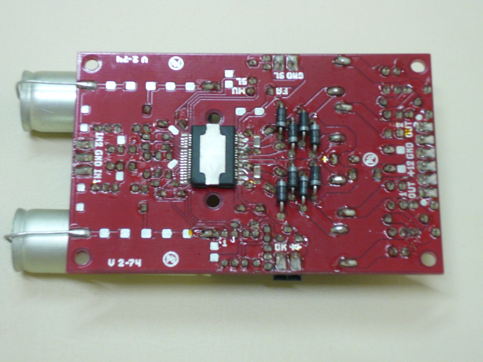

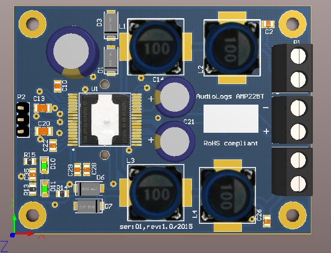

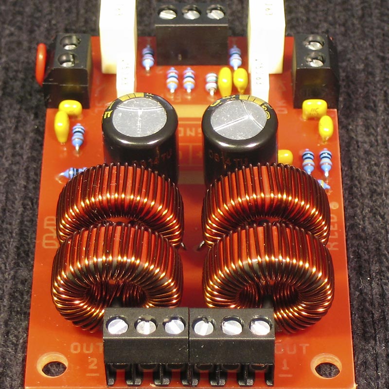

I have to write that I am still impressed with Tripath technology. I still use Tripath chips, more than 15 years and I can't see any alternative at the moment. Although the results of other manufacturers show better results, I am not convinced.
I've already tried Maxim small chips, Infineon, IR and TI, but unfortunately they don't sound as good. I'm still using TA2021B for my products and slowly my supply is running low, I'm getting desperate 😀. I'm sorry that this is exactly what happened, the big guys pushed Tripath out of the market because someone small can't be as good and they can continue to sell inferior products.
I'm currently using the red pcb because it's really ultimate and works great. I wind the coils by hand on a T60-2 core because it has the best results, very little noise. One manufacturer has 10uH has excellent coils that I will use in my design later.
Open source project for DiyAudio forum with TA2021B, AMP225T link:
https://audiologs.com/AMP225T/AMP225T_project.zip
some open source projects if you want to do it yourself:
TA2021B red board
