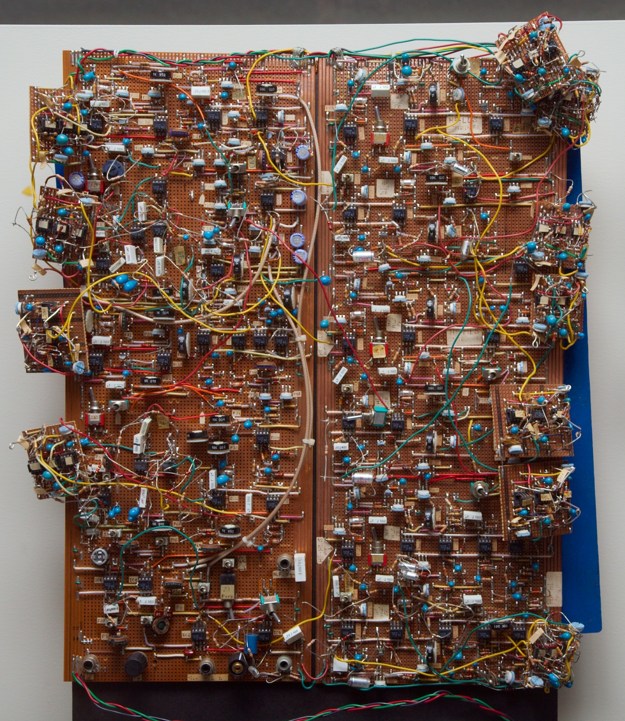

799381d1575344032-supposed-nv_1014_koebel_figure09-jpg
There is a radio guy on Youtube that I saw a while back who shows some of that 'island' technique (which is mainly for prototyping btw) here: YouTube
I thought it to be quite useful for quick and dirty testing or for quickly constructing test rigs. More sturdy than plastic breadboards anyhow.

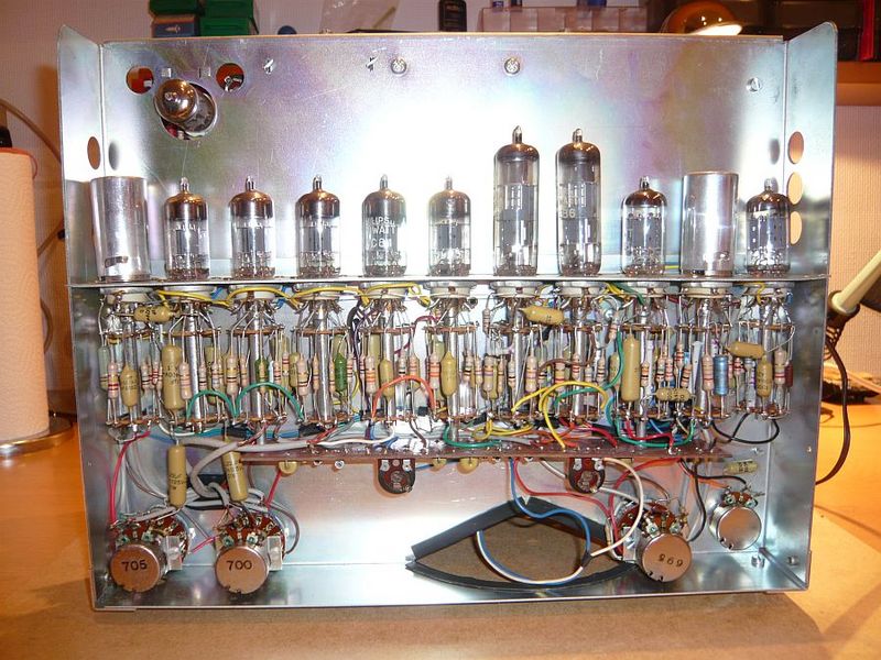

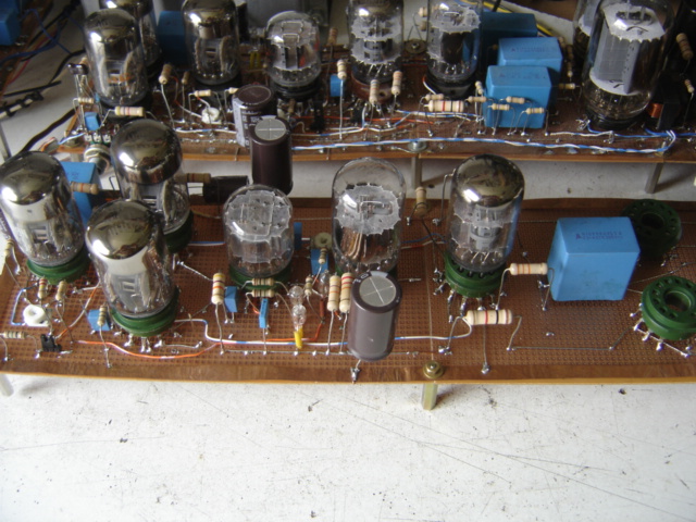

Indeed, that "old school" point-to-point wiring was common for the old tube stuff.
BUT...... you have to understand that even though it looks messy, it was solidly constructed with tag strips and anchors to the chassis, AND the layout was thoughtfully laid out for proper reliable operation.
Wires leads were strategicly "dressed" a certain way, components were also dressed for hum reduction, etc.
It wasn't done by a child as some kind of slop mess.

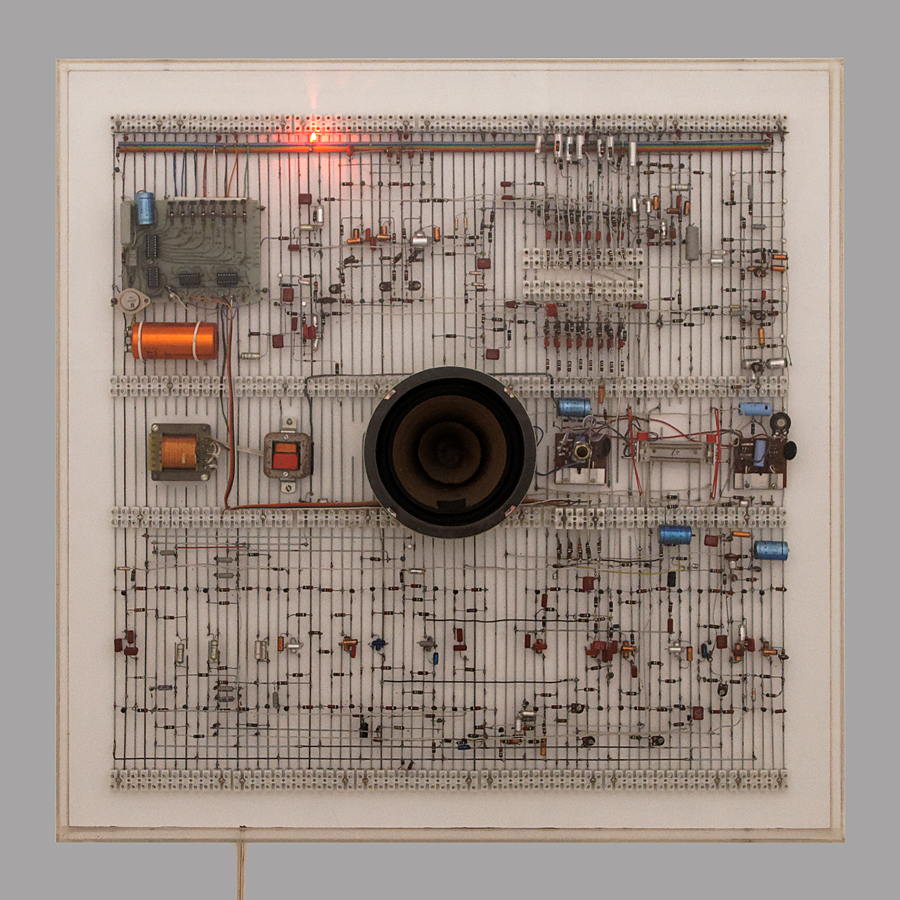

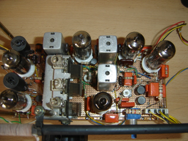

This looks so weird I'm asking myself if this is actually supposed to work?...….. It seems this guy has a better 3-D imagination than soldering-skills.
I see no evidence of poor soldering skills. Yes, it does work as the builder presented teas data on the web page.

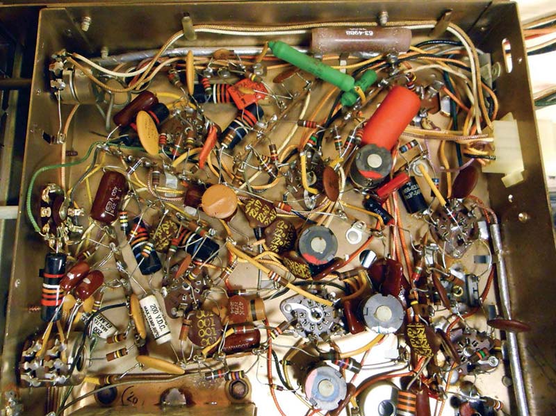

I started out building stuff using tubes, since that was all that was available around 1960. I had zero soldering skills, since I had no soldering iron, or soldering gun.
My first working DIY amp consisted of a couple octal tube sockets screwed to a pine board. In some cases the components that were soldered to the sockets in the TV set that they were cut out of, were left in place and reused, or the wire stub was used for connection. All interconnections were made by wrapping the wires around a brass thumbtack which was pounded into the pine board. It was a guitar amp somewhat similar to an early 1950's vintage Fender Champ, and my parents and neighbors can attest to the fact that it did work.
That thing's nothing more than some slop mess. And anyone constructing such crap shouldn't have access to a soldering iron.....

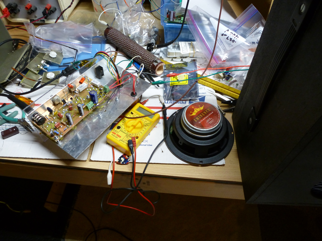

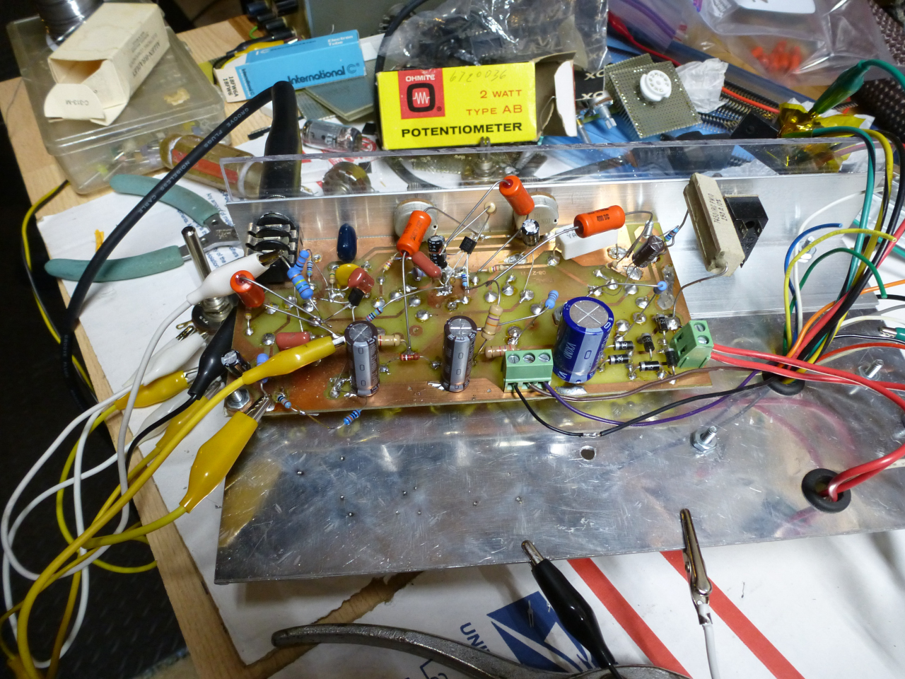

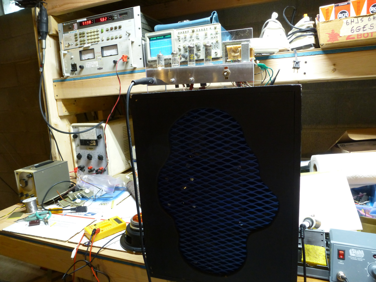

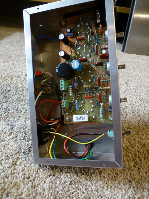

I made a guitar amp in high school. The preamp was a piece of un-etched PC board that served as the front panel with the pots and switches sticking through it. All the solid state components were soldered to the back using this technique called "sky-wiring." The power amp was a SWTPC Lil Tiger amp board screwed to the inside of the cabinet which also contained a 15 inch speaker liberated from a Hammond organ cabinet.
Sky-wiring is the technique seen in the picture. Dead-bugging usually involved gluing a DIP IC chip (resembling a dead roach) to the PCB material and sky-wiring the components to its legs.
Often these were indeed a first cut experiment just to see if there is a reason to believe that a more serious perf board or PCB version is worth while.
Other times, I may take something that could serve as the basis for a new project, and "sky wire" parts all over it to prove out a concept.

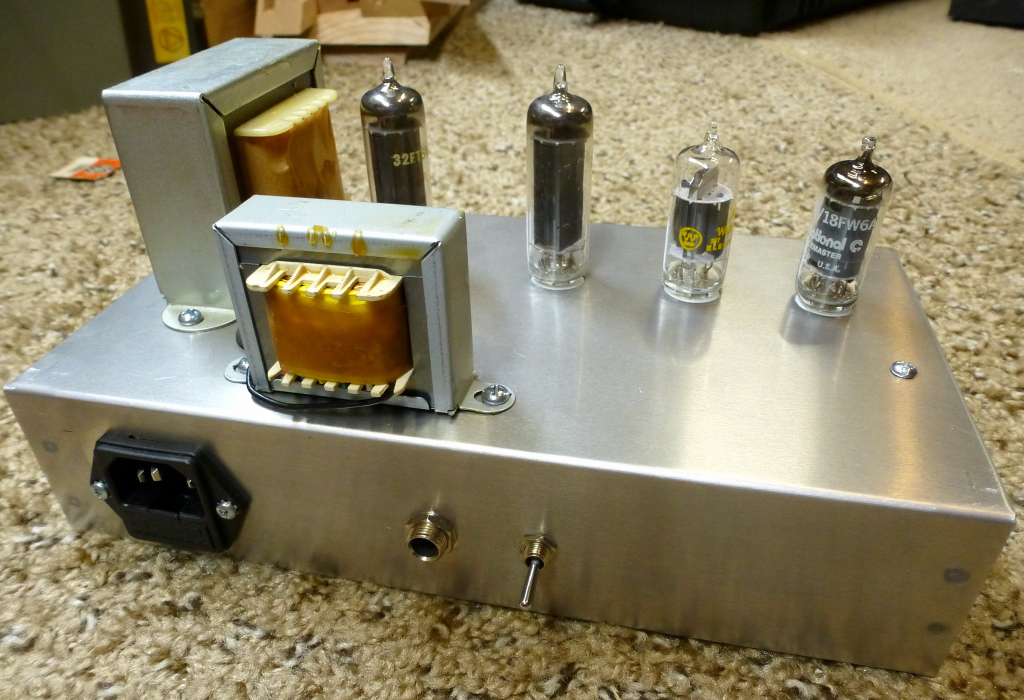

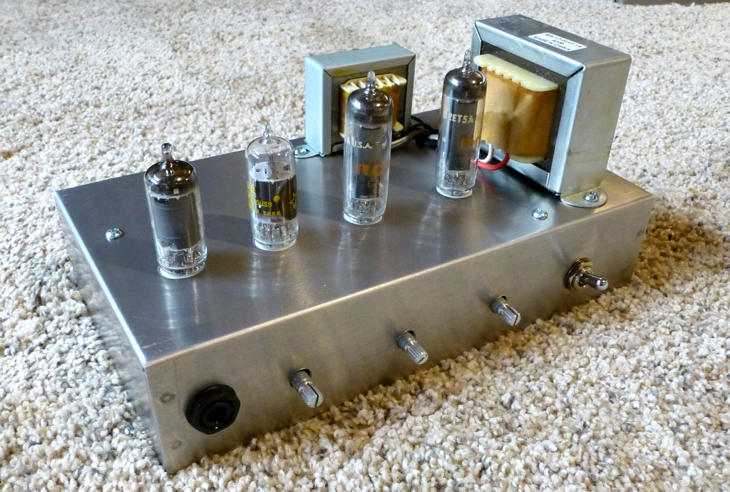

I built a little 4 tube guitar amp for a contest several years back. It worked, but didn't "ROCK." I got it out of the dead projects box after a few years, and proceeded to apply this technique building a "furball" of parts on top of the existing PC board. (picture)
At one point there were clip leads running off to pots for tuning in the operating point of the input tube. Testing was performed with test equipment....and a guitar and several speakers.
When I was finally happy with the results, I made a new PCB and a better chassis. I still use this amp today. The new version is sitting on top of the cabinet behind the guitar neck. The old "furball" is sitting upside down on top of the RF spectrum analyzer to the right of my ear.
So, this technique worked, and provided the one-off test bed that eventually led to a completed amp project. The original "sky-wired" chassis still exists, because I am thinking about revisiting this design again. Yes, it was a "slop mess," but it provided an opportunity to learn.....and that's what were are supposed to be doing here......working projects are just the side benefit.
Old projects never die, they go into the box of dead projects to be used for parts, or as the basis for something new......that box is pretty big.
