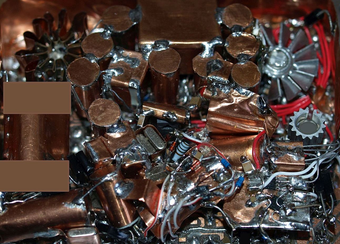

This is a prototype. The builder had some knowledge what he was doing. Dolby SR - Wikipedia

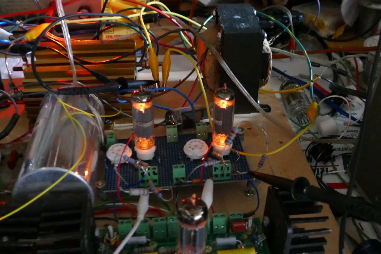

Here is the progression of experiments leading up to what may become another Tubelab board. First off several stupid ideas that I have been playing with for 5 or 6 years came together in the mind of the computer....LTspice. The simulator is pretty good at telling you when an idea WILL NOT work. Determining success and those little details like what it sounds like require a prototype.
Here several different ideas from the sim get thrown at the workbench in sky-wire style.

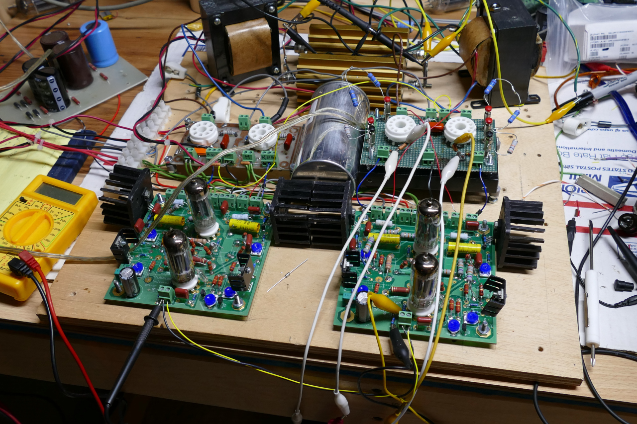

Two different output stages were constructed on perf board. The blue one uses 7 or 9 pin tubes, and can be seen extracting 20+ watts from some 50C5 radio tubes. The green one uses 12 pin compactrons and was tested with 6GF5's because they are $1 each. Both were developed with known good Tubelab Universal Driver boards.

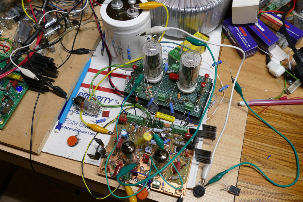

Much like the guitar amp in my previous post, the new purpose designed driver stage wan built on top of a failed test board. Note that about half the parts have been ripped out and some new ones sky wired on top.

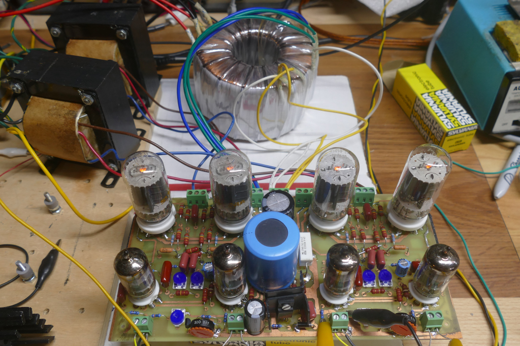

The 6GF5 output stage, and the new driver stage were put together on a one off PC board to prove out the design. It will make 70+ WPC with a regulated 500 volt supply, and 50 WPC with a cheap Antek toroid powering it.

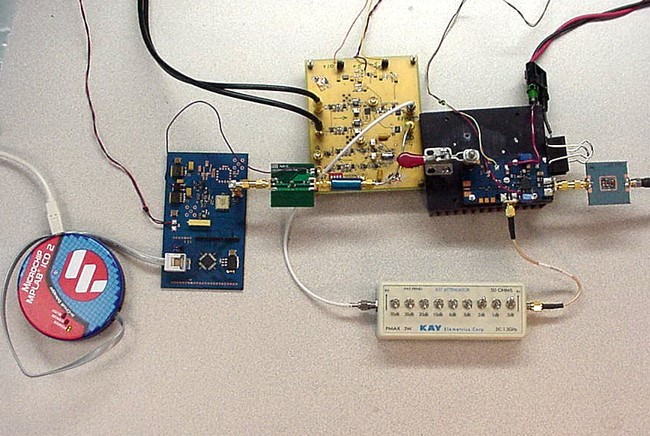

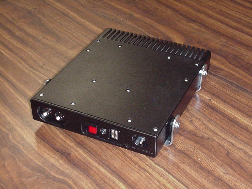

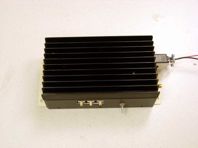

Here is the same progression for a one off prototype I did at Motorola. We had a PCB shop in house, but still some of the individual blocks were reused from other similar projects. This device was just made for a Proof Of Concept. This is where pictures, a words and some test data are used to get a project funded. The "chassis" was a discarded RF power amp that I stripped of it's guts, using only the cabinet and heat sink. (3 pictures)

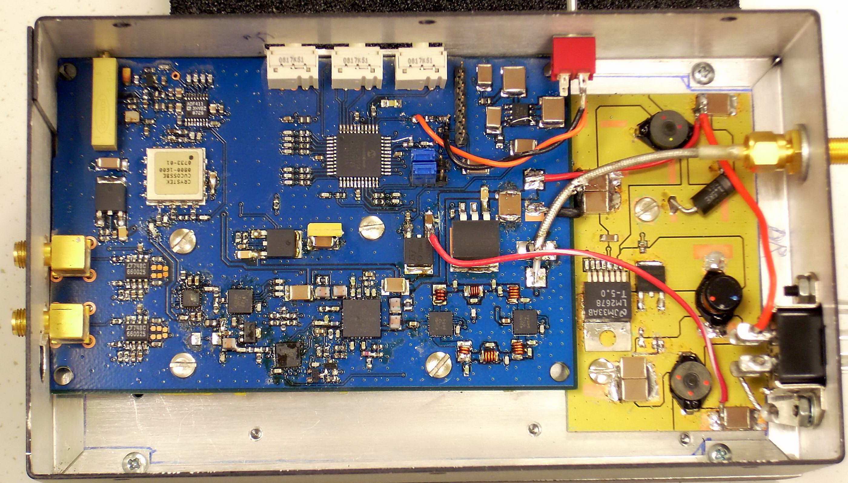

Here is a picture of a one off prototype. I spent most of a year designing the transmitter, laying out it's PCB, drawing up the details for the chassis, building the only prototype, and taking all the test data. There was a 90 page report that was done detailing all of the progress with data and pictures. I wrote a good chunk of that too......the life of an engineer in the research department of a big company in todays corporate world.
Later on as the company was downsizing and eliminating jobs, our department was absorbed into a larger group, that would eventually be spun off as Freescale, now part of NXP or whoever, today. We were told to generate a "presentation" to justify our jobs to the new bosses. A great panic came over the land. All real work stopped. My friends were in chaos.....
I was not disturbed, and nothing to deal with this issue. They asked.....what's up?, and I replied that I had it covered...…
When "the day" came each one of us was asked to go into a room and give a 10 minute presentation as to why "we" should keep you. There were so many slick slide shows that I couldn't remember who said what. When my turn came, I simply tossed this 12 pound prototype radio out on the table. The big THUD got everyone's attention. I stated that I designed the transmitter, laid out the board, built the prototype, tested it all (TX, RX and data recovery) and wrote the report.....any questions? My unique approach was remembered, and I lived on in that world for 5 more years.

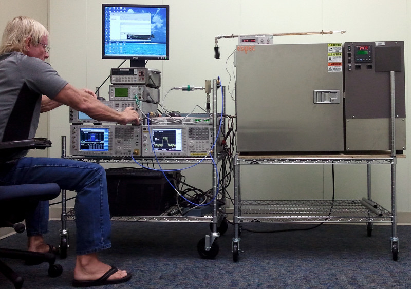

Here the full resources of Motorola were used appropriately. There were dozens of test boards made tested and remade during the initial design cycle. We had an in house PCB shop. I could get a simple 2 layer board in 4 hours. An 4 or more layer board took 1 to 2 days, and a full on 3-4-3 HDI board would take 3 days to a week......want something like 2 layers of Rogers Duroid on 4 layers of FR4, for a 6 layer board....no problem.
We had a full machine shop. I made a simple drawing, and provided the details of each PCB, the internal heat spreaders.....then a mechanical engineer would generate the cad files to mill this chassis out of a single chunk of aluminum. We had a pick and place line to populate SMD boards, Again, someone would take my board files and generate the necessary files for the machines to build our boards. Even though this was a one off proto, several boards were made so that statistical data on the individual circuits could be generated.....all the transmitters were tested in that single chassis for temperature performance.
The Dumm Blonde One testing an LTE transmitter.

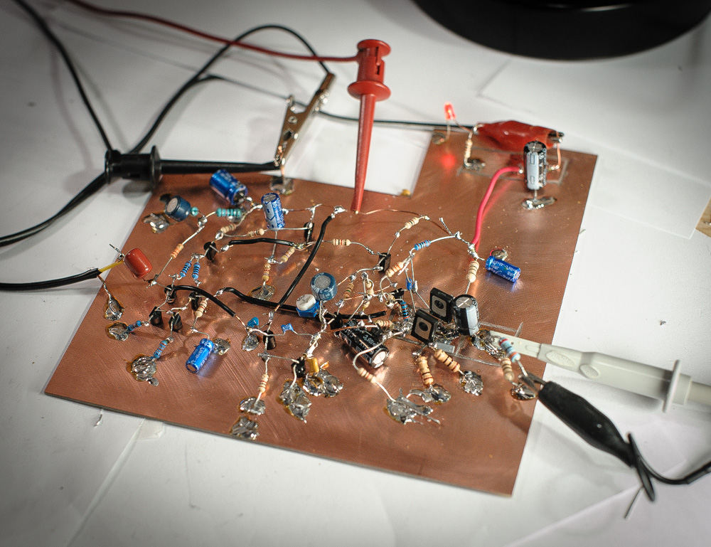

That thing's nothing more than some slop mess.
And anyone constructing such crap shouldn't have access to a soldering iron.
I don't agree with that at all. How do you learn if you don't build? If you don't build, how do you learn to build?
Often, the builder will cut some square or circular pads from pc stock, and glue those down to the copper foil to make non ground connection points. That addresses some of the concerns about non reliability from parts breaking off ( a valid concern ), and cleans up the appearance. This is an excellent construction technique of long standing.
This was probably a test board on the way to something else.
A similar technique is called manhattan construction, here is a primer:
http://qrpme.com/docs/K7QO Manhattan.pdf

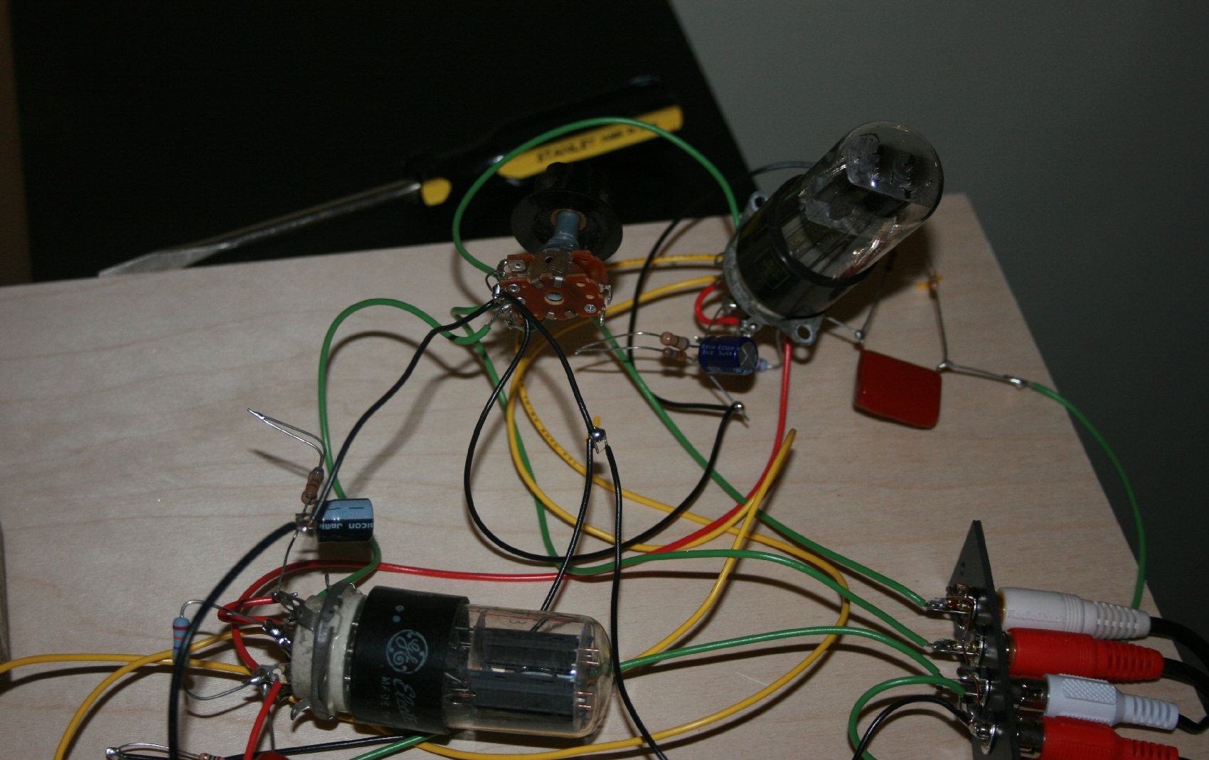

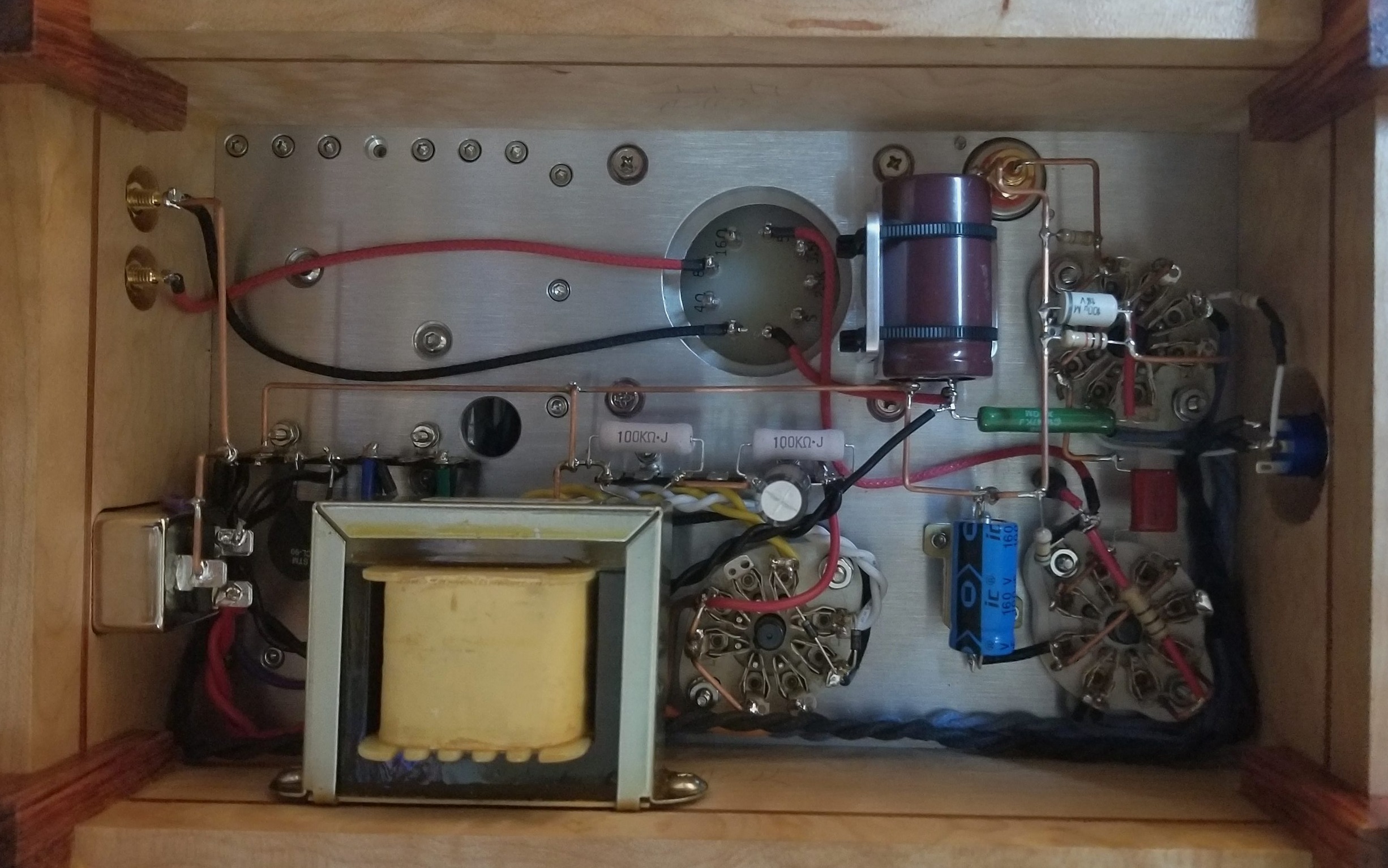

"Dead bug" is exactly where I started. That's the method I used in the first picture below, which is some sort of 6SN7 stereo preamp I cobbled together about two decades ago. Oddly enough it was tolerably quiet despite the lack of a chassis. Heck, none of it was even attached to the board; the whole web o' death was just lying there making music. Now that I think of it, it looks more like roadkill than dead bugs (yes, this is dangerous; however there is an isolated power supply to the left of the frame).
The second picture shows my progress as I wised up and began combining machine work and crapentry to create real chassis (chasseez...cheeses... whatever). This is one of a pair of monoblocks from a Vinylsavor design I did as a point-to-point build with 1920's-style ground buses. They're dead silent. Btw, monoblocks are more than twice the work - particularly so if one chooses to build them as mirror images.

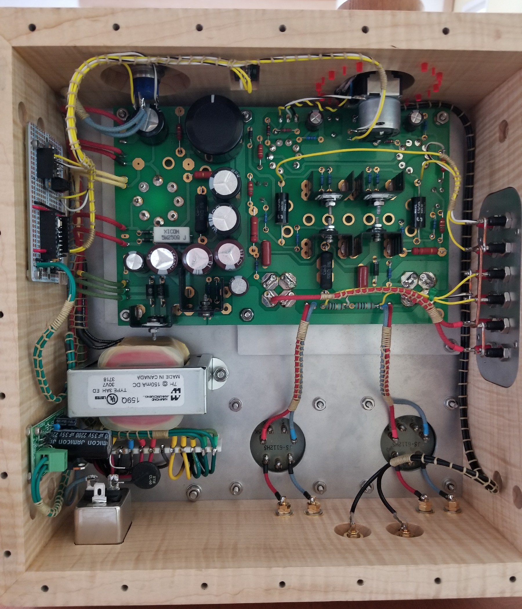

The last image is the underside of a Tubelab SEII completed about six months ago. I'd never previously built a tube amp from a PC board, and I'll admit this threw me for a loop. I had the bare board up and running in four hours; another four hours and I had it on a suitable breadboard for further testing. But... designing and machining the chassis, incorporating the remote volume control and lacing the cables took another six weeks.
