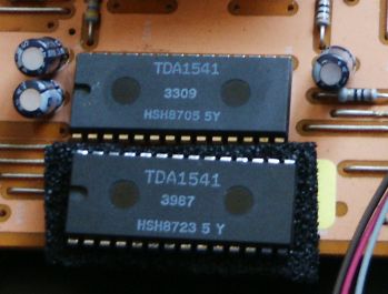

TDA1541A ordered from Reichelt
I ordered a TDA1541A from www.reichelt.de for replacement of TDA1541 in my Philips CD650. After reading this thread I see that I obviously received the non A version, am I right?

Yes this is the old one.
Did you want to upgrade ?
My Advice:
Not use 1541A with SAA7220A.
Not use 1541 with non os.
Best:
SAA7220A + 1541 os.
1541A non os.

I have a TDA1541 R1, which I was told by a Philips distributor is the same as a TDA1541A. I think I was hoodwinked.

Just phone them and point the mistake out: I did so when I received a wrong chip (a TDA1541 instead of a 1541A) for the group order, they sent me a good 1541A without exitations.

Thanks for your info. I've contacted Reichelt and they will send me the A version.
