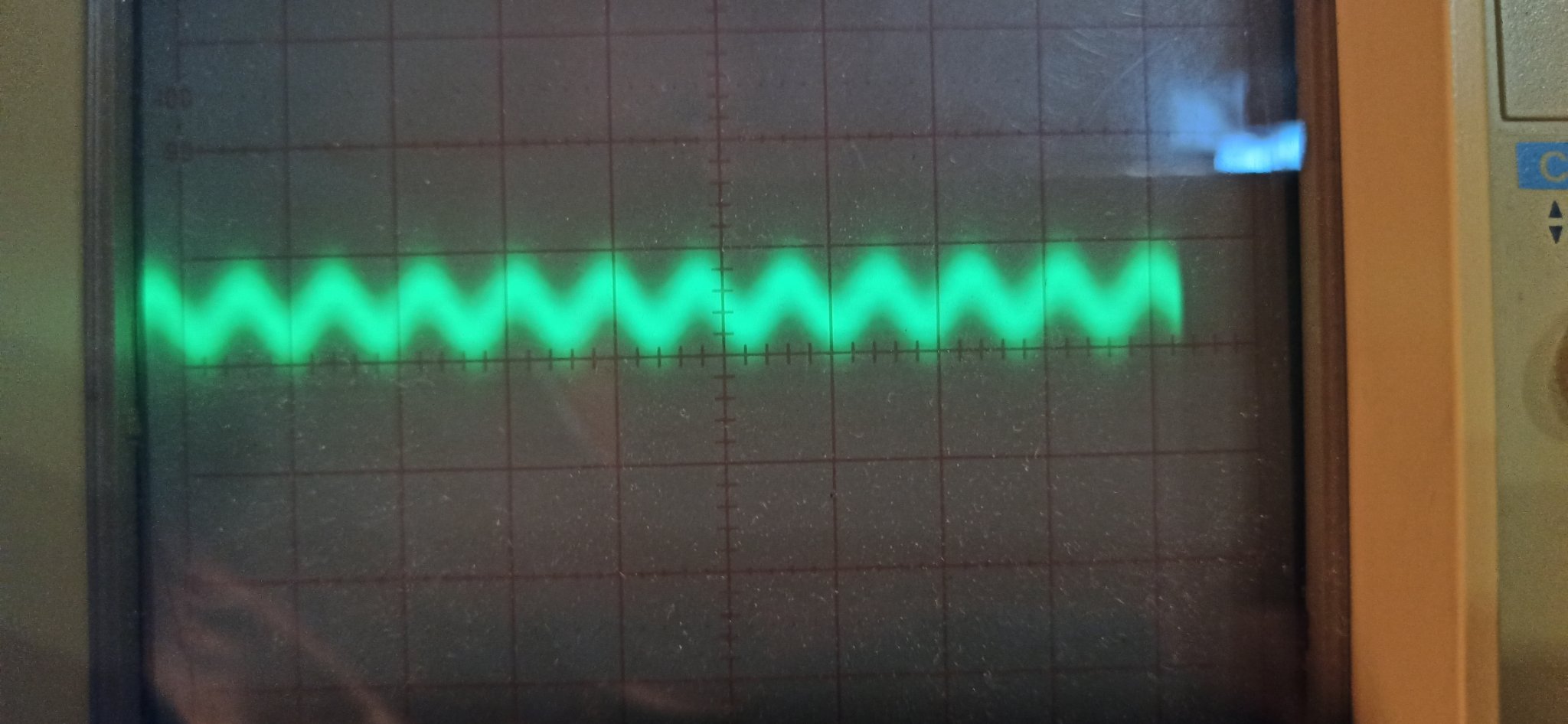

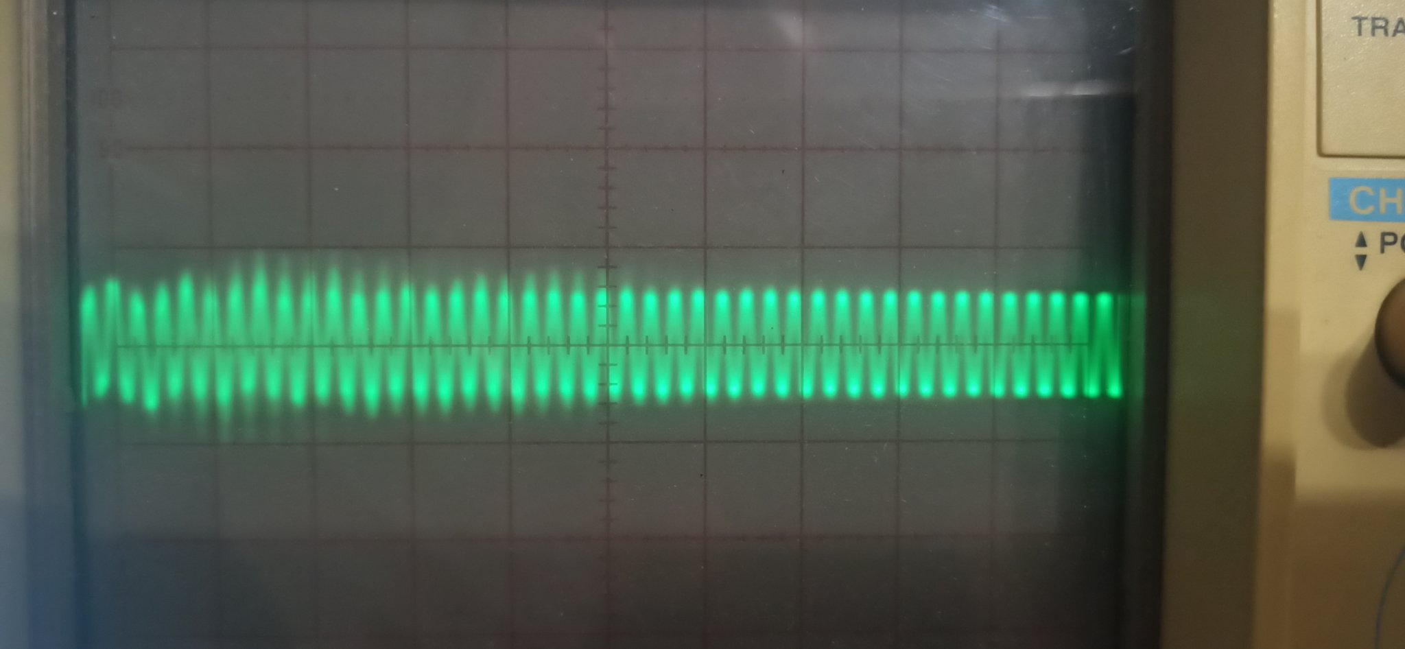

Is this a case of noise or oscillation? How critical is the impact of this signal anomaly

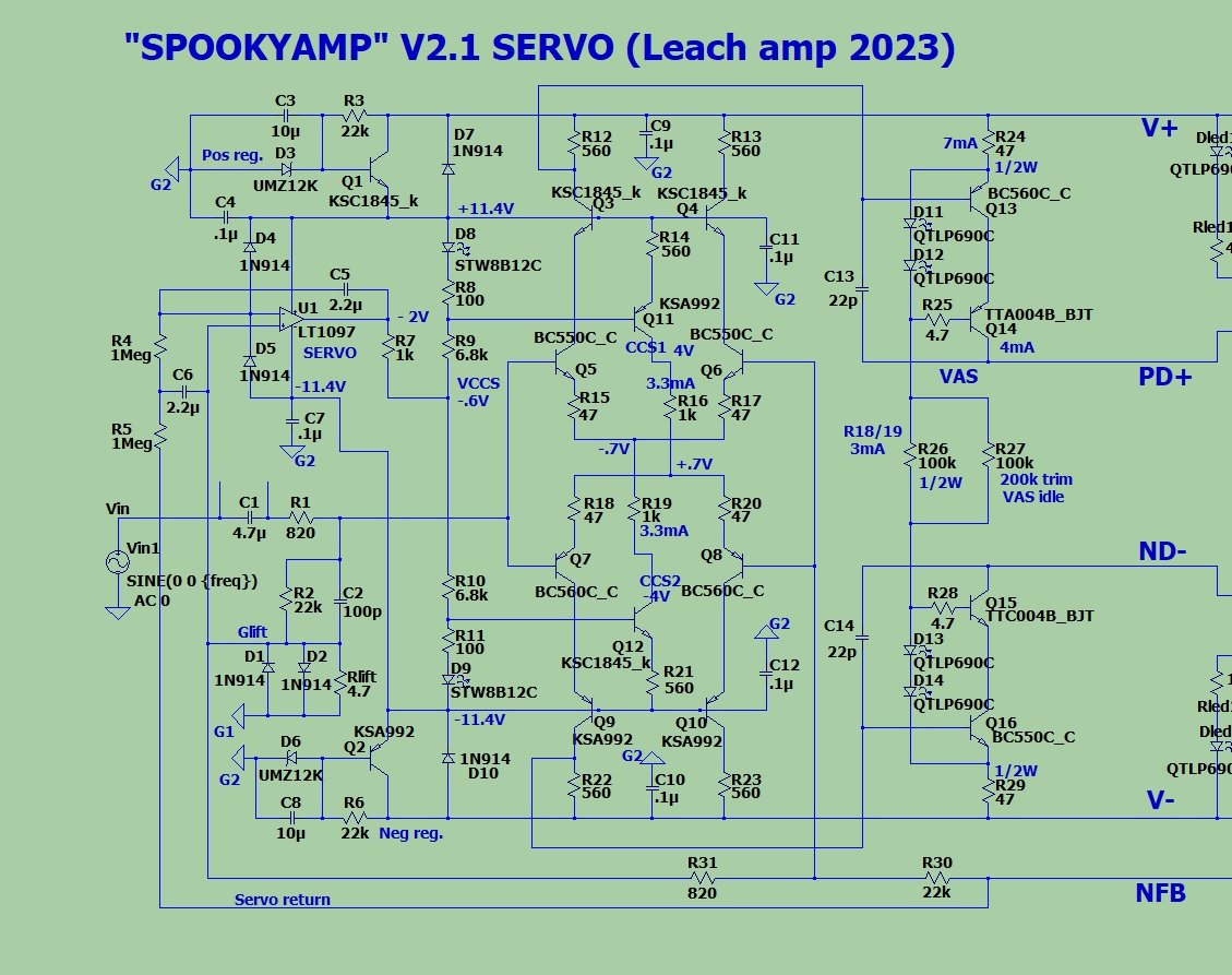

You do need a series resistor in the base of the driver plus the cap.
1. I don't understand what R301 and R401 are doing - these look like 68 Ohms? To be honest I've never used this and I haven't seen any other EF3 designs with these resistors.
2. The driver transistor emitter tie resistor R302 looks like 7.5 Ohms which means the driver emitter currents are 160 mA (c.f. 1.2V/7.5 ohms) which is extraordinarily high. In most EF3 designs, these are 33 to 68 Ohms and will still keep the driver in class A down to 2 Ohms at the full rail-to-rail output swing - you can always check this in LTspice as well.
3. For the pre-driver emitter tie resistor R314, you can safely set this at 120 to 150 Ohms - 750 Ohms is on the high side.
4. In some cases, a 10-33 ohm vase stopper in the pre-driver collector can also help.
5. Decoupling to the collectors of Q301 and Q402 looks good.
Meanwhile, I found a source explaining why there was a BE resistor on the driver transistor. Adcom used this resistor in its older designs where there was a high supply voltage. This was significant due to the older transistors.
