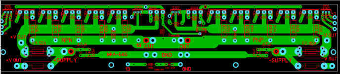

This is what my output board looks like. I wanted a simple design. Perhaps the NPN and PNP sections need to be better separated. I will redesign it into a simple EF3 layout.I should think with your nice compact layout for the output stage, that you might actually get away with less compensation. 🤔 The way the 565 (and many amps) is spread out like that is not a good thing. Big loops.

I guess you are using a single-sided board, so having the supply rails and output rail adjacent to each other means you have minimized the overall loop areas and thus inductance which is good. If you use a double-sided board, you can lay them on top of each other for even lower inductance and loop area. I see you have brought your supply rails in on opposite sides of the board. I would suggest you bring the supply rails and associated 0V track next to each other in the middle of the board and run each rail alongside a thick ground track. That way you can provide a lot of bulk decoupling (220uF to 1000uF) plus HF decoupling (1uF X7R). Keep the supply rails close to the output rail as you have done as the supply rails and the output rail form a large high-power radiating loop that has to be minimized. The Zobel and output coil + damper resistor should be on this board as well in the middle.

Here is a snapshot of a board for some inspiration (its a double sided board)

It’s interesting that the wiring in the picture works well in the original units. Perhaps because of the slower transistors.. In the middle of the picture, the brown and blue wires connect the pre-drivers to the VAS. In my amplifier, the driver wires are sensitive if they come close to other wires. I am using a single-sided PCB. Adcom didn’t use a coil on the output, not even in several older designs.Unfortunately, that photograph of the assembled monobloc shows a suboptimal layout for all sorts of reasons and especially so for an EF3. I really don't know why they did that. The wiring inductances are going to be significant due to the large loop areas. With any output stage, incl. an EF2, you have to keep the OPS compact, the associated power, ground and output traces correctly grouped, and the tracks overlaid to keep the loop areas and associated inductances small. In the case of the Zobel network (absolutely mandatory with an EF3 using modern high fT devices), this has to be placed right at the output of the amp as close to the output devices as possible - which means within an inch. On the monobloc picture, it does not look like that is possible. I would question the lack of an output inductor on a feedback amp - that's quite a risky proposition IMV.

You should be able to twist the V+, V- plus the driver signals and 0V together from the driver board to the output stage - again, it is all about keeping loop areas small and thus minimizing susceptibility to radiated signals (from the high current OPS) and mains noise pickup from the PSU and transformer.

Interesting. The output is currently a classic EF3. I removed the driver base resistors. There was oscillation, but it changed as I moved the output board. I noticed that moving the negative driver wire affected the oscillation. I replaced the wire, and now there is no oscillation. So far, I have used 4 types of wires to connect the VAS to the pre-driver base. The problem occurred with all of them. This is the best and simplest solution so far.
I was wrong. The solution is not good. I tried the other channel. It has the same layout, but the 20 MHz oscillation is present. I replaced the pre-drivers with MJE15032/15033 transistors. This eliminated the oscillation, but I see more noise. I will put the C4793/A1837 transistors back. I will use driver base resistors and capacitors.
