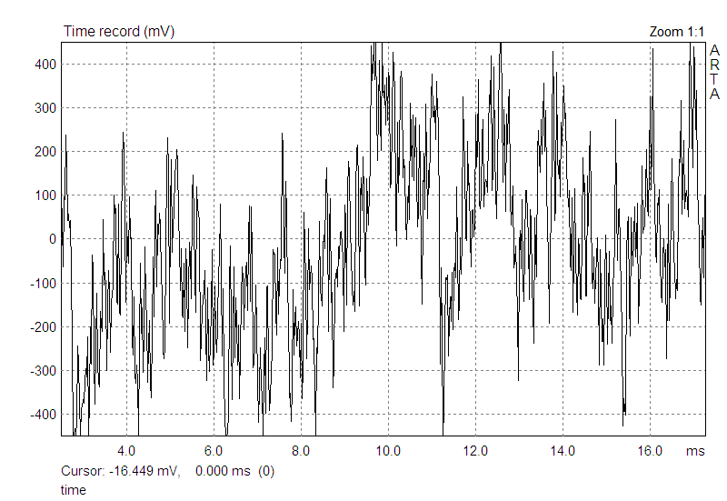

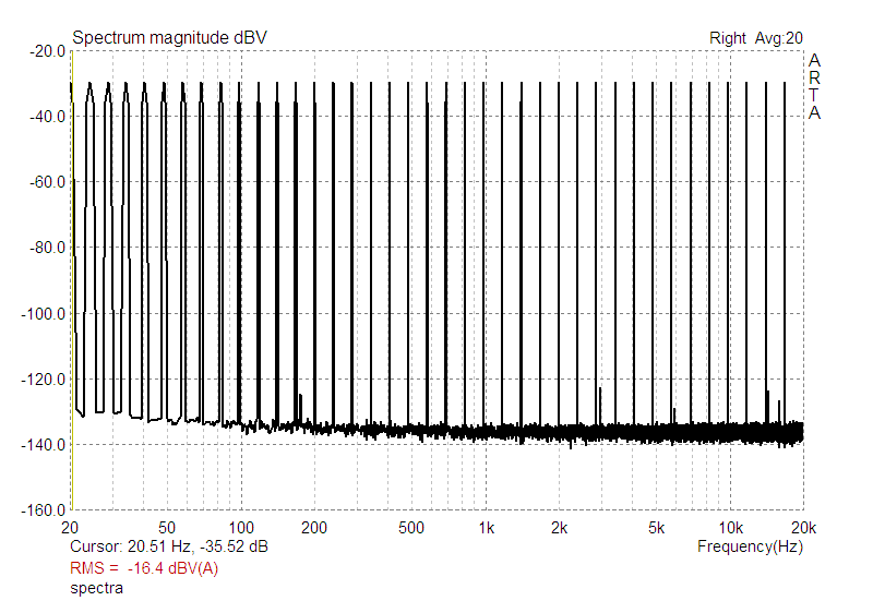

Is it enough? (the same signal, spectra and time record).

Thirty tones stimulus, spectra and time domain, the same signal. If some "commodulation" occurs, it will be visible as new components in spectra (you can see some such artefacts bellow -120dB) at component output. Very easy to measure.
I believe you are missing what CMR is about - it is a psychoacoustic phenomena (not imagined or how someone feels) that results when a signal at a different frequency AMPLITUDE modulates in coherence with the masking signal.
AND, NO CMR will not show on an FFT - it's somewhat due to the psycho-physics of the auditory mechanism & also due to psychoacoustics.
