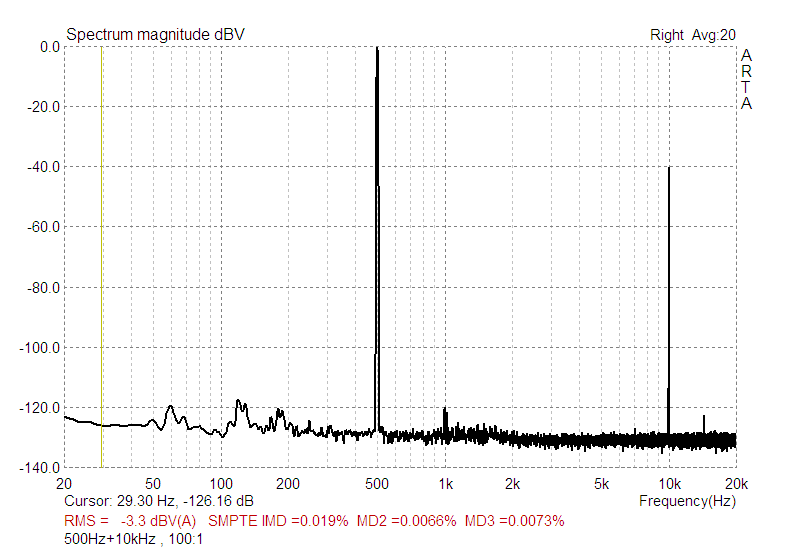

Something like this? -40dB 10kHz "floating" on top of 0dB 500Hz signal. Nothing special to observe (hear) or measure.. CCIF distortion.And another… how about a measure of DDR? Something like the FR of a device 40 dB down (in the presence of a 0 dB signal) would be a good start on that. But also a measure as to how much tiny information is lost by a DUT. Certainly something that can be heard — the kind of thing that makes a great product instaed of just a good one, exactly what the kinds of tests we are trying to sort here.
No.
More like -40 db 500 Hz under 0 dB 500 Hz.
But a single sinewave is going to be misleading.
dave
dave
You can generate the arbitrary signal what you want, two tones, multitone, square + sinus (s) .. But nothing special "tiny information" to find ..
And -40 dB / 500 Hz below 0 dB / 500 Hz is nonsense (two signals with the same frequency). Simple addition or subtraction, depending on the relative phase.
Masking.. Subtle signal with frequency very near to strong signal. It will create low level (-40dB) "beat" with 1Hz frequency . Impossible to hear due to masking.
