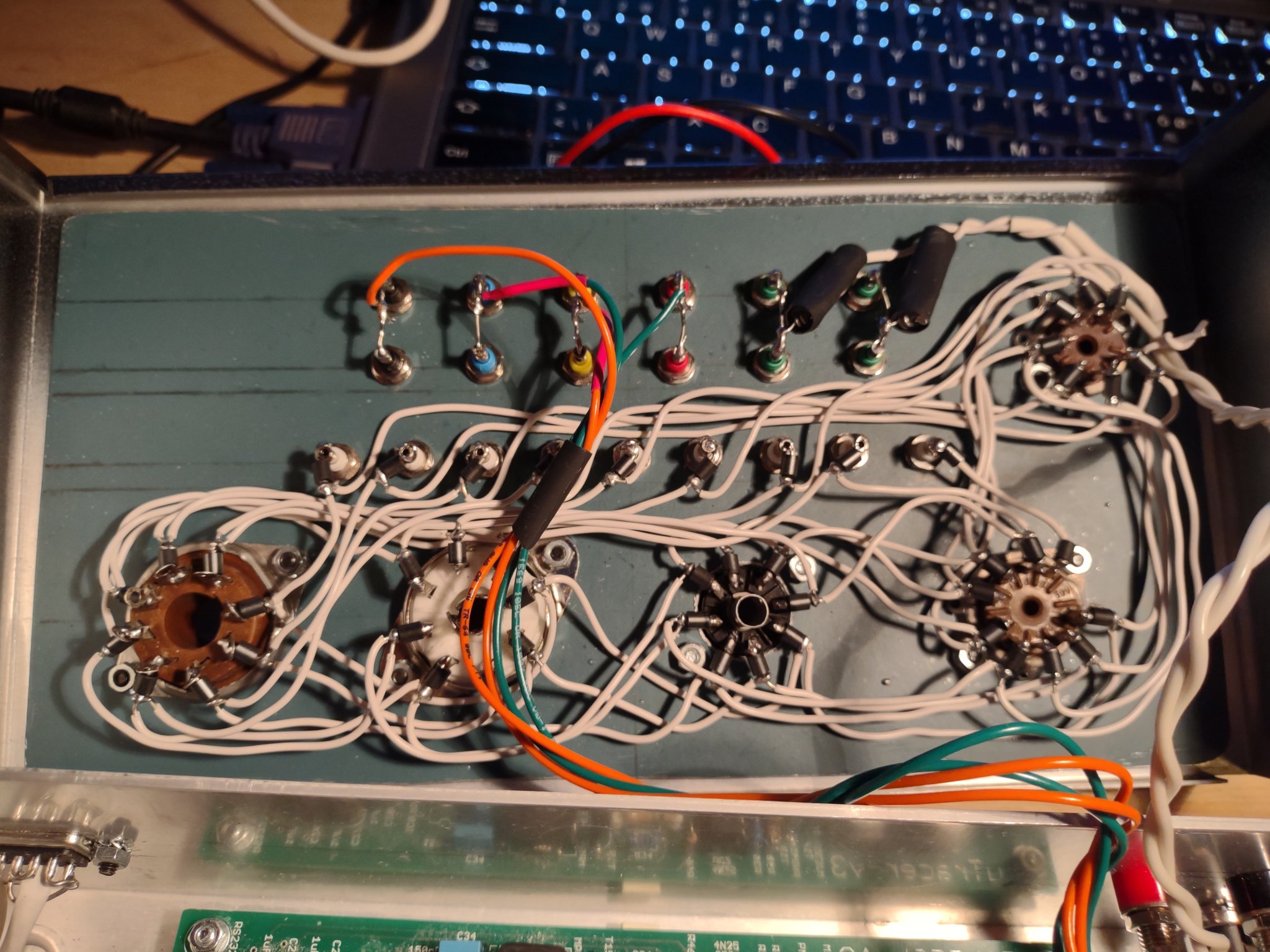

One of the nice touches of the utracer is that screen and plate supplies are identical, so when testing a double triode both halves can be done simultaneously, and plotted together.

OldHector, good points. The uTracer does not have the relay array, so you see the identical screen and plate supplies as a positive. With the relay array, you can always put both anodes on B+.

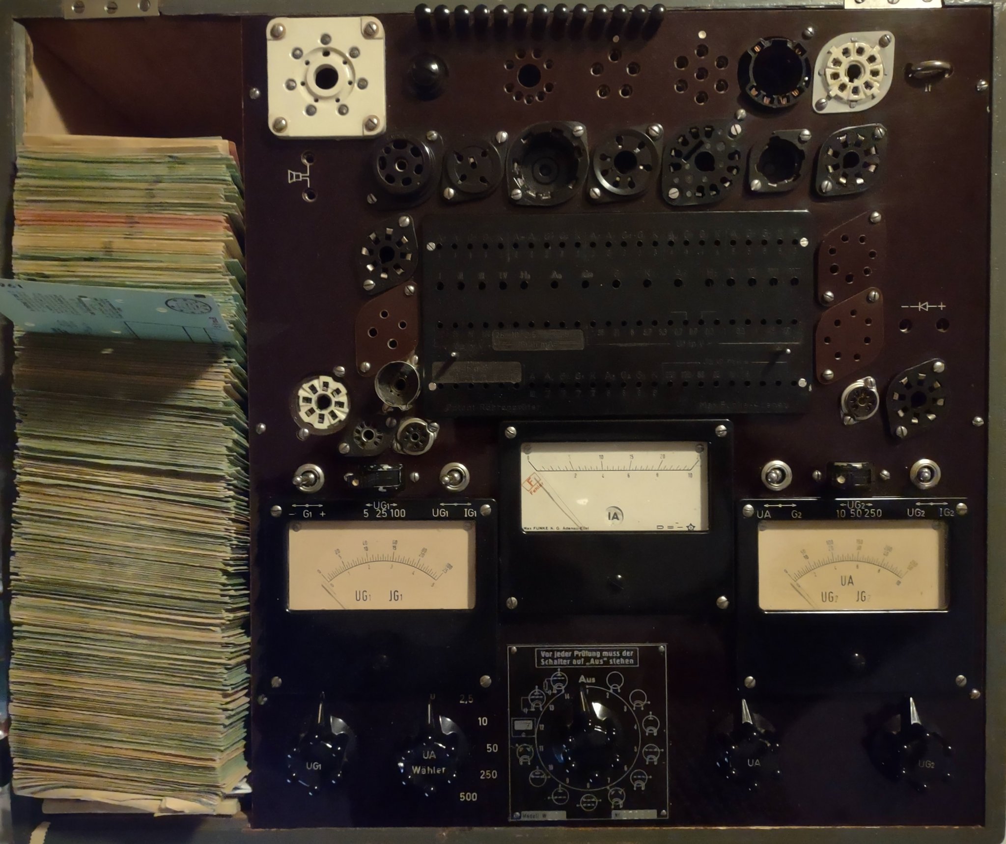

I haven't touched any of my tubetesters (L3-3, Funke, Hartmann&Braun) since I built an eTracer. The Hartmann&Braun was developed for bulk testing and has the niece feature of an extra piece to heat several tubes to stabilise emission before testing.

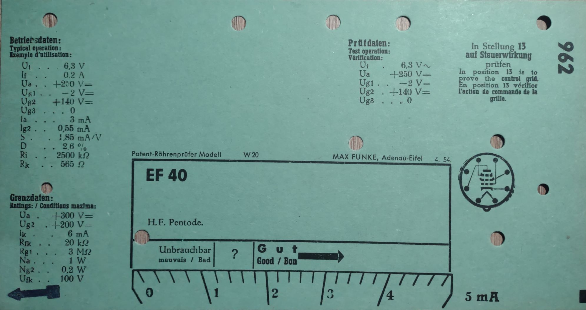

I acquired a Funke W.20, and that has punchcards which are no trouble to use to set up different tubes. Select the card for the tube, push plugs through the holes, and the then it is just to turn the knob through about 8 positions, and all the possible short cominations are tested, and by the time you get to the last setting the tube is heated and the characteristics can be recorded; the characteristics are listed on the card. It has every tube socket you could imagine, but it is big and weighs a ton! Curve tracing is possible but it is a manual operation.
The Funke also has a headphone socket - a useful feature if you need to screen tubes for noise.
