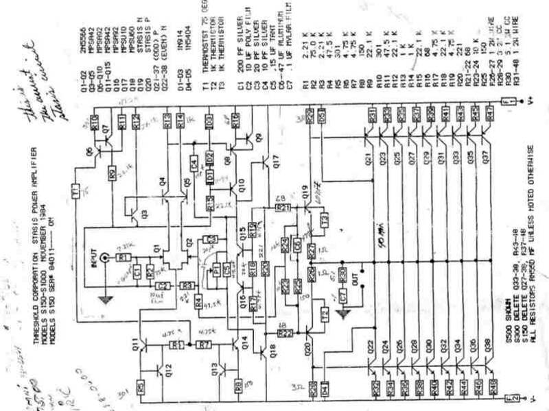

I think Nelson is thinking about his Treshold Stasis amplifiers. These take the feedback from the bases of the driver transistors (emitter followers). So there is not so much difference between the Stasis feedback and the Splif feedback. Splif uses an emitterfollower to drive the feedback, but since the load of that emitterfollower is only little and only resistive, one could as well take the feedback from the bases.
If I remember correctly, Nelson said in one of his posts that this feedback take-off point was chosen for subjective reasons and to call the amplifier overall feedback free, since the feedback is not coming from the output now.

In the Statis sch you attached, a slight modification around Q15-Q16 will make it Hawksford EC (Who has draw it first, NP or Hawksford?)
lumanauw said:
Hi, Steven,
Hi Lumanauw,
The schematic of the Treshold shows a date 1984, the Hawksford error correction was presented during the London AES Convention in 1980.
But this doesn't tell a thing. The circuits are completely different and serve a different purpose. The Treshold biasing circuit is a biasing circuit and not an error correction amplifier, although both use 2 transistors. 😀
The Treshold biasing circuit is almost a normal bias arrangement with two transistors acting as Vbe multiplier (Q15/16). The only different thing is that the resistors R17 and R19 are not connected to the bases of Q17 and Q18 as normal, but are connected to the emitters of these emitter followers. Operation is the same.
Steven

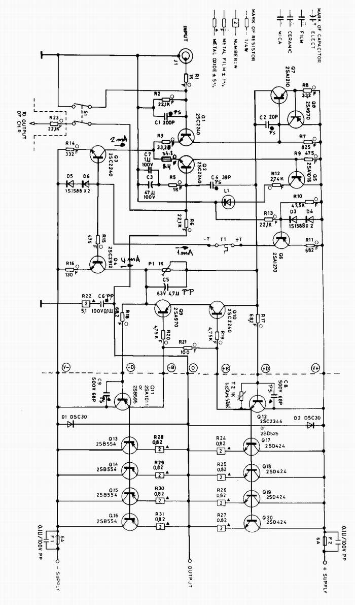

lumanauw said:
Hi, Steven,
There are 2 things that I dont understand about this sch. If P1 is for setting bias, why it is outside VBE multiplier? Just depending on voltage drop?
The second, why Q9 is feeding Q8's base? Whats the purpose of this configuration?
Threshold amps are unique. How about this one, does the VBE multiplier does Error Correction too?http://www.passlabs.com/np/400a-4000.tif
You have a good point with P1. Actually, I don't know. I would have expected that R18 was the variable resistor.
I don't think that Q9 is normally driving the base of Q8. I cannot read the resistor values so I'm not sure about DC levels, but I expect that Q9 is only a current limiter for Q8. If the voltage drop over R16 is more than 0.6V Q9 starts to take away base current of Q8.
In the Treshold 400A and 4000 the Vbe multiplier does not do error correction either. As far as I see at this moment the special arrangement with the four transistors around the bias potentiometer is for variable biasing (sliding bias).
The Threshold patent application was dated '75 and granted
in '76. It was also patented in the UK.
The circuits are not completely different, and the Threshold
circuit does indeed accomplish error correction, although that
is not it's primary purpose, just as Hawksford's circuit
accomplishes bias, even though that might not have been the
thrust of his intent. The topologies are virtually the same.
