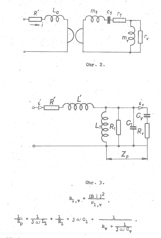

ingrast said:
Just to make sure, would you mind explaining where the speaker EMF comes from?
Rodolfo
Nothing more than the common audio myth. It is nothing else than an exchange of energy between acoustic impedance transformed to electric side as LC resonance, see attached image.
Rodolfo
Hi Rodolfo,
as I see it, two things happen. Lets just take a simple speaker. The voice coil pole-piece assembly acts as an inductor. If the amplifier applies a voltage at the voice-coil, a back EMF voltage is generated immediately which delays the current flow through the coil which builds up the magnetic field. When the voltage is removed from the coil, a reverse voltage is generated in the coil, falling rapidly until the magnetic field is gone.
The second thing that happens takes into account the speakers mechanical properties. Exciting the speaker cone through application of a voltage at the voice coil, is the same as elongating a spring (here in form of the spider and cone surround). If you remove the voltage, the spring force will move back the cone resulting in a damped oscillation of the cone/voice-coil. This back movement is motivated only through spring pressure, but also generates a voltage, just like a dynamo.
A conventional amplifier reacts on this dynamic speaker behaviour in that it tries to hold the speaker output voltage always in gain proportion to the amp's input signal.
The SPLIF amplifier just ignores the speaker.
The philosophy in principle is that of a piano player. You just hit the key, the piano makes the tone...
Charles 🙂

Good, now by which means is electrical energy transferred to the air as moving sound pressure waves. I mean, how do you physically express and quantify this phenomena.
Rodolfo
