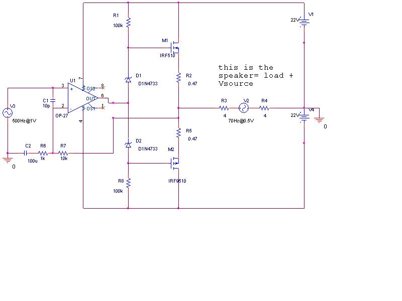

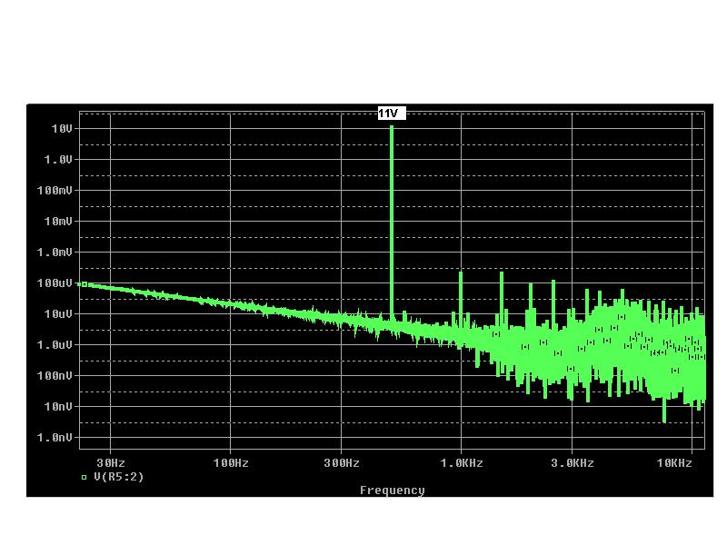

hallo guys
i think you should stop arguing and realize why charles' amps are not exactly
the same as conventional amp +1 extra (redundant) O/P stage
the point is (charles isn't very precise i feel)
some of you treat a speaker as a (passive) load itself...
but in fact speaker is not only the passive electrical device
because of some mechanical issues (machanical resonances, playing as a microphone-
it actually is a dynamic microphone, etc.) the speaker is rather a (reactive)
passive load combined with (serial to??) a hard to determine voltage source
in conventional configuration all these voltage signals are connected to the
- input of a diffamp (charles says:the speaker speaks back) and are totaly
damped. total control of the speaker. high 'fidelity' indeed.
in splif configuration there is no damping (except the damping factor of the amp, which is a
very low output impedance device) of these signals. the wind blows- the speaker's membraine
is going to move a bit...
the fidelity is lower
'the amp is not trying to take full control of the speaker'- charles would say
thus => the speaker is making some things more (or less or different) than
driving electrical signal forces thus => the speaker distorts
it is exactly the definition of distortion: not exactly the same
signal
so if splif does sound better to enybody's ear, the point is:
what (magic) types of distortion (linear, non-linear: symetric or not, resonances, microphone-like
behaviours, reflected waves co-incidence, etc...)
does a 'non-fedback' speaker make which makes the sound better????
... much...much...confusion...
what does it mean that music is free or released???
maybe some acoustic measurements would show the vital mystical difference
between all these non-global-feedback and global-feedback amps

janneman said:
If the speaker was identical with the resistive load, it would correct for the amplifier non-linearities, and the loads being the same, the non-feedback output stage would act exactly as the feedback-output stage. But, that means we can connect the two output stages (as they have identical signals) and this shows that in effect we just have global feedback on both outputs!
not exactly jan
did you read my last post??
speaker is a dynamic microphone so every mechanical motion (own mechanical resonances included) are transduced to voltage
so it isnt just a 'load'
about altmann splif
here i have prepared a small simulation
first goes a as-simle-as-you-could-imagine power amp with conventional feedback.
a speaker behaves here as a Vsource too
every coil is a source in fact
