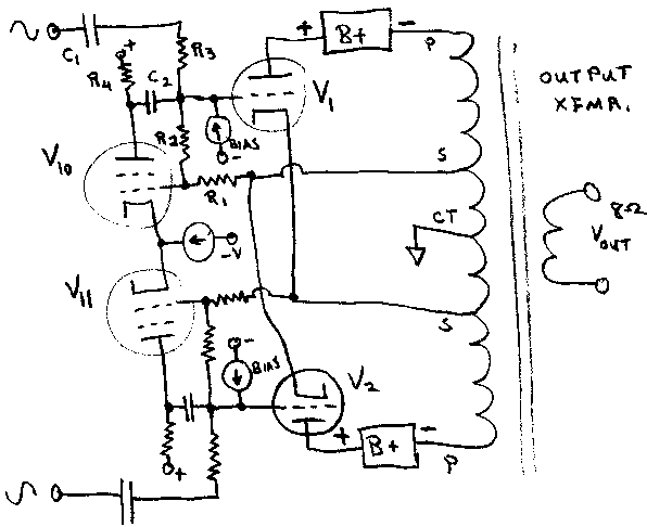

I think I am going to build a P-P tube design now using the Hawksford corr. stage. Never seen anyone do that before. Could even be applied to Single Ended designs too, I think.

Hawksford Tube design
1st a note on my last post:
My idea of using a 3 terminal unity gain buffer in the output of a current mirror is probably not working, the buffer is too linear to act as a mirror transistor. Better to just use the 3 terminal unity gain buffer idea for just replacing transistors in a normal (well... low feedback) design where high linearity transistors are required.
Here is my 1st shot at a Hawksford style error correcting Push-Pull tube output stage: (its fitted to a partial cathode feedback circlotron output stage, or "elliptron stage")
Arrgh! attachment didn't fit, trying again.
