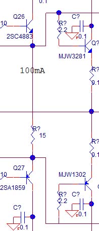

I can't find any other article other than this http://users.ece.gatech.edu/mleach/lowtim/. I read the Leach The Leach Amp - Output Stage, I did not see any mention on that.
This is the problem with darlingtons. Beta droop in the output device has some effect on distortion, but beta droop in the *drivers* is much much worse. And beta at very low currents is nonlinear as well. The typical fix for that in an EF2 (EF3) is to bias the driver transistor up so the very low current region is avoided. This requires a low Rbe value, much lower than what they typically stick in a monolithic darlington. And the proper place to connect it is from output tranny base to output rail, inclusive of the output device emitter resistor. With monolithic darlingtons you don't get that option at all.
Can you explain a more on Rbe value?
I am thinking about bias the pre-driver at 50mA to even 100mA so the current variation is small to keep beta constant.
That one serves the same purpose as Rbe - the 15 ohms from base to base. Some EF2/3's do it this way. The low value keeps the driver current from falling below some value. I usually use 22 ohms base to base or 10 ohms base to output, which puts it over 50mA. This even makes TIP transistors or MJ15xxx's well behaved. They usually stick a higher value inside a darlingon and the driver current can fall to much lower values. Useful for overall efficiency, but makes the beta curve even more of a haystack. And since that connection is unavailable there is nothing you can do about it.
Ah, you mean the internal resistance from the emitter of the first transistor(the first EF) to the second transistor (second EF being driven by the first). I saw the typical resistor value is only 80 to 100 ohm This only pull 7mA from the first transistor.

At this point, I am going to just do conventional 3EF. I already drew the rough schematic and posted here for comments. http://www.diyaudio.com/forums/solid-state/268265-please-comment-my-ops-design.html. There are mistakes. But my plan is when I have time, I'll change Q26 and Q27 to darlington by Sanka that is 50MHz, then just jumper base to emitter of Q20 and Q21 and adjust the bias to try it out. That is if I get to it.
I think using it as pre-driver will work IF I draw heavier current. I am planning to run 50mA to 100mA even for the pre-driver to ensure the speed of charge and discharge the input capacitance of all the power BJTs. High current also keep the variation of current low to keep beta constant.
