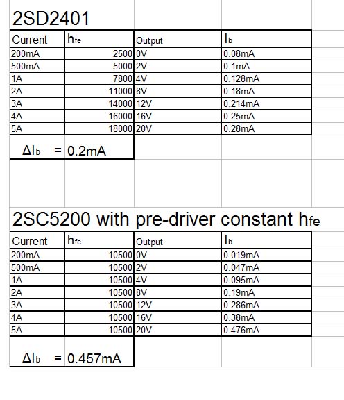

I gave this a lot of thoughts and I compute a table and look at the base current Ib vs collector current IC and look at the amount of change of Ib from collector current at quiescent to 5A.
I assume quiescent current is 200mA and speaker load is 4ohm for this calculation. Attached is the table of base current Ib vs collector current IC comparison between darlington 2SD2401 verses 2SC5200 driven by a pre-driver with constant hfe. The combined hfe is assumed 10500 and remain constant throughout the current range.
I also showed the delta Ib. As you can see, the change of base current in 2SC5200 combination is double than the darlington 2SD2401.
From my understanding, it's NOT the constant hfe you want, it's the constant Ib that you want!!! The less change of Ib, the less change of drive requirement needed from the VAS, the less distortion. In this case, the darlington kicks the butt of the two individual transistor in 2EF. The best case would be the hfe change linearly with IC so Ib remains constant!!!! Maybe Nelson Pass made use of this to design with darlington.
Please comment on this.

I don't get it. I thought one of the most important topics all those great solid state linear design minds put their focus on has been the non-linear Ib of BJT and taming it, as that is the very place where majority of non-linear distortion originates. Was I wrong?
Well, think in the point of view from the VAS, which is a current drive device. You think the VAS rather see a load current that vary less or more at different output voltage?

One problem I do see is if you have 4 transistor in parallel, the 2Vbe are not match. Where as for discrete 2EF, you only need one driver to drive 4 big transistor in parallel. So the mismatch is only 1Vbe. That can be very important. That will kill the advantage of the darlington output transistor.
But how about using darlington driver transistor? Current variation of the driver stage is a lot less. Vbe matching is no different from 3EF.
So using simple BJT for power transistor, use darlington for driver transistor.
