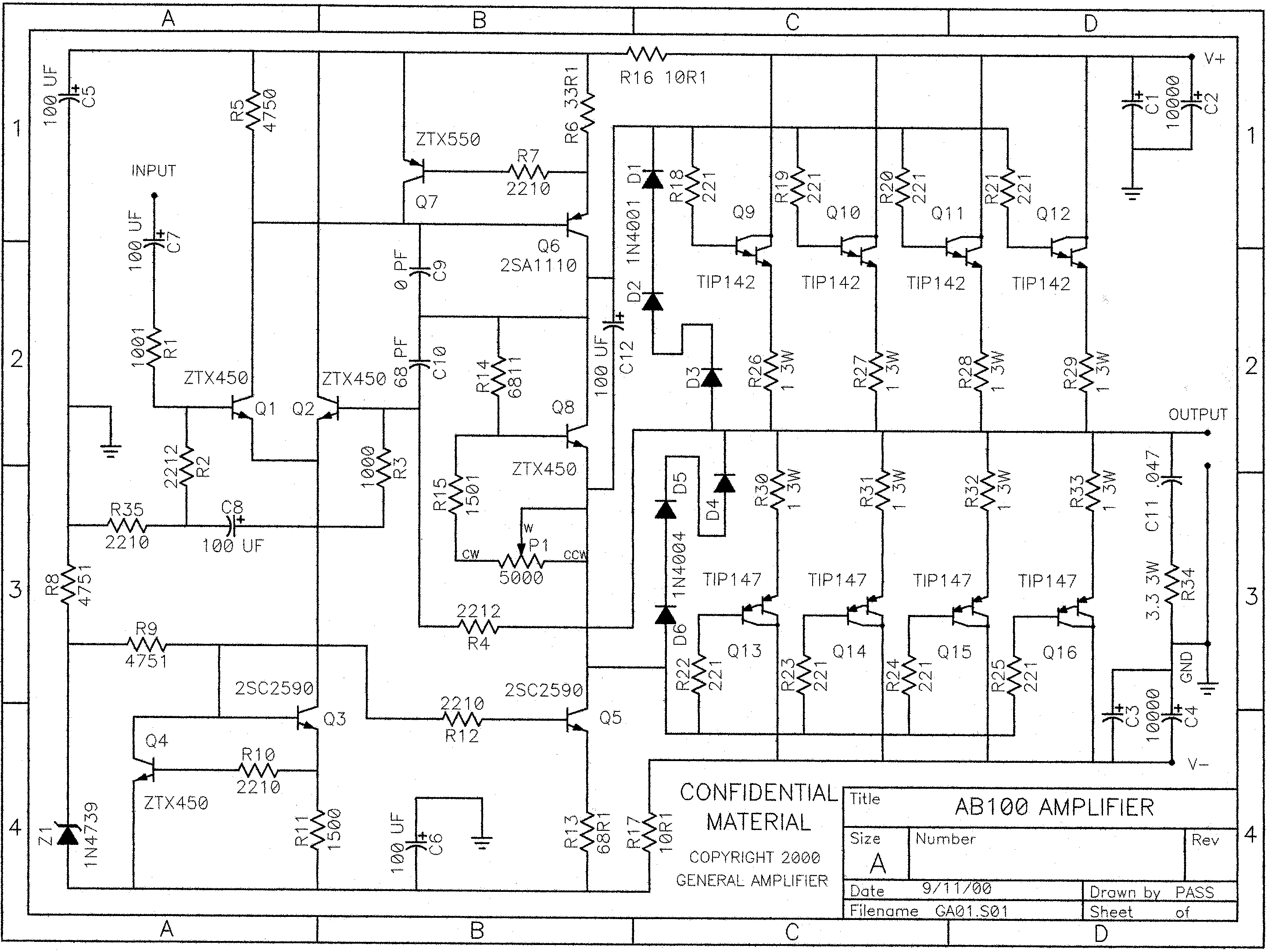

Here is a copy of the AB100 schematic.
This design was manufactured by two companies, and was reliable (or at
least the circuit was). The goal was to provide a relatively simple, easily
manufactured, bullet-proof design. It got some good reviews.
There was no matching of devices. Thermal tracking was provided by
Q8 being in thermal contact with the heat sink.
You can see that thermal issues are largely solved by the use of 1 ohm
emitter resistors. The 1 ohm figure is greater than that considered optimal
(see Self on the subject) but then it was biased higher than his optimal
current figure anyway.
Paralleling alleviates the issue of driver current being lower than we like since
there are as many of them as output devices.

I am glad big gun like you join in. Yes, if you use 1ohm emitter resistor, that solve all the problem. But how about the gm doubling that people talk about? That will cause crossover distortion. Can you elaborate a little?

And how would you match the tempco of a discrete darlington, double or tripple? This is really not an issue. A Vbe multiplier also happens to multiply the Vbe tempco. So, 4 Vbe per pair just as if it was a discrete design.
Having multiple output pairs (discrete!) together with multiple driver pairs, while not common, is by no means unheard of.
The trick is, increase the emitter resistors. There will be some additional imbalance due to the emitter resistors of the drivers terminating into the emitters of the output devices rather than the output line, but the device itself also has higher transconductance, which the increased emitter resistor tames quite well - now it works on both Vbes not only that of the output.

Yes, and it also uses the emitter resistor value together with the 3 diode clamp on the input to limit current - which may well be another reason why it's a higher value. A long time ago I used MJ11015/16 darlingtons in a multiple pair situation and 0R47 took care of the current sharing issue just fine.
Big difference. You use ONE driver transistor to drive 4 power BJT. You don't have to match the driver as there's only one. In darlington, it is as if you have 4 separate drivers.And how would you match the tempco of a discrete darlington, double or tripple? This is really not an issue. A Vbe multiplier also happens to multiply the Vbe tempco. So, 4 Vbe per pair just as if it was a discrete design.
Read Oliver's about minimize crossover distortion when re' of the power BJT equal to RE. You want to use value of RE to drop only 26mV at idle current to prevent gm doubling. Of cause, if you ignore the crossover distortion and set the RE=1ohm or higher, you have much less of a matching problem.
