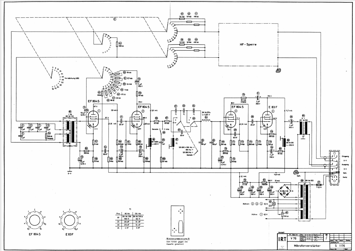

I looked up the old IRT V 76 module, and they say 1:30 on the input and 9:1 on the output - these could be impedance ratios though, which would amount to 1:5.5 input and 3:1 output turns-wise.
Mind you, you could also "cheat" and add a solid-state "pre-preamp" stage right after the input transformer (or even instead of it - do you have phantom power?). Something JFET cascoded with a small high-voltage MOSFET? It doesn't even have to be a super low noise JFET, just something small that's decent at maybe 500 µA to 1 mA. Consulting Horowitz/Hill and Mouser, I'm finding precious little overlap, maybe SMP5484 would be something (not sure about their 1/f noise properties though, and they should how 2N5486 may vary widely). There would also be the 2SK208-Y and 2SK879-GR, SMD versions of the trusty 2SK30 JFET found in various audio gear. Now if those aren't suitable I don't know what is.
If that JFET business seems like too much fuss, you could get a KSC3503DS or similar BJT - Vceo = 300 V, Cob = 2.6 pF and fT=150 MHz sounds suitable to me. (Beta seems stable down to at least 100 µA, but GBW suggests that you better run 1 mA, which should yield a little over 30 MHz.) Then you'd have to come up with a base bias supply though. On the plus side, you could probably use 470 ohms of emitter degeneration and a 200-300 ohm base stopper with minimal impact on noise. Even then, gain may still be so high that splitting the load resistor (and maybe bridging part of it with a capacitor) or implementing some voltage feedback could become necessary. I'll have to simulate this.

Seems too low for the input of a mic preamp to be honest. That gets you from a nominal 200 ohms to 1.25 kOhms. That's enough even for a modestly low-noise transistor amplifier but not enough for a tube input by far. Somewhere around 1:6 would seem to be more appropriate, maybe up to 1:10. (Something like a DI transformer, 200 ohms to 10 kOhms.) I didn't say it would be easy.The transformer is a 1:2.5 ratio.
EDIT: Using the input tube as a cascode for a JFET or BJT still remains an option as well.

High-performance hollow state was never easy or cheap (or lightweight). Note the multitude of plate chokes, the 1950s current sources.
Actually, no, I do think these are the turns ratios after all. Output impedance is specified at around 40 ohms but that's clearly a plate output (so a few kOhms typ - but then again, there is negative feedback going to the previous stage), and the input transformer has a shield winding (plus what I assume is a mu-metal shield, not unexpectedly). Plus if you think about it, 1:30 would get input voltage noise right in the vicinity for a good mic amp (1-2 nV/√(Hz)).I looked up the old IRT V 76 module, and they say 1:30 on the input and 9:1 on the output - these could be impedance ratios though, which would amount to 1:5.5 input and 3:1 output turns-wise.
