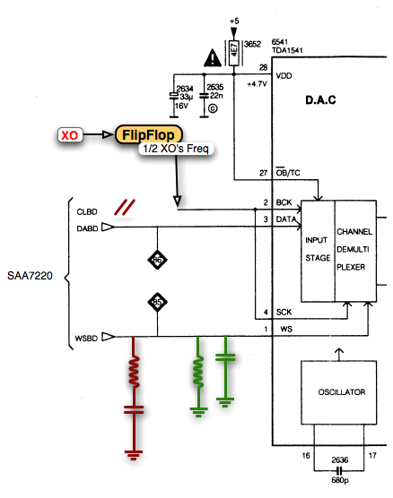

As far as the TDA1541A datasheet...
Figs 3 and 4 (p. 8, 9) show, FWIW, THD distortion for both 4x and 8x. -60dB distortion looks better for 8x; 0dB looks better for 4x.
hollowman said:One of the main objectives of a DIY forum, and online communites, is to explain -- using clear language -- concepts to all un- or under-informed, which includes newbies. This is not spoon feeding.
It is one thing to explain in order to allow others to understand and create and it is quite another to expect others to do the understanding and creating for you.
This neatly illustrates the problem. You have chosen to ignore vast chunks of the datasheet for reasons that totally elude me. Do you not think that if it is put to you that you are violating the specs, it might be a good idea to study said specs?
I disputed you rfbrw because I don't see any evidence in the datasheet, and my TDA1541A is working fine with 8x oversampling.
Looking at the datasheet. Clues that suggest to me the chip does 8x oversampling...
"FEATURES: 4x or 8x oversampling possible" - okay, it says possible, I guess that's all dependent on the sampling frequency involved.
"QUICK REFERENCE DATA: tcs current settling time to +/- 0.5uS" - that's okay because 1/352kHz is about 2.5uS.
"BR: Input bit rate at data input (pins 3 and 4), MAX 6.4Mbps, fBCK Clock frequency at clock input 6.4MHz" - That's also okay, I'm clocking in data at 5.6Mhz.
You realise I'm clocking data into DATAL and DATAR?
I don't think there's much else in the datasheet that might be an obstacle for my application.
I appreciate you believe otherwise, and I haven't disregarded it. I just don't see the evidence myself.

The PMD100 uses 32 bits per frame per channel. Each data bitcell requires 1 BCKO cycle hence 8x32x44100=11M2896. That is a BCKO cycle time of 88nS. The TDA1541A specifies Tcy min as 156nS.
True, it is in this case a burst clock but the data rate remains the same when active.

Technically, the TDA1541A is perfectly capable of 8x oversampling. Even at 44.1Hz.
But, the burst mode of the PMD100 (in order to accommodate longer word lengths if requested) does mismatch with the datasheet of the TDA1541A. Fair point, its not working within its specified limits. All bets are off. But I do have two of them working well in these conditions. So I'd argue that, probably due to the fact that the average input rate is unaltered, it can cope with these bursts of data.
I do wonder if the limit on 6.4MHz is actually limited by something further along the chain, rather than the input circuitry, and/or based on constant throughput.

One more little thing - for chips designed to work together - they don't interface very well without a bit of work! Find the long 'TDA1541 thread in this forum of more details, but the key tweak is to use RC decoupling in the signal lines between these two chips to reduce HF noise injection into the dacs substrate (1K/10pF was suggested)*. Your Arcam already has some resistors in place in these lines, so definitely add small caps (10-22pF) to digital ground at the 1541 input pins. It helps a surprising amount.
*this is because the 7220 swings 5v pk-pk on its outputs, and the 1541 only needs a tiny current centred c1.4v to switch - it's a current-routing logic; the excess voltage swing just pushes HF currents into the dac.
Hi there,
how that may be done?
Like in red or in green or something else? Also, with a flipflop to divide the XO frequency, is it the right place to feed the DAC?
Have mercy if these are stupid questions 😉
Matthieu
I would guess neither... the resistors should be in series with the lines. The caps go to ground, to form a low pass RC filter.

I'll need to cut the track then and as it's easy to do and undo I'll give a try.

You are right, it's an RC low pass filter, confirmed in the TDA1541 thread.
Thanks. Not found about the clock feed, maybe it's so obvious nobody dare confirm or even ask...

Question, any evidence that leaving the RC on BCK, 1K/10pf (working nicely) but fed by a flipflop instead of the SAA7220 will do any hamr to the clock signal? As far as I can understand the 5V output is too high also for the TDA?
