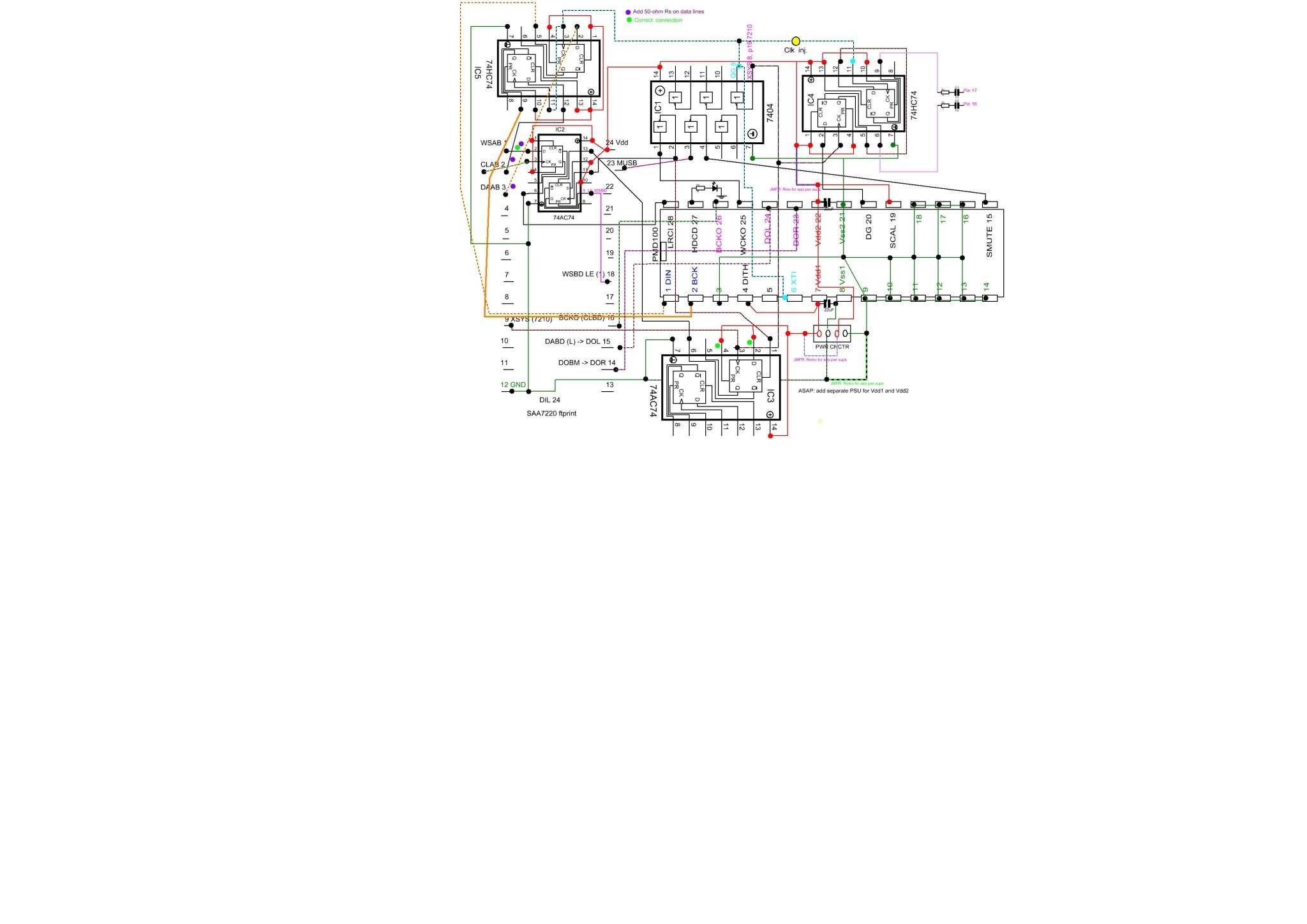

So can a PMD100 be directly substituted for an SAA7200P/B without any other circuit mods?

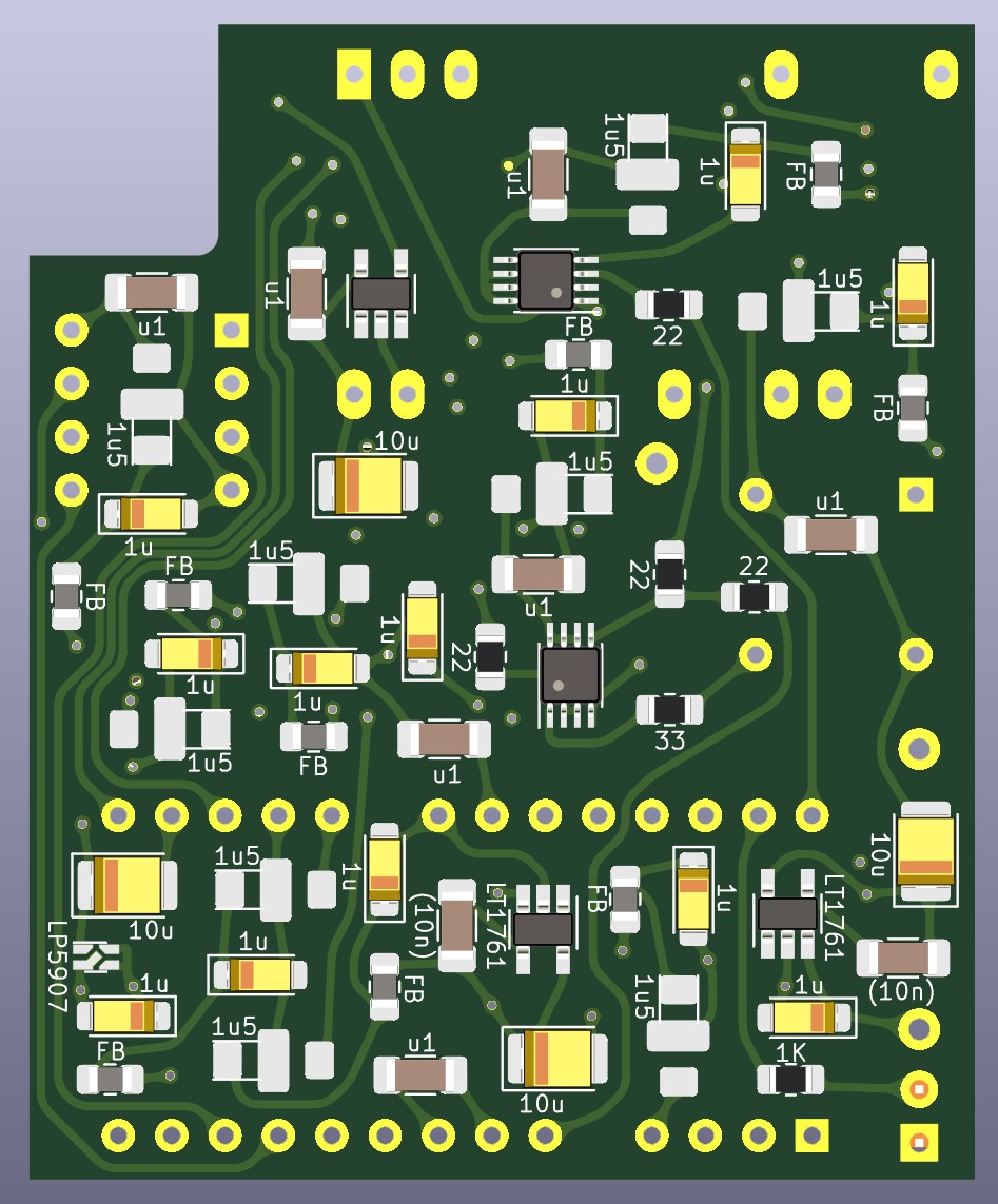

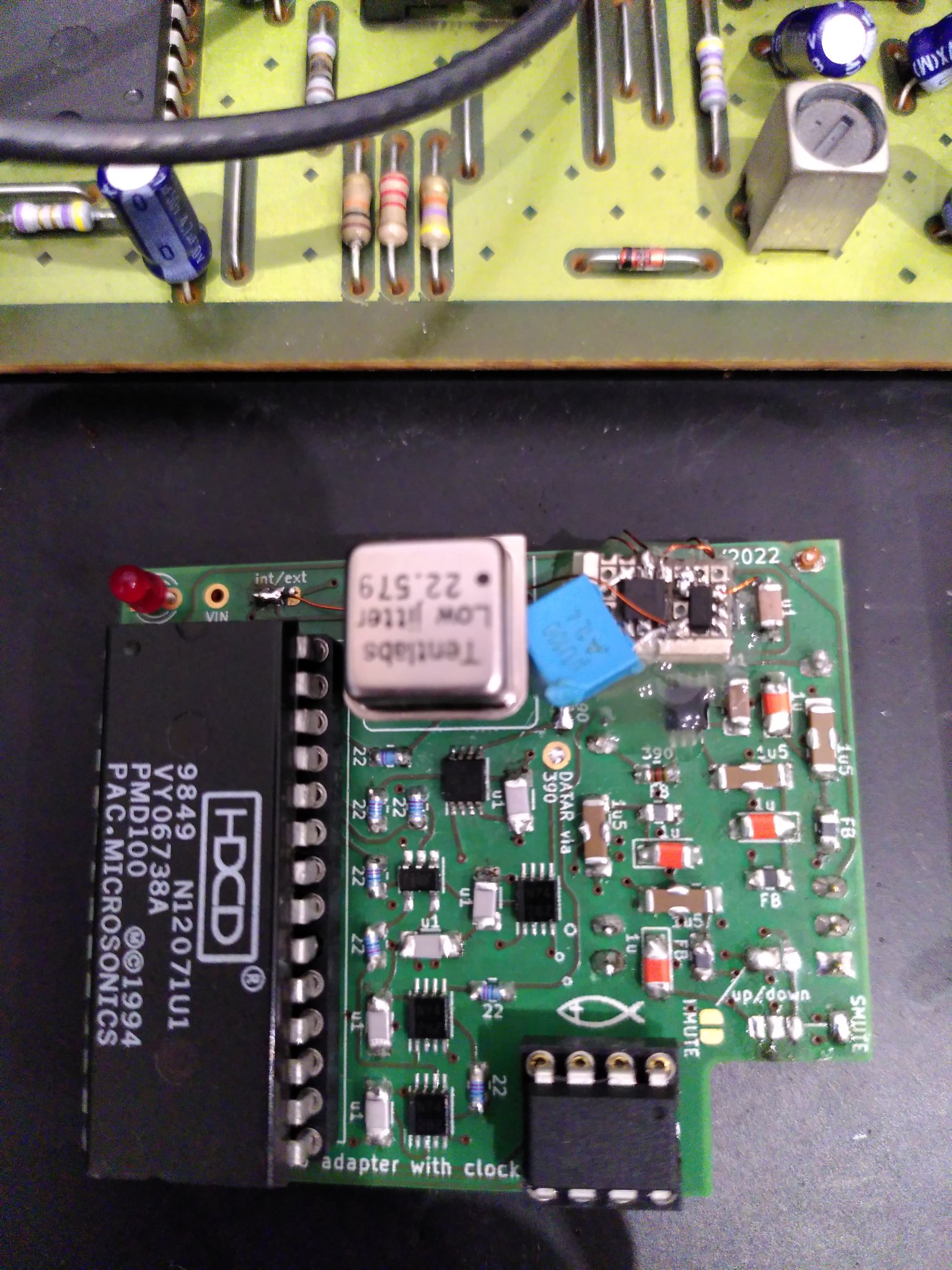

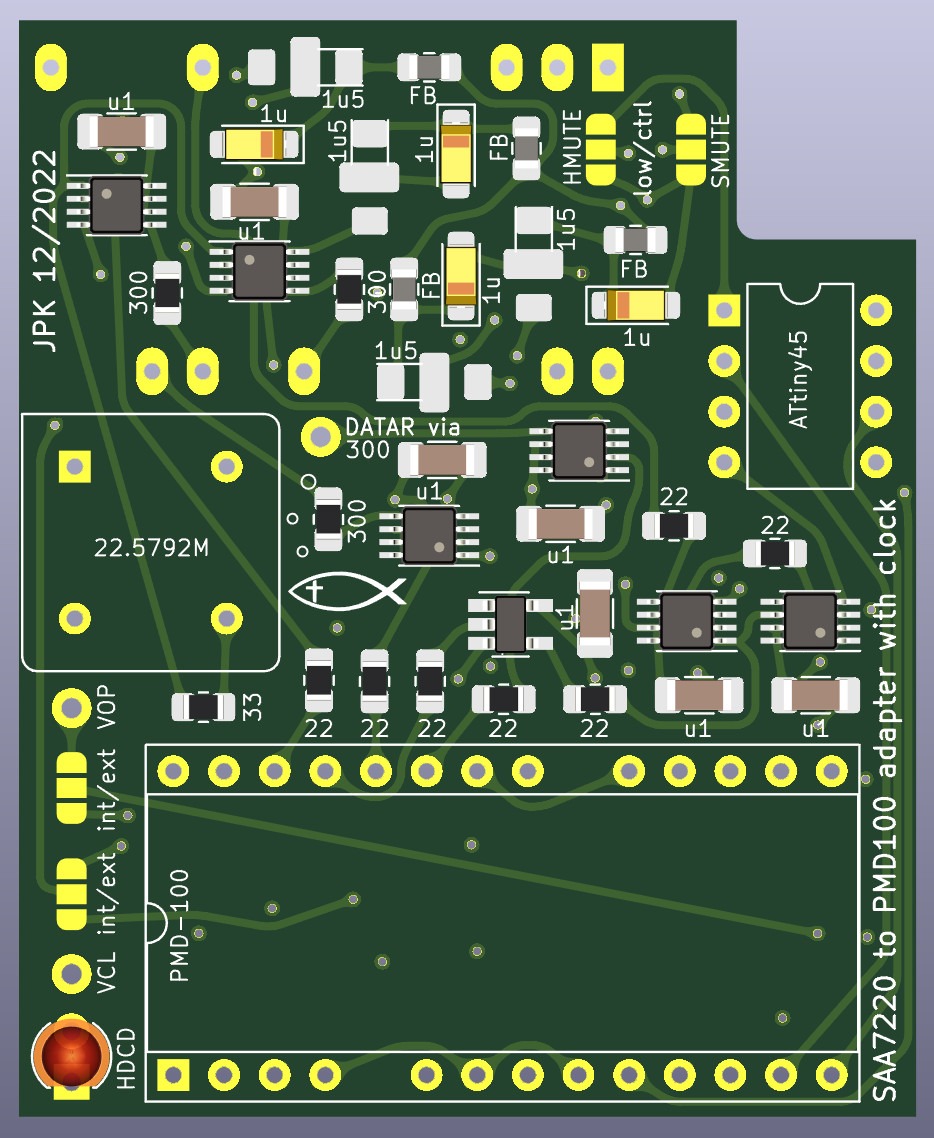

No, but I made an adapter board to replace the SAA7220 with a PMD100 (plus clock and reclocking), see attached pictures: the prototype PCB had a few minor mistakes, I sorted them and got a nice improvement of sound quality. The PMD100 runs in programmed mode and feeds the TDA1541 in simultaneous mode.

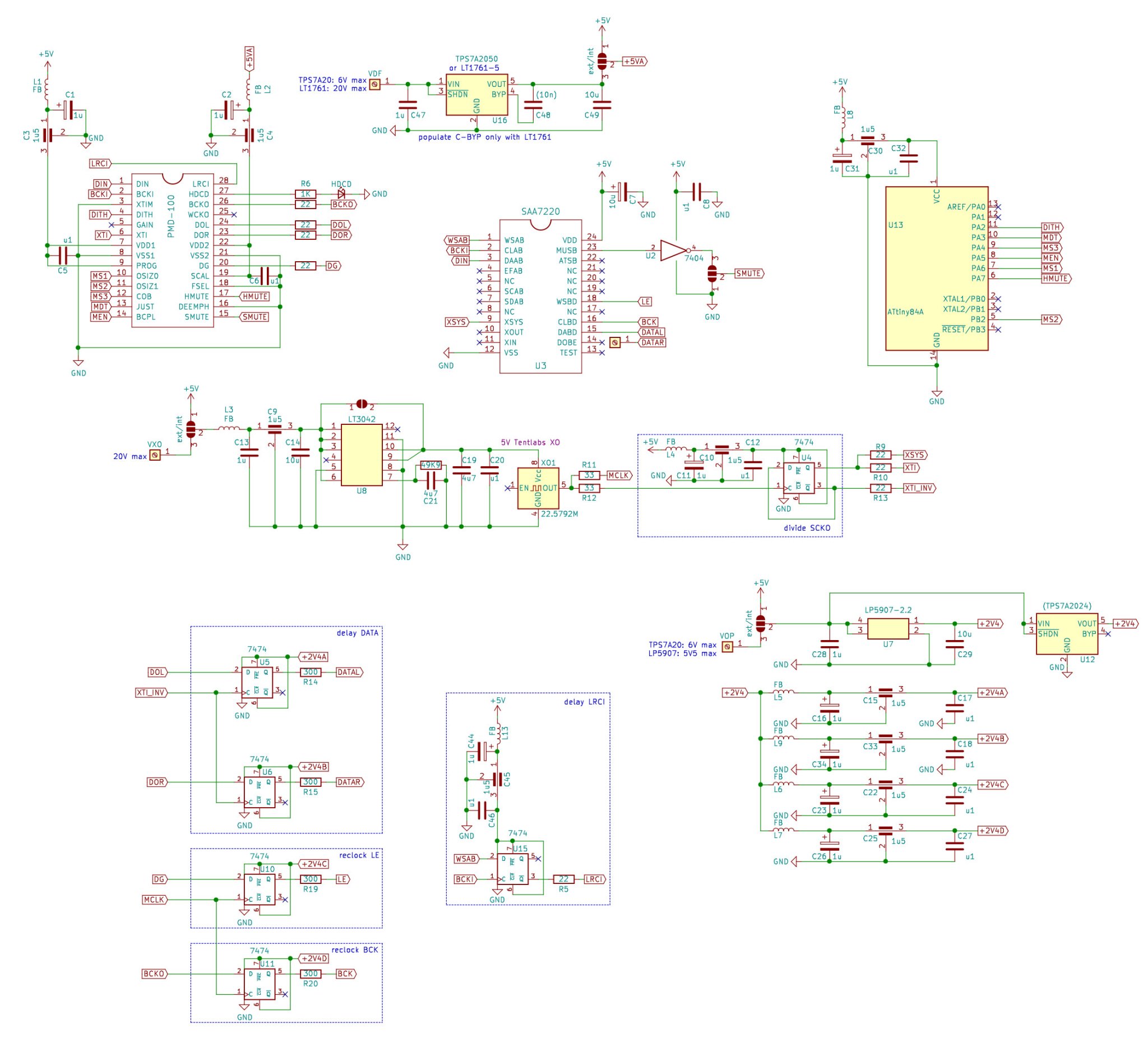

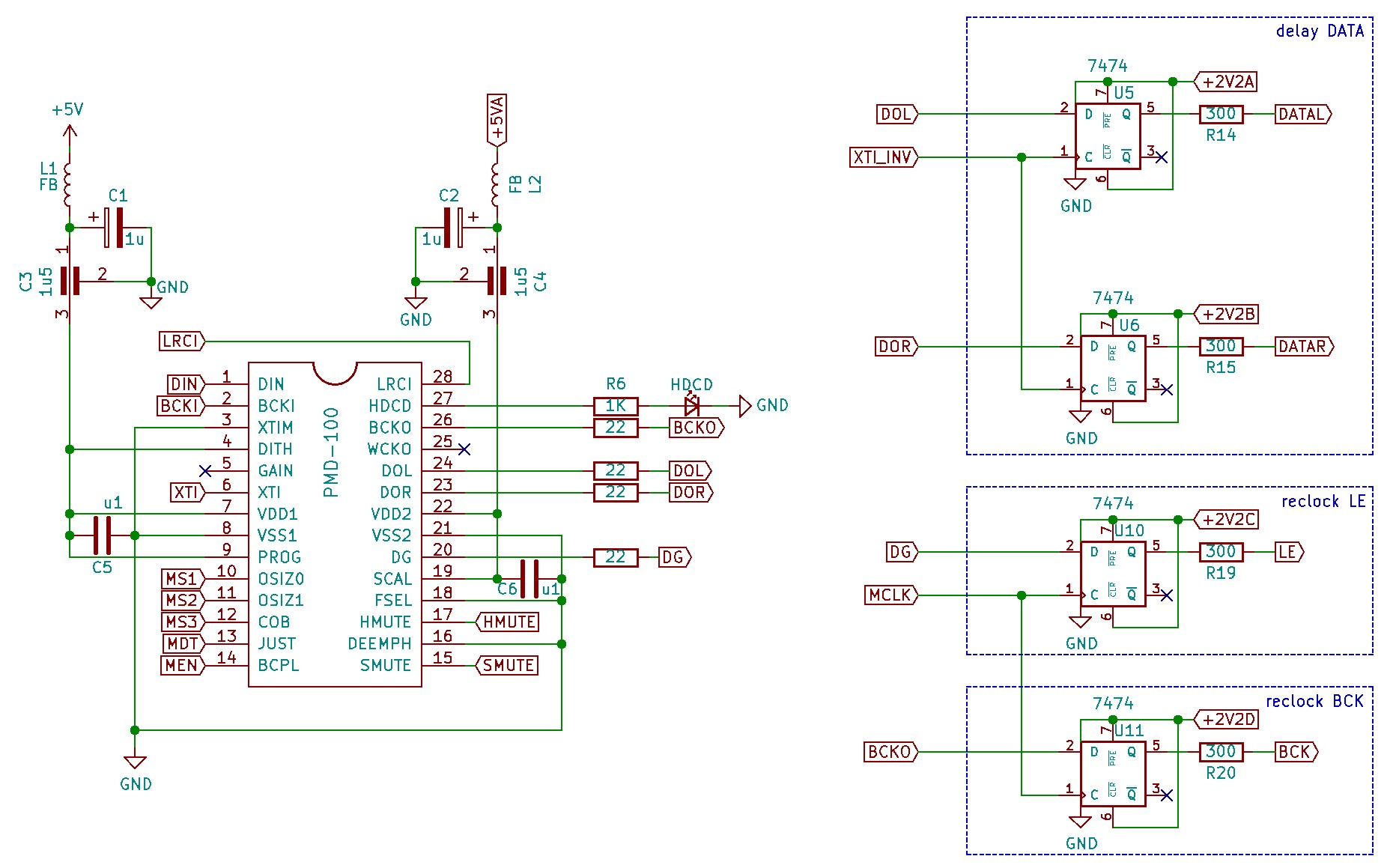

Update: I successfully removed U7, U8, U9 and set deglitch_high = 25 and deglitch_low = 31 in the Arduino sketch and used DG instead of WCKO from the PMD100 to create LE. The rest of the previous schematic remains unchanged.

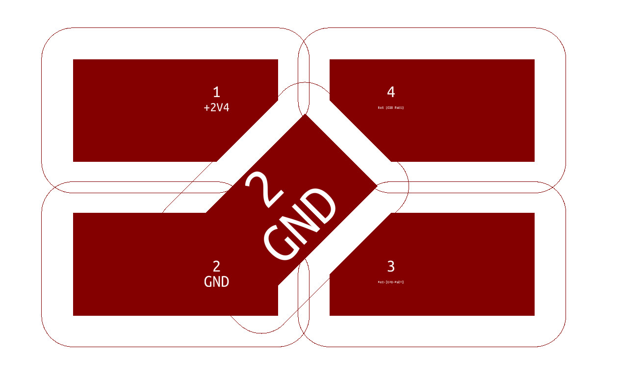

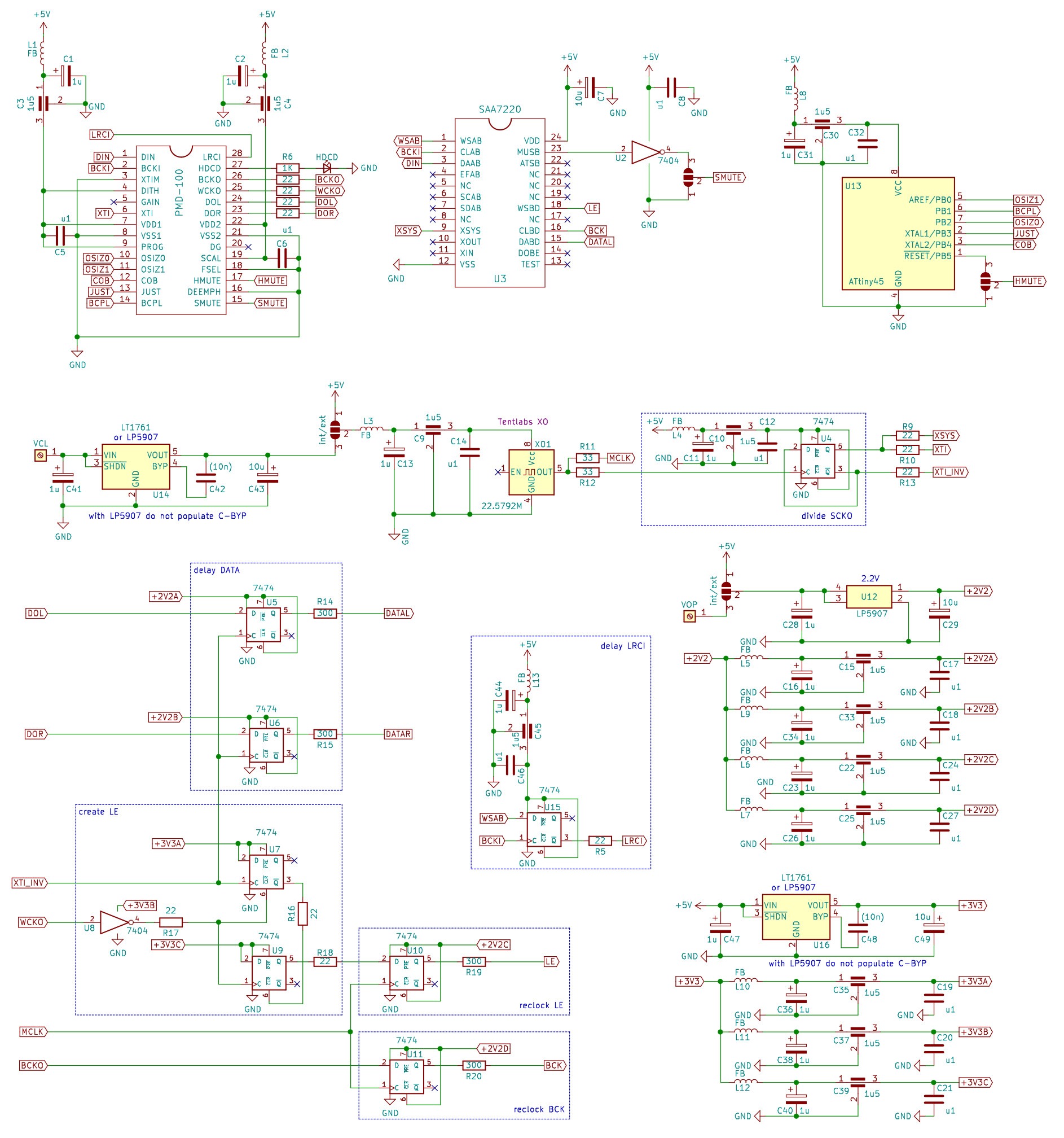

Finally I can answer the question of this thread title: yes, the SA7220P/B is that bad in comparison to the PMD100, and it seems regardless of how well implemented it is. I compared a Philips CDP with a modified analog stage based on OP42 against a Naim CDI, both with CDM4, SAA7220P/B into TDA1541A: the Naim had an S1 version and also an OP42 based analog stage, the Philips the plain TDA1541A. No question: the Naim sounds vastly superior to the Philips: better rhythm, punchier attacks, more tuneful, and so on. But if I put my PMD100 daughter board into the socket of the SAA7220 the Philips sounds better than the Naim: cleaner, more transparent, better bass, better space and soundstage, much nicer top end. The Naim sounded felt-like in comparison and had weaker attacks. So I guess I will transplant the daughter board into the Naim. I attach the final working schematic and the code needed to run on the attiny84. Note: I was able to hand solder the X2SON package of the 2V2 regulator, but added an alternative regulator to the schematic with a larger footprint. To solder the X2SON just make longer pads so that the solder can be accessed with the iron. Also connect the thermal pad to the GND pad as shown in attached picture so that the thermal pad can be soldered together with GND from outside. Of course this can't be done without a loupe...
