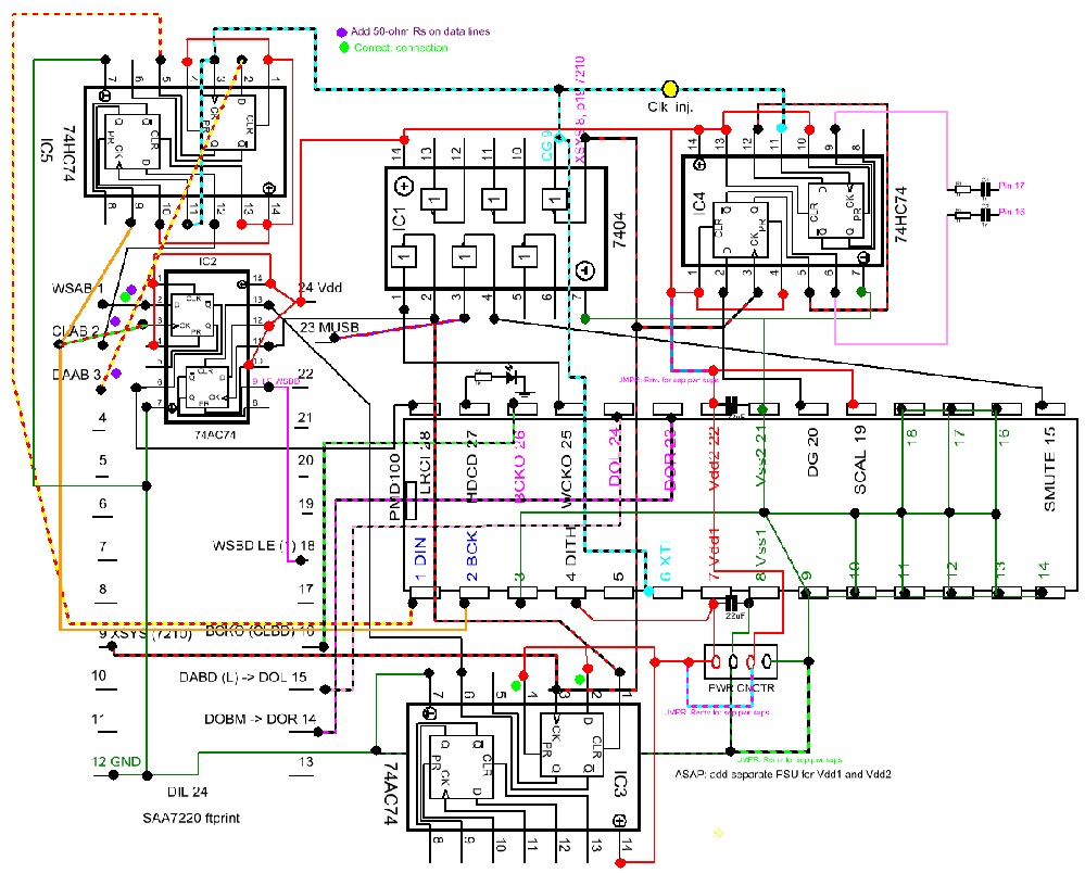

Another update (related to the already sort of off topic discussion towards the end of this thread).
I now have a PMD100 running with my TDA1541A. I have a slight issue where I hear some small digital noise artefacts on very quiet passages (I think I need to pay attention to my grounding layout), but other than that, it sounds stunning!
I did it using Guido's circuit, and it works a treat.
It sounds so much better than SAA7220. So much more detail, vocals much clearer (not only hearing things I hadn't before, but sometimes lyrics too!)
Thanks to Guido for the circuit, and thanks to rfbrw for the advice and chip suggestions.

Also, forgot to add, the PMD100 sounds much better, and I'm paying no attention to reclocking the output (although arguably the conversion circuity might be doing that for WCLK/LE).
Phil: Congratulations on your success! I have a spare PMD100 and a couple of late-1980s Philips CDPs, so I may Xerox your project.philpoole said:Another update (related to the already sort of off topic discussion towards the end of this thread).
Are all the troubleshooting steps you took in this thread, or on diyhifi in a topically-similar thread?
Yup -- reclocking makes a difference. CarlosFM posted a very effective reclocker elsewhere, and that's what I use along with Elso KC v.7.
Also Martin's higher-power version of Flea for TDA1541's +/- 5VDC is very low-noise.
I didn't really follow the troubleshooting in the thread (I did read it though). My circuit is essentially identical to the one posted in that thread - except mine is in standalone mode, using 74 logic, and a set of DIP switches, so I can play a bit with the settings.
I did have trouble. Mainly my own stupid fault!
I had pin 9 floating. D'oh! it didn't know if it was to be programmed or if it was standalone bless it (I'm now quite fond of my PMD100 🙂 ). Once that was solved, there was quite a bit of crackling noise, which I solved, either by adding some extra decoupling (47uF) near the logic chips, and rearranging the grounds (the oversampler and clock boards had their grounds joined and then sent to the star ground point - now they're both seperated out and only meet at the star). Both fixes fixed the issue - not sure which one was the cure unfortunately.
Other than that, it all worked, as per Guido's schematic. And I didn't have to warm up my scope.

Success ... sort of
Phil:
I also note "digital noise artefacts on very quiet passages". Not sure I concur that this (or my) implementation of the PMD100-1541 ckt is better than my 7220-1541A (other than on HDCDs). Then again, I had the 7220-1541A fine tuned to sing, and that was a labor of love. Also, as rfbw suggests, the PMD100-1541 may not be ideal partners, despite the fact that they can be made to work together.
Similar to your experience, perhaps, I can’t seem to make DEM re-clocking work with PMD100, despite Guido’s success. Not sure why yet. Guido did note that he’s using Henk’s design, not his own, in the default PMD100-1541 you and I built. Speaking of DEM, you noted success with DEM earlier. Was this with the 7220 filter or NOS?
Thx for any light you can shed!
Phil:
I’ve implemented the PMD100-1541A ckt, sticking mostly to Guido’s design, but added a reclocker between decoder and PMD100 (the 7210 decoder is supposed to be jittery).philpoole said:No I didn't do DEM re-clocking. I might have a go at it one day. I tried a long time ago with little success, so I think I'm better off looking for gains in other places at the moment.
Hi Hollowman,
Yeah, I noticed you've been busy with PMD100 and TDA1541A recently on the other forum. Glad you've got it working.
All my DEM reclocking (mis?)adventure has been with SAA7220 (and I think maybe NOS as well).
My initial thoughts, and hence that post, were that it was an improvement, when really it was just different (and not for the better). It seemed brighter, and further listening, especially with headphones, revealed this horrendous hash, and that actually, it was of no improvement at all.
It became apparent to me that actually my DEM reclock circuit was useless and was equivalent to not having anything there at all. This was reinforced by the fact that the hash vanished as soon as I replaced this circuit with the standard 470pF cap. Hohum.
I think these digital artefacts you hear are either due to similar issues I had with DEM reclocking, or perhaps poor grounding (I discovered great improvements in reworking my ground return paths a bit). I don't think it's related to the PMD100, or the TDA1541A selection, as rfbrw suggested. I have 10 TDA1541As and I've not noticed any sounding the lesser in this current setup I have (although I haven't needed to try all of them). The TDA1541A is still working within its rated limits (8x oversampling).
I think, since I've improved my layout and grounding a bit, I may well return to attempt DEM reclocking. However, I'm in the middle of implementing a new I/V and Bessel filter for it instead.
