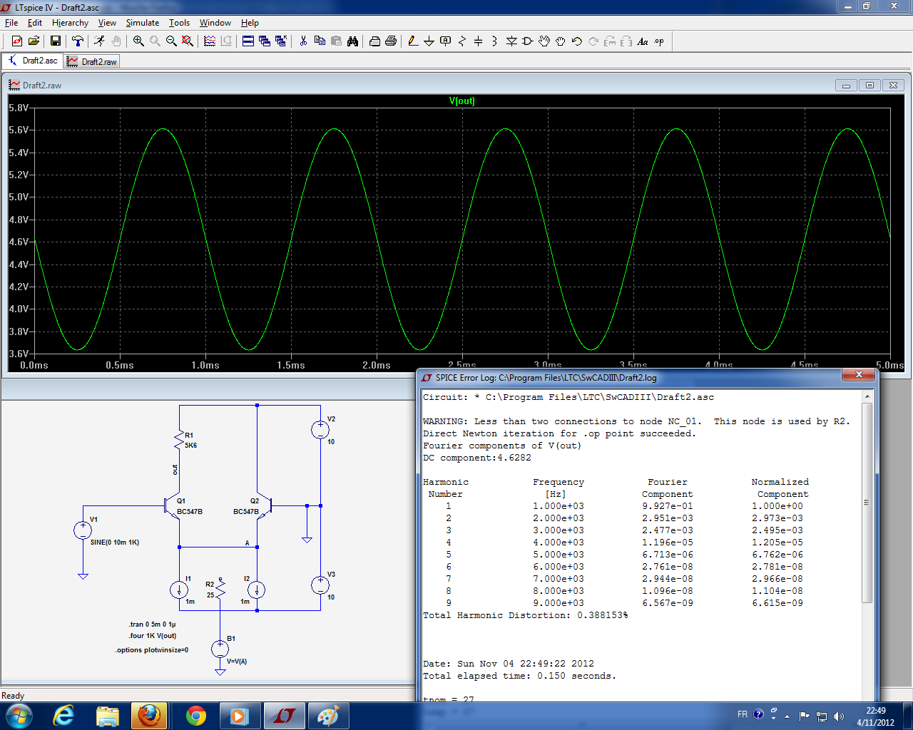

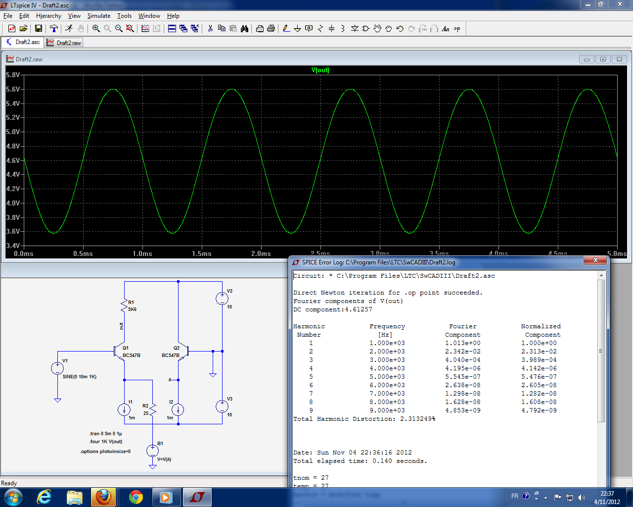

Let look at a differential VFB amp.
The distortion produced by the +V input will be present in the output.
Ok, as I said before, devil is in the detail and we have to state matters in a clear and unambiguous manner.
Here are the two situations, exposed in a "bare-bones manner", ie with only parts of interest explicitly drawn.
First, just the input transistor with a linear FB network having the same resistance as a the dynamic resistance of a similar transistor biased at the same current level.
Q2 and V(A) are only present to simulate an ideal output section of the amplifier. Q2 being biased at a constant, it does not influence the linearity, it is just a convenient level-shifter matched to the amplifier.
V(A) is a spice ideal behavioral voltage source configured as a buffer for the voltage in A (if you don't have faith in spice, you are free to use other methods, they will give the same result).
The THD in this case is 2.3%.
Second pic shows the situation when the second transistor is brought into action.
Now, all the the spice implements are disabled, only the real components operate, with Q2 effective as non-ideal buffer.
The THD is 0.388% (OK, not exactly -20dB, but not that far off, and here I have somewhat exaggerated the current excursion to show something substantial).
I don't ask you to put your faith in spice, but simply to look at the situation explained in a more graphical manner: it seems obvious that Q1 is outside the FB loop, independent of CFB or VFB, and hence, only open loop type compensations methods can have an effect (or a reduced modulation of the Ie current, which is also one of the preferred, but non-exclusive methods).

Note that there is no cheating, the output amplitudes are similar in both cases (even slightly higher for the "compensated" case)

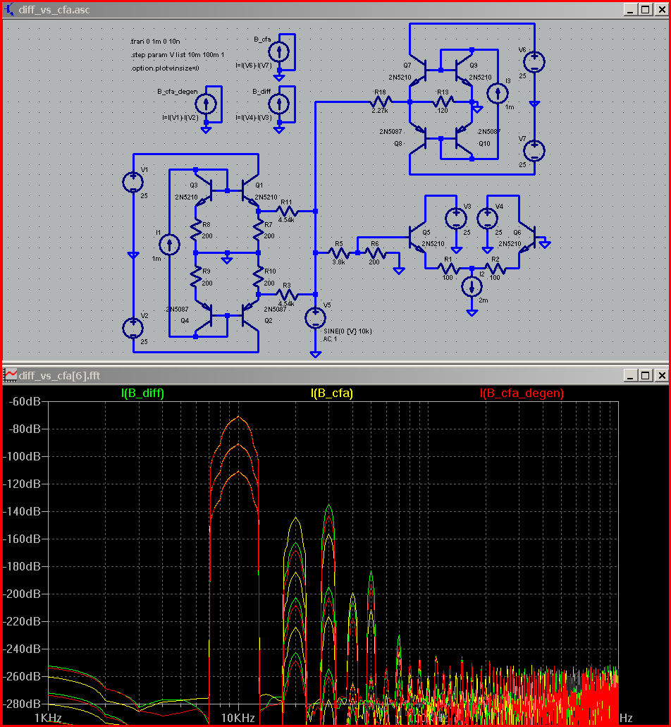

you can claim anything is "proved" by your ears - but the claim that CFA is inherently better than VFA, with 10x less distortion is a technical question that sims are fine to explore
my sim below is complicated by a question of "fairness" - how much degen to use in the CFA input
the usual formulation of a CFA input is no explicit degen, single feedback network - upper right in my sim, yellow trace
the max possible degen with a CFA front end requires 2x feedback dividers as shown in lower left, red trace
and finally the diff pair is shown in the lower right, green trace
all 3 circuits give ~ the same gm from amp Vout within a few %
all of the Q run at the same current
I compare the collector current difference in each circuit
I also stepped the level of V - the highest step of 1 V is an outrageously large Vout error for a high global loop gain amp
the fft is a little hard to read but may yield to a little study - there are 3 stepped polts on top of each other, with 1 V, 100 mV and 10 mV Vout "error" levels
my summary of the results is that for 2nd harmonic VFA (green) is always better than the the standard CFA (yellow), only ~6 dB worse than the max_deg CFA (red)
for odd harmonics the diff pair is worse, substantially worse at higher Verror
the max_degen cfa shares the "bad harmonic structure" of the diff pair with odd harmonics higher than even at similar higher Verror
at low Verror corresponding to high loop gains the max_degen and diff pair front ends have "ideal harmonic structure"
while the plain CFA has "bad harmonic structure"

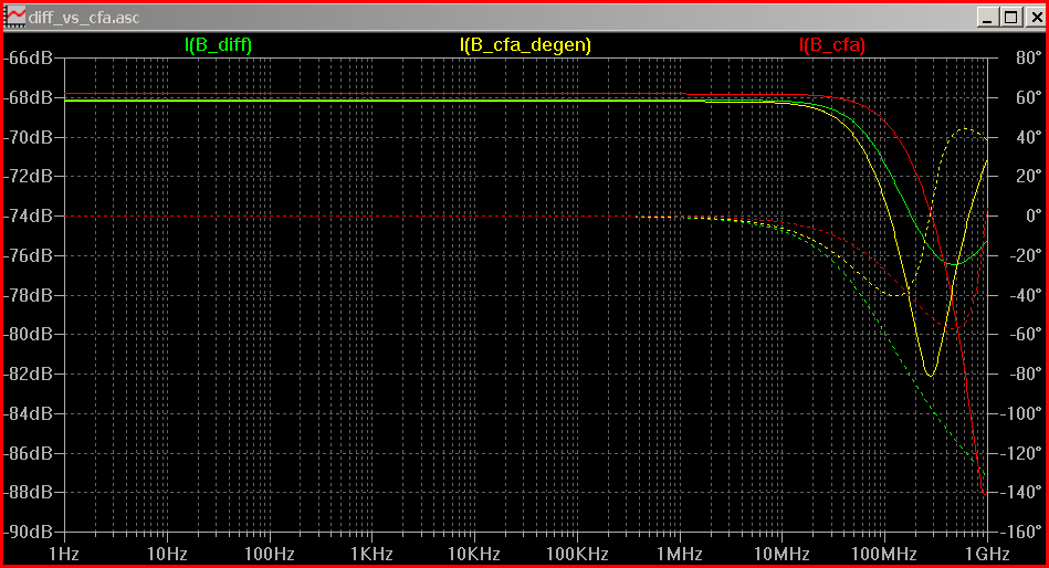

the speed plot shows that the diff pair falls in between the plain and max_degen cfa, with phase error < 5 degrees to beyond 10 MHz
so if you design "flat loop gain amps" with low loop gain, plain CFA may be better than diff pair or degenerated CFA front ends
but Otala's “flat loop gain” prescription is simply wrong if you accept his TIM/PID "FM" IMD as the important parameter - and early believers like Walt Jung and Marshal Leach changed their minds so it isn't just reactionary deniers not accepting new ideas
with high loop gain diff pair VFA works just fine – with max_degen CFA only ~ 2x “better” - not 10x

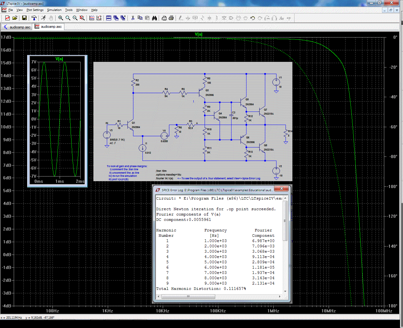

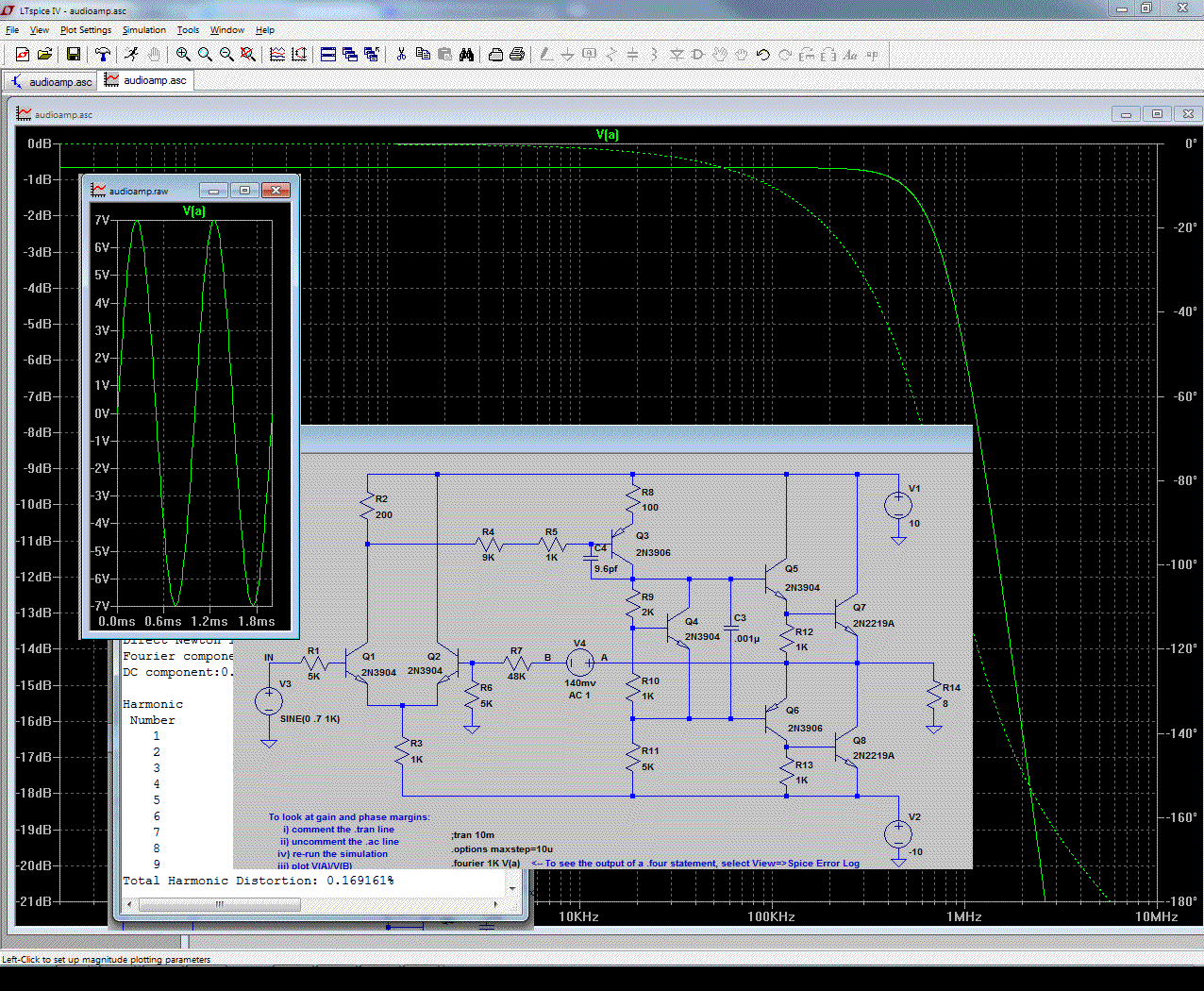

An other fast and furious example.
The amp is issued from LTSpice examples. It is called audioamp. I wanted a neutral example.
It measured this at original. Distortion 0.23% bandwidth 70 000hz at-3db.
I tuned the VFB for best simulation results as possible (first image)
Then modified-it to CFB.and did the same.(second image)
The output level was set precisaly for +-7V peak to peak, and the response curve for no overshoot at HF, as large as possible. Current kept as similar as possible. Nor care for phase margin for both.
As expected, distortion slightly reduced, and bandwidth so dramatically increased in the CFB version (mean IM reduced a lot) that i had to go to the 100Mhz.
of course, it would be unrealistic to expect such a bandwidth in real life, because all the parasitic caps, just to demonstrate by calculations (sim)
0.16 %, vs 0.11 % is hardly conclusive when your ealrier claim was for 10x improvement
